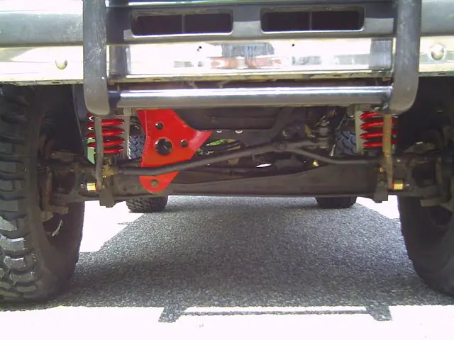

I want to see a picture of your 2wd beams :)
BTW, that was before I fixed the swaybar and mounted it correctly.
thats what I thought, no friggin way will 4x4 radius arms fit those beams, they ears are too tall (distance betwenn upper and lower bolt)
Unless everything I knew up to this point was wrong, those look exactly the same as 2wd ranger beams
Yeah as far as I know the X and Ranger beams are the same, except for the pre 88 Rangers I think.
