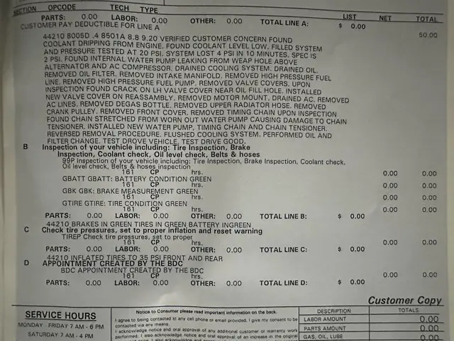

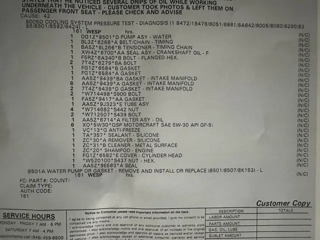

The Dealer finally acquired all the parts and finished the water pump repair my 2016 ExPlat yesterday.
I was told that my Explorers timing gear/chain and associated parts looked like new so only the all new water pump and various new bolts, gaskets, sealants, coolant, oil/filter and other required parts were replaced (see attached image).
Other work performed was the Roof Rack Recall and all four Door Checks were replaced under warranty.
My only cost for the above 3 items was the $100 deductible of my Ford ESP Warranty.
According to the Service Advisor, the Dealer billing price was $3,500+ for these 3 items.
In addition, I paid to have the original front brakes replaced with new rotors/pads because of a freeway speed vibration/shake. I’ll do the rears in a few months, they are at 7mm.
The ExPlat runs powerful, smooth and quiet, like normal again.

My water pump failed recently at only 44K, they found that the timing chain was stretched too so they replaced it as well. Thankfully it was all covered under a Ford ESP. The valve cover had a crack too so it was also replaced. No tune and everything was completely stock. IMO Ford needs to address these serious reliability concerns. I've had the PTU, Electric power steering rack, and water pump all fail before 50K.
The service report you posted states the timing chain stretch was due to the water pump failure and not the chain failing on its own. Your situation doesn't bring the reliability of the timing chains in the 3.5L V6 engines into question. I just searched the 5th gen forums and didn't find a single post relating to timing chain failure for a 3.5L V6 engine. I also a search for water pump failure causing timing chain stretch and came up empty. Did you get visual confirmation that the timing chain was actually stretched? For the water pump shaft to be so out of spec to cause a timing chain to stretch seams highly unlikely without there being a catastrophic pump failure that would take out the engine.
The tech said that the stretch was visible and they measured it as well, there was no catastrophic failure. Just a leaking water pump and a few drops of coolant under the vehicle.
