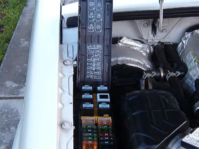

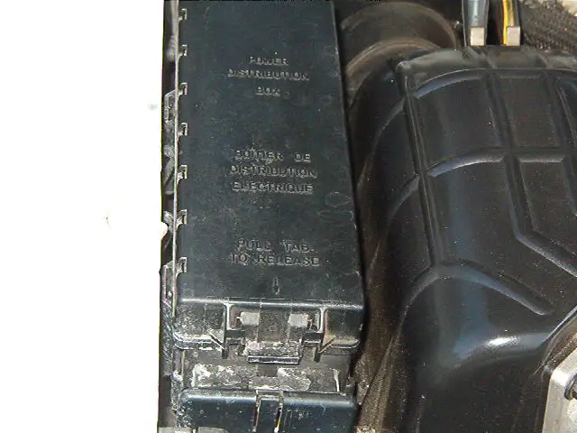

On both of my first-gen Exploders, it's not difficult to get to and replace. It's not under the dashboard where the turn signal flasher and hazard warning flasher are. It's under the hood (passenger side) inside the power distribution box that's between the air filter housing and the right front fender. Here's a pic of it with the cover closed (sorry for the dirt).

Here's a pic with the cover open. The legend is on the inside of the cover and in this pic, the fuel pump relay is the white one (Advance Auto Replacement).
Just pull the relay out of its socket and plug the new one in.
Hope this helps.

The pictures that "gimp" has are of '93 and '94 model years. On the '91 and '92 explorers the relays are indeed underneath the power distribution box. To get a them you need to use a screwdriver and push on the metal tabs (i think it has 2) on the plastic distribution box so you can slide the box up exposing the relays.
Yeah, 93-94 explorers have the relays in ther top box, but 91-92s have the relays in a seperate box underneath the top fuse box.
You might have to take the EEC test connector off the side of the Power distribution box to get the top part to lift up...
YES the earlier power dist box is a PITA, in fact it is a great upgrade to go to the junk yard and get the later style box and swap them out (takes some wiring work).
