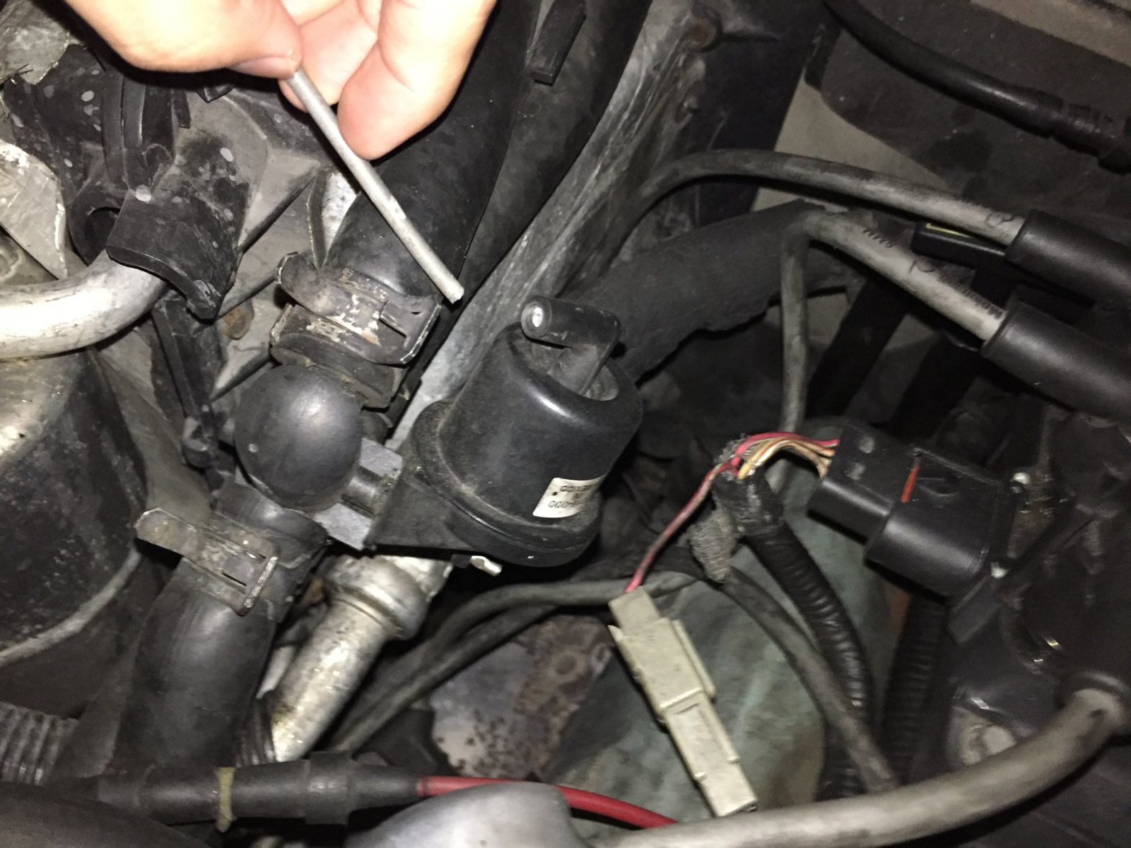

It’s amazing what looking under the hood can reveal. I’m 99.99% sure that this broken vacuum line running to the heater core control valve is to blame for my ac problem.

Is fixing this line as easy as replacing the elbow with the broken line in it? I’m thinking of replacing the old vacuum line with silicone line. Is 3/16 the correct size?
Snip a piece off and take it to the parts store.
Is there enough slack to get it to connect to the vacuum motor?
Yeah there’s about 6” of extra line. But I’m going to replace it with 3/16(5 mm) silicone line. Hopefully it’s not difficult to access the other end under the blower motor.
I went ahead and removed the elbow from the heater control valve and it just pops right off. I managed to get the now solid vacuum line out of the elbow and will be reinserting the old line back in tomorrow as it has plenty of slack.
I was going to replace the old vacuum line with a silicone version, but it’s buried underneath the blower somewhere and I don’t want to mess with the blower as it works fine. The line measured 3 mm in diameter for anyone who’s wondering.
