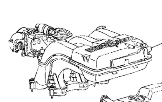

My 2002 Explorer shop manifold only shows one manifold with a side intake for the V6.
However, I know there is also a front intake manifold used in 2001 thru 2003 - possibly only on the Sports or flex fuel vehicles.
However, the long blocks are the same for both intake manifold versions.

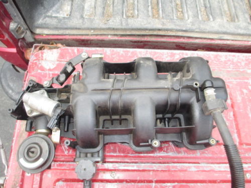

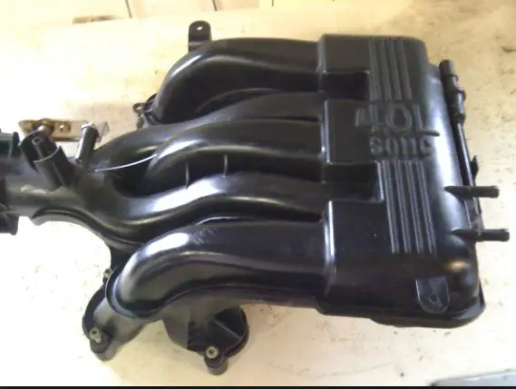

Maybe you accidentally bought an Explorer Sport / Explorer Sport Trac motor. as posted above the first two are normal explorer motors and the bottom pic is a Sport.
Either way, as long as its a 4.0 sohc, you can use it. Just swap your upper intake, fuel injectors and rail, and sensors that look different, and probably thermostat housing.
