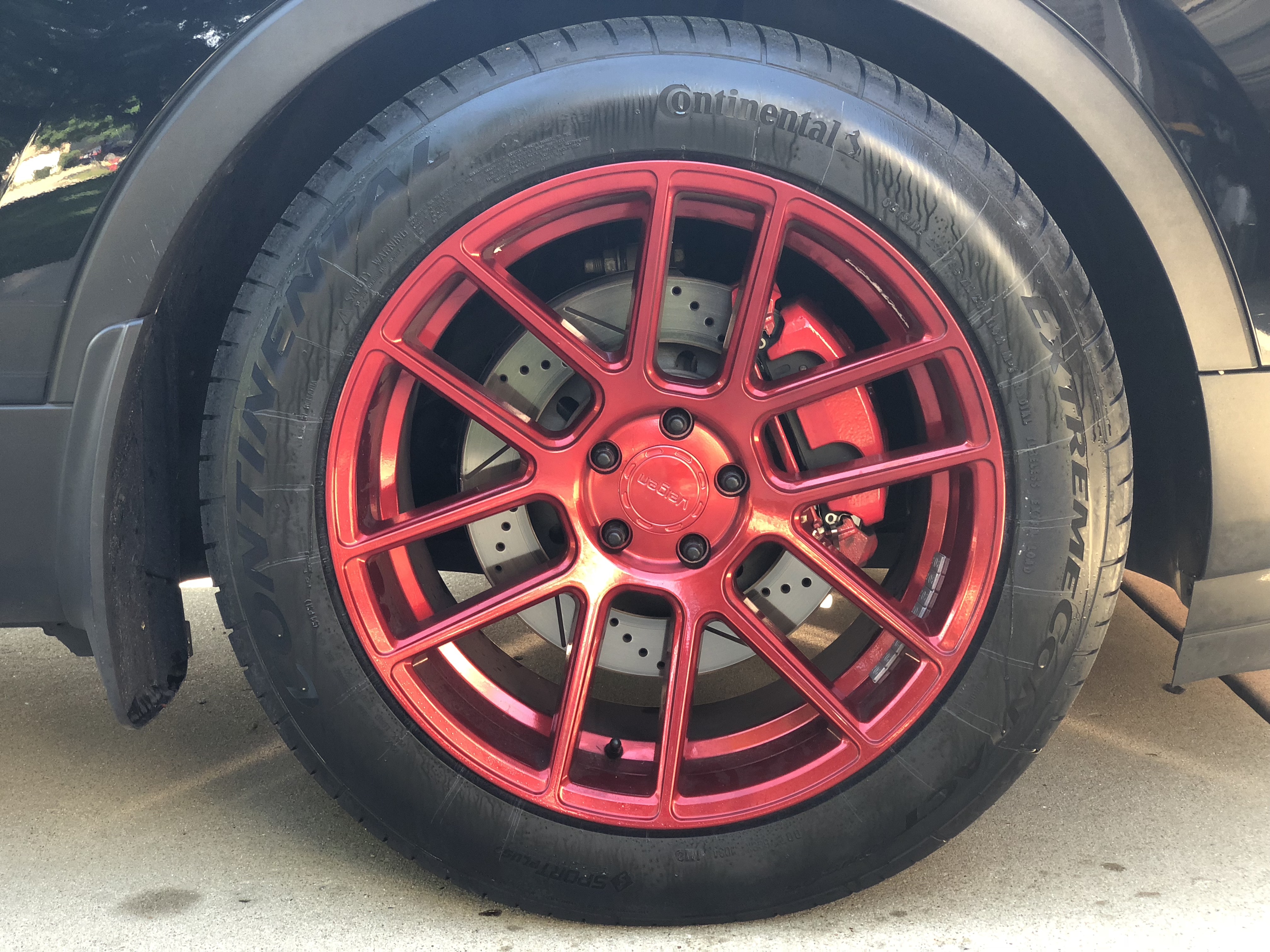

Just switched over to Continental ExtremeContact DWS 295 45/RZ20 Tires. Handle superb in dry conditions and supposedly excellent in the rain. Can't wait to test them out.
