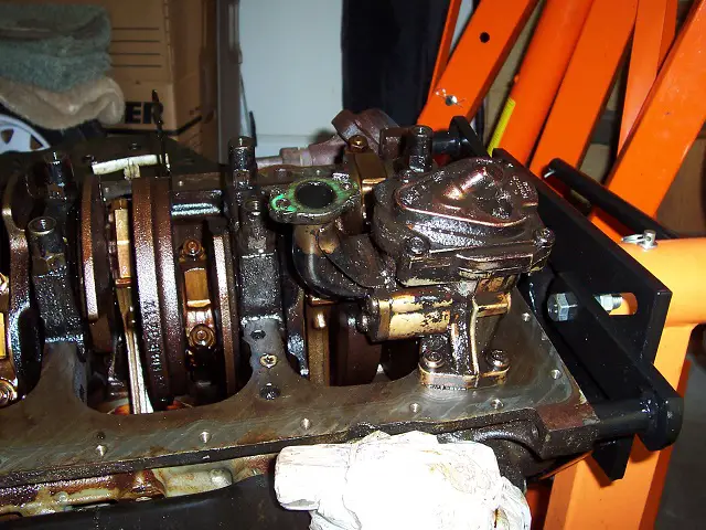

Also, i put my new rod bolts in. There were 3 main differences between the ones i replaced and the new ones: 1. the shaft was grooved 2. the head was larger 3. the numerals stamped on the top were different
I must admit, installing rod bolts while the engine was still assembled was a nightmare. And owing to the difficulty of getting the new rod bolts installed(far harder to slide them in then to tap out), im concerned that my rod needs resized now. call me an overly worrisome person, but im concerned(as ive never installed rod bolts before while an engine was still fully assembled). however, removing the rod, that isnt feasible. so we are just going to roll on. Only thing left to purchase is the OTC 6488 tool kit and i should be good to go! (assuming i dont immediately throw a rod of spin/destroy a rod bearing)

When installing the block cradle and gaskets don't forget to apply RTV at the specified locations. I assume that your block is mounted so you are able to rotate the crankshaft and did so to replace the connecting rod bolts. Hopefully you prevented the pistons from striking the valves when rotating the crankshaft.
I saw what you had mentioned about rtv in those assembly instructions, which again, thank you for that 2000StreetRod. And that is correct, i am now able to "freewheel" the crank and rotate it by hand. Since i still havent broken any bolts,etc loose, the timing is still locked in place, and i didnt have any difficulty turning the engine(except, of course, on the compression stroke/power stroke, then it was almost impossible and i had to wait for it to leak down to get it the rest of the way over).
