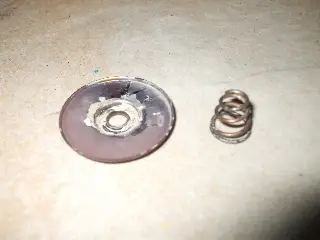

I have found that the thermostat in the SOHC engines has a bottom "plug section" that blocks antifreeze from flowing back through the engine and diverts it directly to the radiator. The bottom "plug section" tends to fail and fall apart from the rest of the thermostat causing overheating, but you don't tend to notice it until you need it to cool the engine the most.

Failure pending.
This is the bottom "Plug Section" off the bottom of the thermostat that I was talking about in my previous post. This one was found floating around in my thermostat housing.
When hot this was causing half of my hot coolant to flow through my radiator and half of it back through the engine, via the top of the water pump. It's kind of rough looking because it has been in the bottom of my toolbox for a while.
