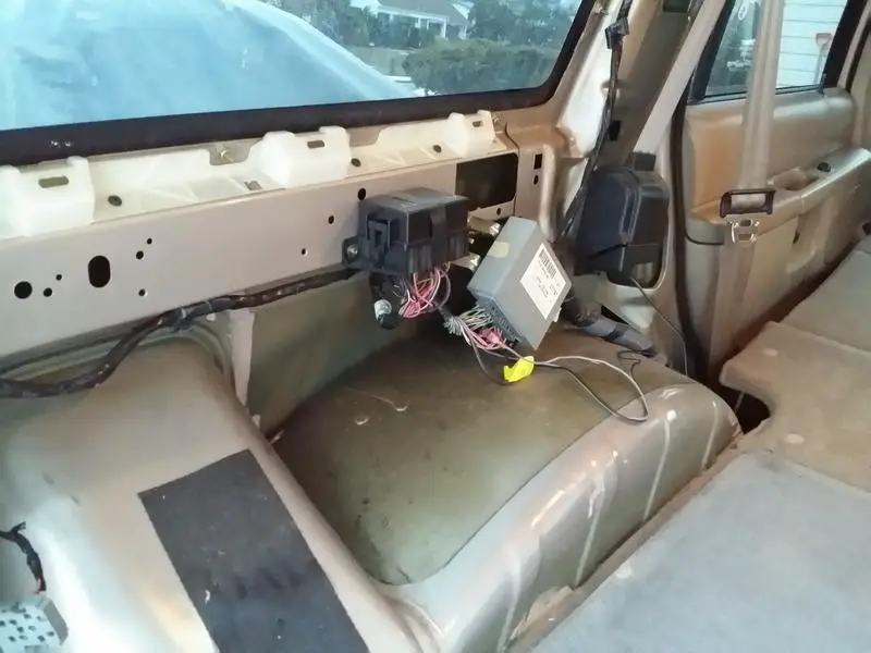

Doing some spring cleaning. :D
What are these box and wirings for? Are they related to the stereo system? Can I remove them?

that's your vehicle's RAP module "Remote Anti-theft Personality (RAP)" don't mess with it. it controls things like remote entry and the security key pad (if so equipped). the large 5 digit number on the sticker on the module is your factory key pad combination code.

Hmm, this makes me curious. I'm aware that the gray box is the RAP module, but what exactly is the black one?
I have an XL that didn't come with factory anti theft, so I don't have a RAP module, but I still have that black box with tons of wires..

If I don't want the RAP in my truck, is it as simple as unplugging it and the truck would start normally?
auxiliary relay box #2

That's the auxiliary relay box #2 (door unlock relay, door lock relay, driver door unlock relay, trailer tow/park lamp relay).
No. Removing that will be a big headache.

Oh, awesome. Somewhere to tap in for accessories. :D
trailer tow park lamp relay

If you don't tow a trailer the best source of power would be the hot side of the trailer tow park lamp relay. That's the DG/YE wire that gets power from fuse 30 (15 Amps) in the central junction box. The other relays are on fuse 18 (25 Amps) in the central junction box which also powers the lumbar and seat motors.

I found 5 relays. 2 larger sizes (unlock & lock) and 3 smaller ones hand-marked 1, 2, 3. Any ideas what those numbers represent?
According to the diagram I looked at, all three door lock relays are in "Relay Box #4 " - unfortunately, the website I use for wiring diagrams doesn't say what else is in that box. I'm pretty sure that box in the back is the lock relays. Easy enough to check if your battery is in - remove them and see if the locks stop working. Or pull the relays and look at the bottom - the driver's door unlock has terminals marked 1 thru 5: the other two have terminals marked 30, 85, 86, 87, 87A. Good luck.
I unplugged all of them just to see what happens. So far
3 small relays:
1. it controls the door pins that turns the interior lighting on/off
2.
3.
2 large relays:
1. doors unlock
2. doors lock
When I figured out what the others 2 are for, I will edit.
OK - that means that one of those small relays is the driver dooor unlock when you only push the remote unlock button once.
