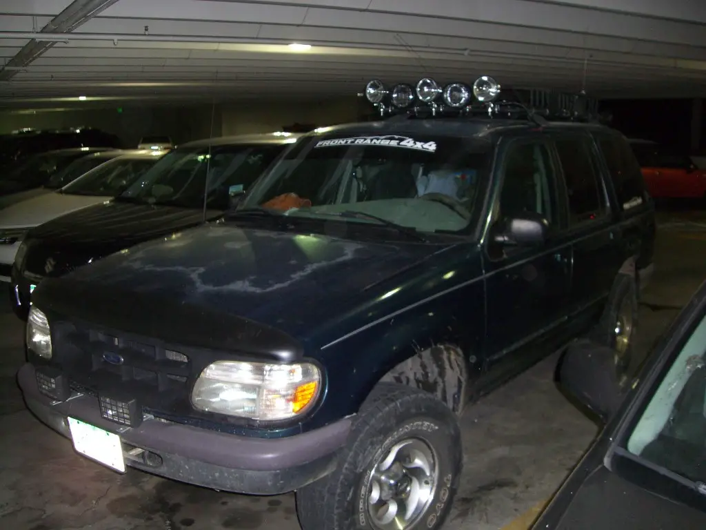

Let there be light...........
2 100w and 3 55w to go with the 2 55w on the bumper. Night run tomorrow night, so good timing!!

Finally got around to mounting some rear flood lights. I visit a lot of homes in a rural area and there's usually next to nothing for street lighting and each person's driveway is different. Now that the time change happened, it's common for me to venture out at night and backing up in the dark with only your tail lights illuminating things sucks. These should help and I wired them with 10GA wire so I can really beef it up later if these cheap 35-watt bulbs don't do what I need.

I finished wiring the rear flood lights. Ended up re-doing some of the wiring for the roof flood lights as well. Got both front (4 elements @ 100-watt ea) & rear (2 35-watt elements) running on their own 10GA wire with fuses, relay sockets and switches all soldered together with thick double-wall glue heatshrink. The only non-soldered portions are the connections to the backs of the bulbs and the relays, so they can be replaced. I'm a stickler for wiring perfection and not having weak points that may fail in the future.
