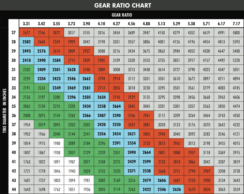

Another question cause I can’t seem to figure anything out on my own, but Iam just about getting ready to put 33’s on my 04 exploder. I have stock 3.55 gearing and was wondering what would the best gear ratio to throw in the rear for good all around driving. Thanks for any help and feedback.
v6 or v8? i see youre 2wd, so i would reccomend. 4.30 for all around driving. if you do more city less highway, then 4.56, and i guess 410 iif you do lots of highway. but imo 4.30 is the best all around. it will be slightly more agressive than stock, but i think it would ocmpenate nciely for the weight change in tires
Would the 4.30s be some what of a upgrade off-road too you think? Or around the same as stock?
what size tires you got now? i think it would be, 3.55 and 29s to 4.3 and 33 is an upgrade
this should get you close. i dont completely agree thoiugh, 3.55 and 29s on these aint my prefrence, 3.73-4.10is what i like with 29s. but you get the idea
Define all around driving? If you use it a lot more around town and highway than as a offroad toy 4.10 would be my suggestion.
if OP has 355, 410 is an upgrade, but imo its nothing you wpuld feel any difference/the vehicle could tell compared to stock. vs 430, i think that could be noticeable, and a good upgrade for the larger meats that are heavier. also consider wheel weight OP, more weight=more stuff to turn=more gear to do the same stuff

I have 31.8’s rn so basically 32inch tires with with the stock 3.55 and it is just a little bogged down soo its not a big upgrade to 33’s but just want a fresh start.
if 3.55s and 32s are fine for you (personally, i like all the torque i can get 🤣 ) then 4.10s should be an upgrade, or heck even 3.73s. if youre alright with what you got now, then i would suggest getting a low mile JY unit and just swapping it in, much easier and cost efective. for me, i dont even llike 3.55 with 29s🤣 so then either 3.73 or 4.10, i would suggest 4.10, mainly for around town and offroadability, and with 3.73youprobably wouldnt even notive a difference... maybe at WOT... but thats about it imo

I have 32s with 3.73 and I definitely notice the bog down.
At 60mph on speedo I am going 66 or 67 mph actual according to GPS.
4.3?? No such thing as a 4.3 ring and pinion
Choices are 3.73, 4.10 or 4.56 for a 8.8
4.1 with 33’s and auto transmission
4.56 if no highway gear needed or plans to go to 35’s eventually
