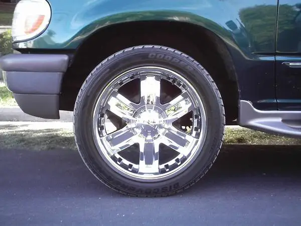

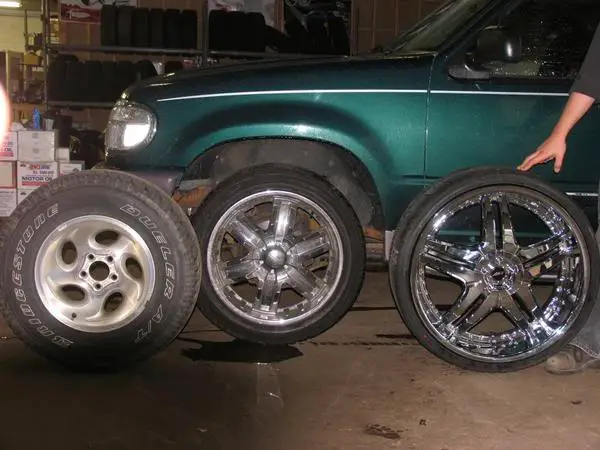

Yes, i am serious. 24"s will have a low pro tire, and ride quality... This truck isnt a caddy. My rims and tires dont even think about rubbing, turning the wheel 100% either way. What "sides" will the wheels touch?
15, 20" 24"
26"s
by they way, the 6"s ride great.
24"s
vs, the 20"S. Too much tire.
15, 20" 24"
26"s
24"s
Thanks for the pictures.
Question: Is your truck lifted in any way?? in the picture with the 20'' rims?
And looking at the pic with 15'', 20'' and 24'' the 20'' rim + tire are smaller than the 15'', i think it needs more tire.

Didn't want to quote the pics again. Ok, NO LIFT AT ALL. Too much wheel well... (sp?) Again, It's all up to you man. As im sure you can tell the 6"s got a 6" lift kit. Yes, it is a HUGE decision. Good Luck. Ha Ha.
I like the 20'' look but with bigger tire.
