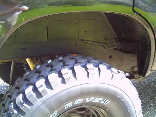

Rustoleum flat black. It doesn't get any easier to put on, and the stuff sticks like mad. Here's a pic of where I painted my frame/wheelwell with it.
