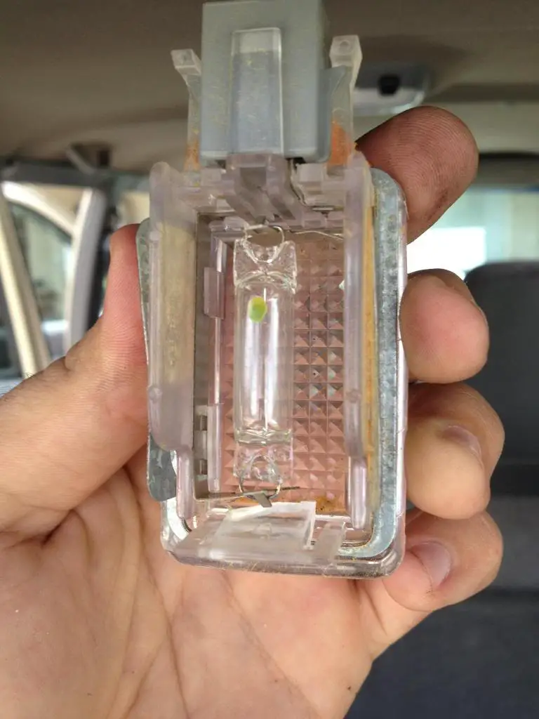

This is the rear cargo courtesy lamp assembly. I opened it to find it empty, which explains why I had no light. But it's not a bulb with a socket. Looks like a bulb that clips in on either end?
Problem is, the LMC catalog shows a bulb that requires a socket. Anyone know what type of bulb goes here?

So that bulb hooks onto the metal things and pulls tension on them, rather than fitting between and pushing against the metal plates?
Got a link for that bulb, by chance? When I search Amazon for "194 bulb", I get a lot of results that all look like socketed bulbs like the one under my hood.

I ended up ordering this because I eventually want to swap all the bulbs in the truck to LED anyway... this looked like it would fit the bill of straight OEM replacment using the stock mounting hardware:
