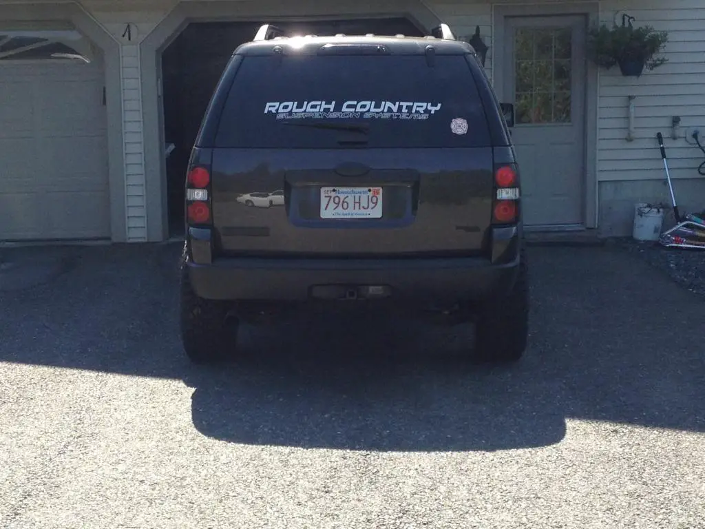

Finally picked out some wheels. I emailed this company that specializes in getting you a list of wheel/tire combo's that fit your vehicle with its modifications but I don't know if they take the spacing into consideration.
Im pretty set on the BFG KO2 tires, or the Nitto Terra Grapplers, but the wheel is the Fuel "Pump" D515, 18" by 9"
The specific wheel model is "D51518902650" which is a 5x4.5 and 5x5 pattern.
Specs are as follows:
Offset: 1 (What does that even mean?)
Backspacing: 5.04
18" diameter
9" wide
I do not want to run spacers. I love the look of wheels and tires that stick out a bit, and thats actually what I would like to see, but id rather run a wheel with the offset or whatever to give me that look.
When the Traxda lift is installed, it brings the hubs in a bit, so what will this wheel look like without a spacer? Offset and spacing are like Chinese to me...i've read threads about it.
And from my understanding, we have the "band" style tire pressure sensors. One of mine sometimes throws a fit, and triggers my light to flash even though I have proper pressure. I read that i'm way past the point of when these bands' batteries should've died, rendering them useless. I would like to upgrade to the now-normal style valve stem ones. Pro's/Con's of either style? I mean they both do the same thing, so I doubt it really matters, just seems like the stem style would be cheaper?
Thanks in advance guys!
