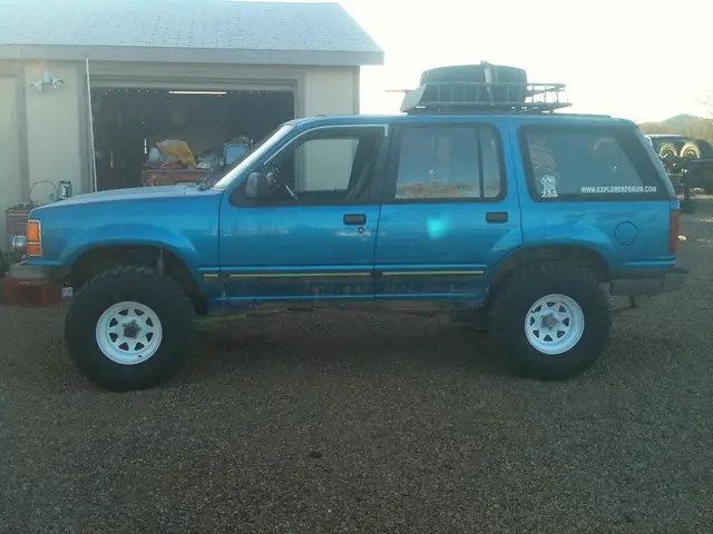

Here is a static "side shot" of the X before the extended RAs but the height is about the same.. I'm just not sure how Black Rims will look on a blue truck.
Coleman Side view by maniak_az, on Flickr

Well, I went with what was cheapest..
Total cost.. $150..
not sure if I'm gonna keep them this color, or paint 'em black. I think they look decent though..
New 15x8 Rims by maniak_az, on Flickr
