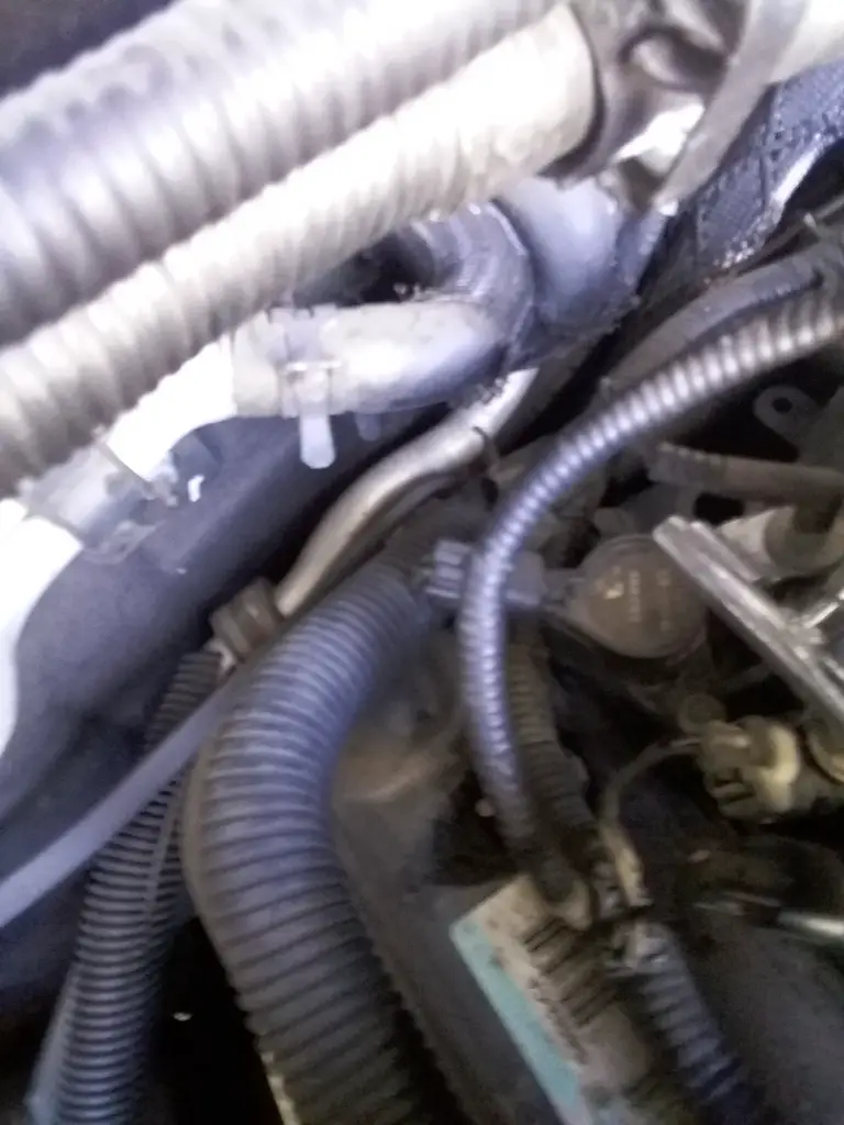

I am only able to see one pic and it is kind of dark. With that said are you sure it's a wire ansnot a vacuum line. If you look at post #19 by Tylors02, first pic middle to bottom right corner he has a line similar to what i think yours looks like. It is a black vacuum line (i think) and it hooks onto the silver fuel rail. Any chance thats it? That connection looks to be right under his throttle body.
Actually looking again at his pic that could be an electrical connection. But still a good chance its what your looking for. Check that fuel rail area real good.
On the rear of the fuel rail? I'll have to look tomorrow.
I labeled it "rear throttle body", but it barely even reaches the throttle body so maybe it is the fuel rail.

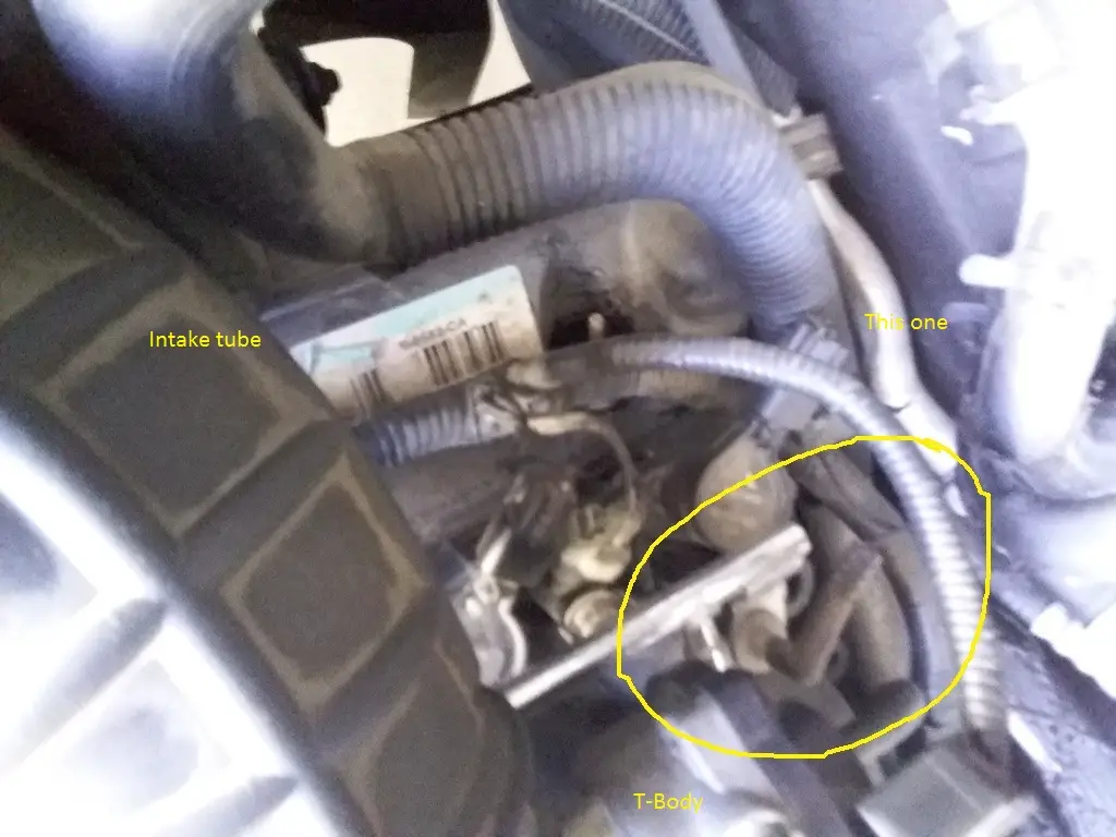

Thank you for highlighting it. Crappy picture only my forward facing camera works. It is literally right at the throttle body and I assume you keep referring to rear of throttle body as the side closest to firewall. That's exactly what you described and the only thing in that area that looks like what you are describing. It's a short wire (sending unit) and it comes out of the coil pack/fuel injector loom. Hooks up where coil pack closest to firewall is but on opposite side of fuel rail next to the throttle body

It's not this guy is it? Only thing I could find near throttle body on the firewall side. Mine is an 04 though so drive by wire
Actually, looking at your picture closer I think it's that little wire & boor on the bolt/stud holding the back corner of the fuel rail down (fuel rail ground?).
I don't know if my other post posted, but I think that's it on the stud that holds the fuel rail down(fuel rail ground?). That's on the passenger side of the truck, right?
Yes passenger side. Not too sure what it is but I believe its the fuel rail pressure sensor.

Yes but it's not the ground it's the fuel rail pressure vacuum sensor line (hose)

I'll check it out a little bit later today and let you know. That first pic you sent showed it on the fuel rail stud, the second picture shows it more on the clamp of the rear fuel line it looks like. The first pick might be more applicable to mine since I don't think I have a stud on that "clamp." Thanks again!

The first picture I posted is of my 04 4.6l drive by wire. The last picture was one I found online of an 02 drive by cable (same as yours ). Both are in same exact location. Stick edited my picture to make the connection and it's location more obvious for you.

The newest pic you posted does show The wire boot connected on what looks like a clamp on the fuel line, right?
Not sure what you mean by clamp. It's appears to be located on the stud, notice the nut under connection. Either way just check your damn fuel rail and report back. You either have that hose connected already and if not you have your answer. Let's at least rule out this connector it will take 5 seconds to check. Passenger side fuel rail right by throttle body but on the side of throttle body closest to firewall (what I believe you keep referring to as rear of throttle body )
