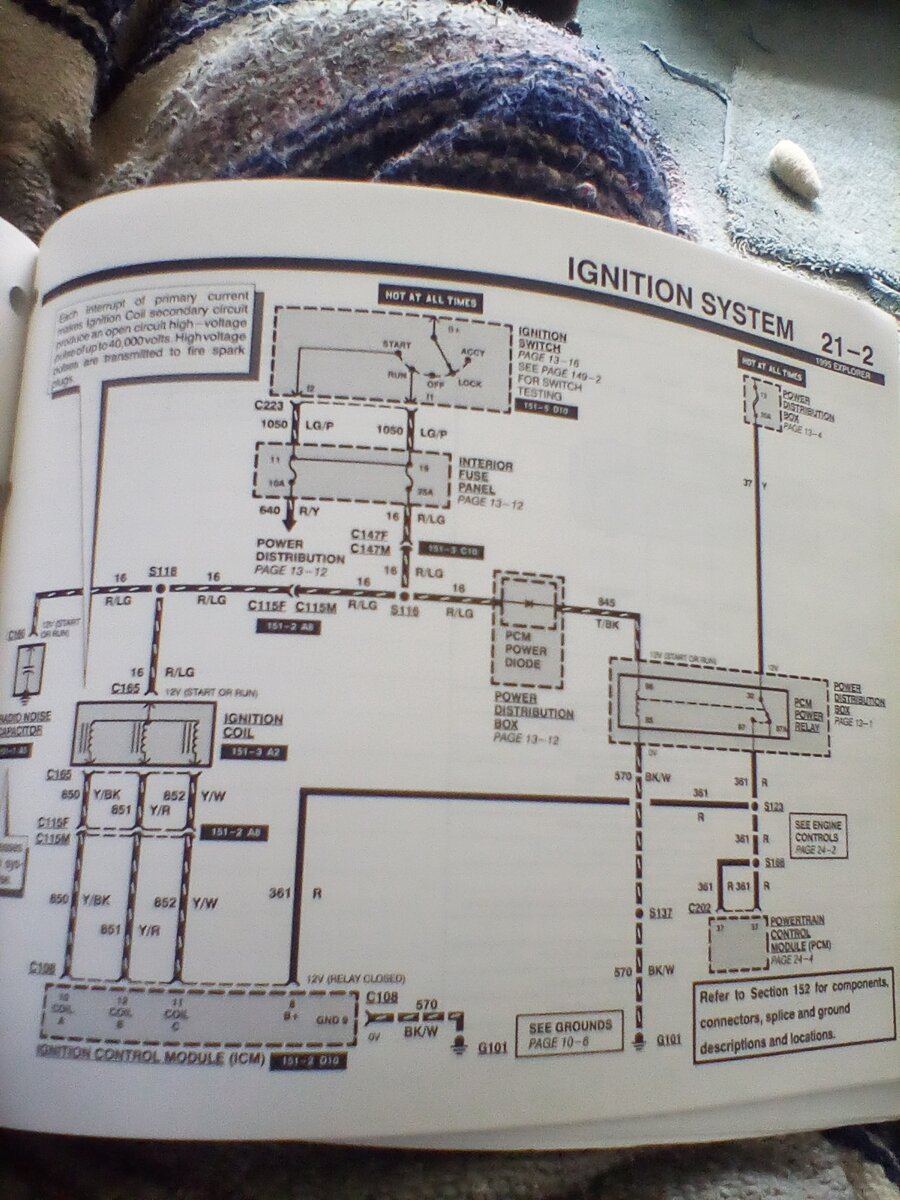

Thanks for the diagram, a tremendous help. What book do you find these diagrams. I was trying to install a new radio when I found the amplifier is in front of the passenger side rear wheel well. Surprise, suprise.

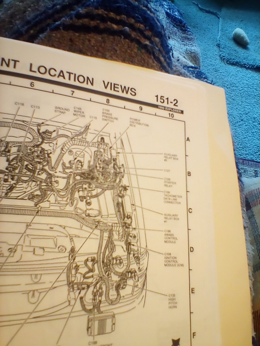

There is a ignition coil module, see picture for locatio.

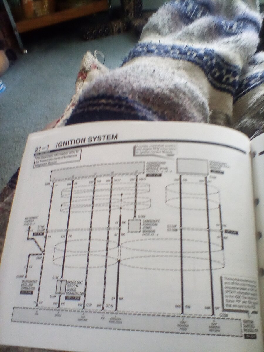

the coil Wires go to the ignition control module, ( which tell the coil to fire).
Then the wires go from the module too the PCM. See pictures.

Ignition module ,you want pins 10,11 and 12. Also pins 8&9
