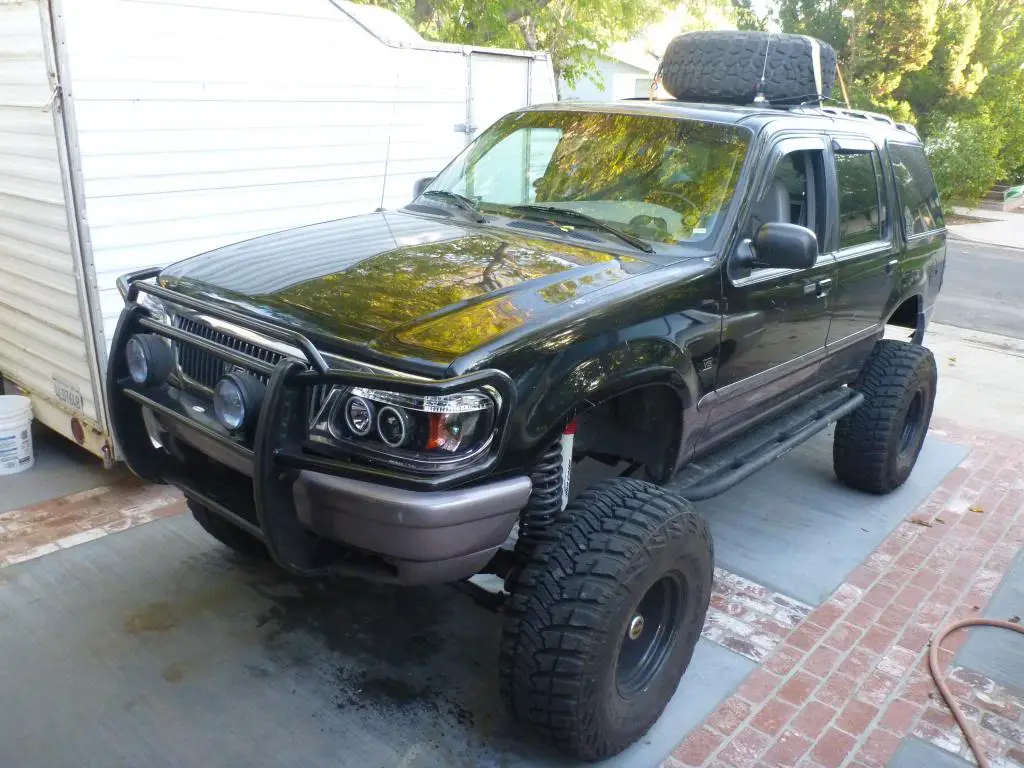

I have gone from stock to the one piece headlights and I now have home made/retro fit morimoto projectors. The retro fit wins hands down. if you want to be able to see at night, I highly recommend them. Here is the info:

I installed the headlights over the weekend. Here is a sneak peak of what they look like:
And here is a link to the album that I am keeping the pictures in:
Headlight pictures
Stay tuned for the comparative pics to the stock lights. They are better! I need to fine tune the alignment before I take the pics though.
Be patient, I will finish this at some point ;)

I got these for $60 on EBAY. They were returned units. One of the low beam CCFL's was out and there was a bit of dammage to a couple of the sockets for the turn signals.
The CCFL's use a ballast to light up. Both headlights came with a single ballest that runs the pair of CCFL's on the headlight for that side. I just hooked up the "angle eyes" around the high beams only so they don't look out of ballance.

There is a small ammount of wiring to hook up the LED's, the ballast for the CCFL's and upper corner marker light. Basically you need to wire them to each other and then slplice them in to the factory wire harness for the corner light. Pretty simple stuff if you know enough about electronics to read a volt meter to tell which lead is positive on the factory wiring and you can do crimp connectors. If not then invite a friend over for lunch and have him wire it for you.
Mechanically you pull out the turn signal assembly and then completly remove the headlight. You will need to take the adjuster screws out also. Then you re-install the new lights as if they were the turn signal lights. Pretty simple in my mind.
I think the headlight connections are pre-wired so you just plug the connector in to the existing factory wiring. I am not 100% sure on this though. I may have bought a headlight receptical connector and wired it on to the headlight.

They seem to be of simmilar quality to the other aftermarket units that I have seen at shows and such. Honestly I think that they are all coming from the same OEM, just with different features like the CCFL rings instead of the LED lit rings.
In short, they are not Ford OEM quality construction, but pretty close. The beam pattern is much better than our factory headlights, not quite as good as a factory projector. They do have a bit of scatter over the cutoff line, but the cutoff lie is very well defined. They are definatly better illumination on low and high beam than our factory headlights. I will probably do a fine tune to the headlight adjustments tonight and take some pictures of the illumination. Then post them up tomorrow.
