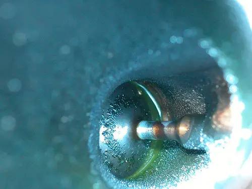

I was doing the OOM12 kit install today, and when I pulled the lower intake, I found this in cylinders 2,3,5, and 6. (Cylinders 1 and 4 could be the same, however the intake valves were partially open, so it may have run down into the combustion chamber already)
#5
#2
I've noticed that for the last year or so, I've been losing about a pint of coolant every 3000 miles. I could see it leaking into one of the cylinders if I had a cracked head, but how in the bloody hell would it be getting into 4 or 6 at the same time?
The other thing I'm thinking is that maybe it's oil, not coolant. I just did an oil change 20 minutes before this, so I'm wondering if it could be bad valve seals? It would explain the bright color of it (assuming it's oil, of course...)
Anyone ever seen this before? How alarmed should I be? How do I track the source?
