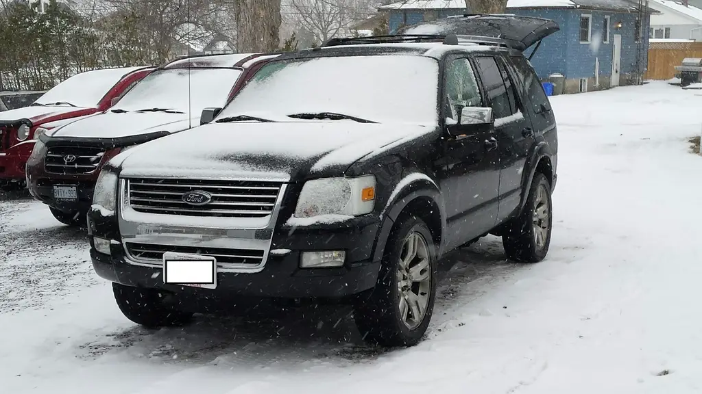

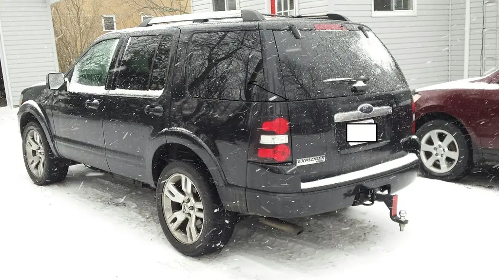

They were stock on the LTD as I understand. I will post a photo since the Explorer is here in my driveway. We are happy with it or rather my son it. LOL He's much more ok with black than I am. His came with very good condition Blizack tires on it.

Haha sorry no trades ;) I'll post a picture in the spring when I'm able to detail it and having it looking it's best.
