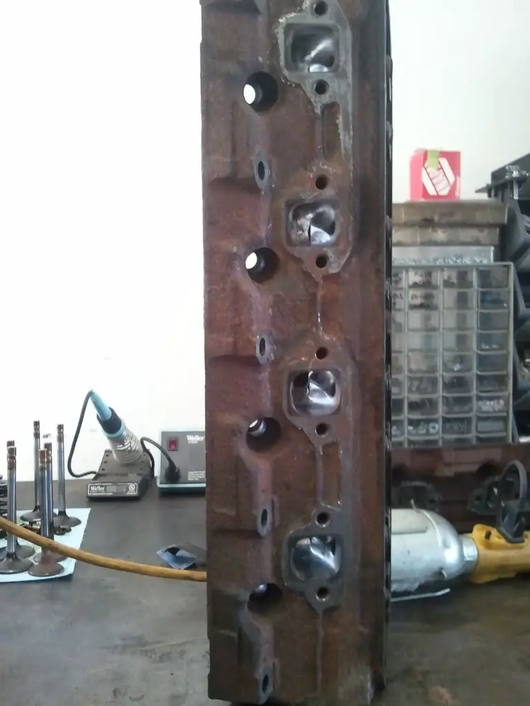

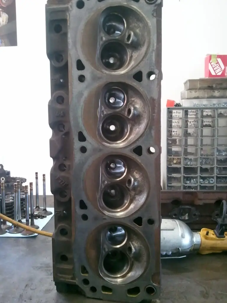

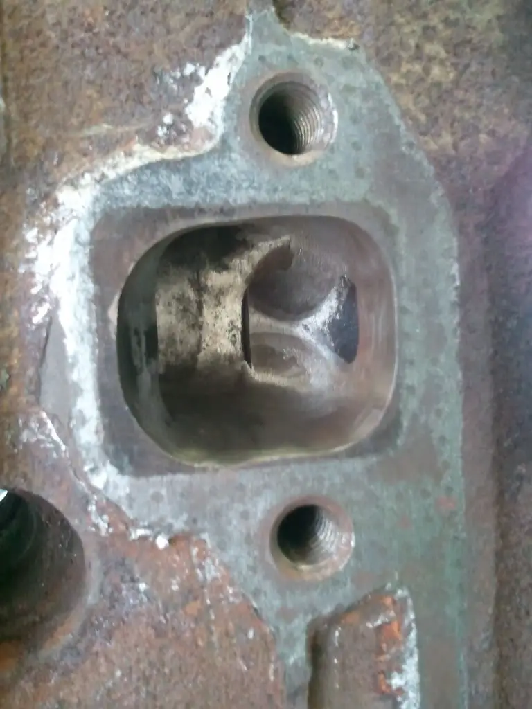

Nice work on the heads rj! Are you going to have them flowed? Porting heads is a daunting task for most people and time consuming. But Hey, if you can do it, why not? Are those GT40 or GT40Ps? You gotta know what your doing with the P's to get get the flow right. I figure about 10-15hp tops in the mid-top range with good mild port work.

Anyway, nice port work. I will be doing my own as well. I ported a 2.3 turbo head and got excellent results in my TurboCoupe. Not the previously mentioned low RPM dog with the T3\T4. That was a stock engine. I've had 3 of those. Yeah, I was hooked on them for a while.
I'm not planning on going wild either, just clean up the bowls, smooth the ports and try to match the intake to them. I enjoy doing it and it's not expensive so anyone who wants to tell me I'm wasting my time and I should buy aluminum heads cause they'll make more power, don't bother. (not a dig at you ssp, you didn't know I was doing it in house)
