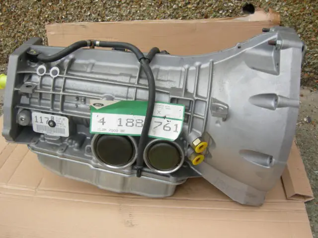

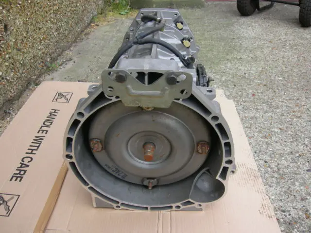

What about this? Will this fit? Anyone know what it is? All I have is part number 4188761

Is that the one on eBay from Hornchurch, Essex, UK? The listing indicates it's for 1992-1994, which would suggest it's a A4LD, also incompatible.
That is a 5R55N that will not go in the place of a 5R55E.
