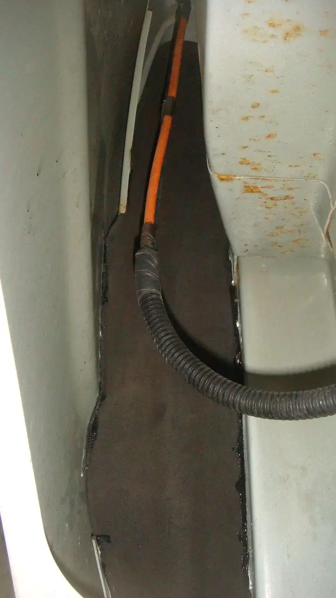

Okay so I've been having a lot of wind noise coming from in-between the fender and the driver door is there any insulation I maybe missing it was fine when I had the original fender 2 years ago.

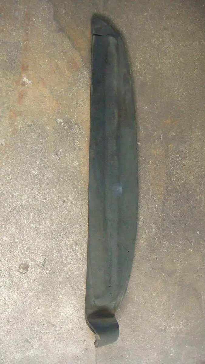

There is a insulation pad in the hinged area between the door and fender, full length. Also in the door strike have a plastic (PVC) tube on the latch strike bolt. When they drop off , now you don't have a tight door seal.
These overlooked foam "insulators" should be abundant at salvage yards. Bring and bend a metal coat hanger to remove.
How did you get into that spot to glue it?
How did you get into that area to position and glue them? I'm not sure what you mean by plastic fender liners.

Carefully. Surprised me these were only held by friction from the factory. Very difficult location to access. IIRC, I cleaned the contact surface as well as I could then applied the E6000 adhesive directly to the foam and carefully positioned them in place. What I like about this adhesive is it dries clear and remains pliable even after drying. Easy to peel and remove after it dries.
