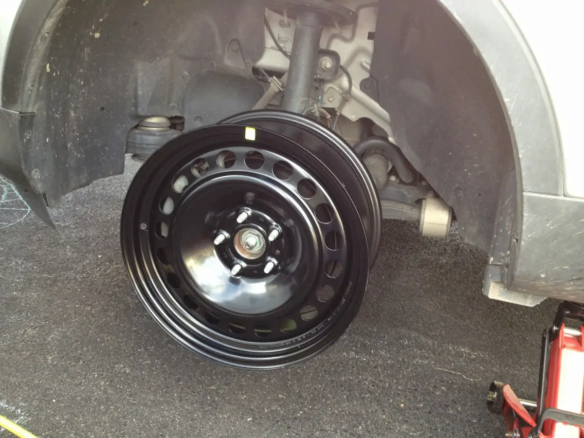

I picked up a set of 17" OEM Steel Rims - BB5Z-1015-A (since the Costco 17" ones are universal - only the 18" are hubcentric and $72) from my local dealer for $84.95 each since I wanted hubcentric rims.
Now before I left the parts person told me "We've heard the 17" rims might not fit where your vehicle came with 20" rims" - When I asked why that'd be an issue since I have an XLT with the 20" option and that should be the same brake rotors as the base or the limited - she said "well, just check because they may not fit".
So everything I read ahead of time and here seems to state that they will fit, but I'm still going to dry fit them at home before taking them into Costco to get some tires installed.

Here's the OEM 17" rim on an XLT - fits fine as expected

See my post #5 if you plan on using the Base OEM wheel covers. I would assume that info would apply to the XLT as well.

That is a good point to re-hash, although I'll just be going with the au-naturale winter look, anyone looking to use covers will need different lug nuts.
I don't really feel like adding another $200-300 to my winter costs by getting wheel covers. :) If I wanted the look I'd have gotten some alloy wheels from TireRack.

Thanks for the photos. 99% sure they won't fit over the larger Sport brakes.

I would tend to agree, I think you're into the 18" rims for the Sport. Costco does have hubcentric ones as previously mentioned in 18" for $71.99
