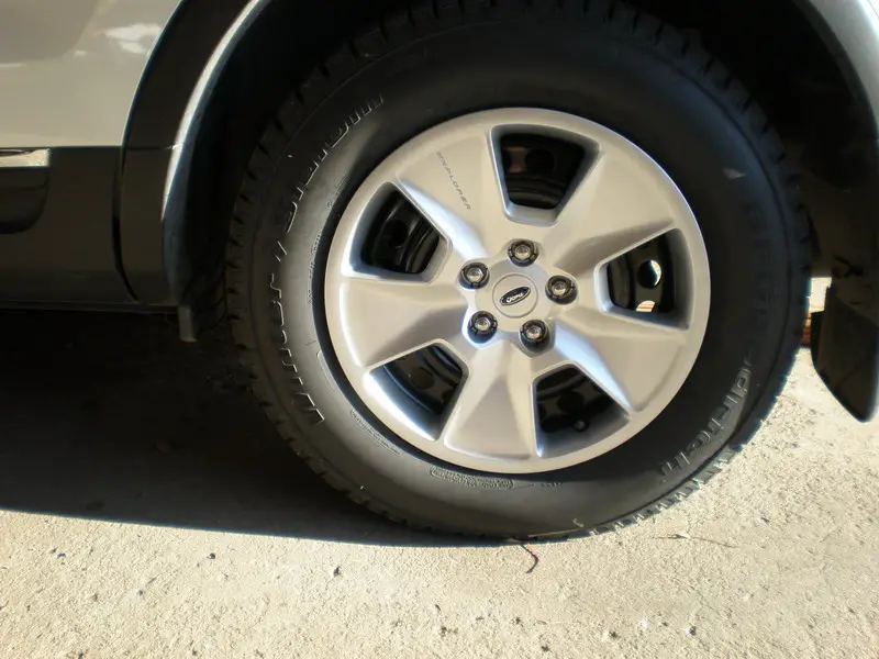

I use the 17" steel wheels from the Base model Explorer along with 245/65R17 Winter tires to replace my 20" wheels and have had no problems at all.
Be advised that if you want to use the base model wheel covers, you will need to buy new wheel nuts since the ones used for the OEM wheels will not hold the covers on. They will however hold the wheel on without the covers. The wheel cover itself does not snap on but is held in place by the wheel nuts which have a washer type flange build in to hold the cover on. See picture below.
