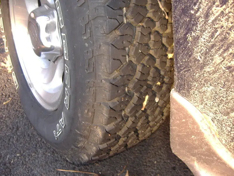

Basically any tire with the snowflake symbol and a bunch of sipes in the tread blocks should be a good tire. The popular BFG A/T tires (on my Ex) have the snowflake symbol but the tread blocks just don't have the sipes to make them great in the snow.

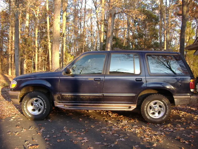

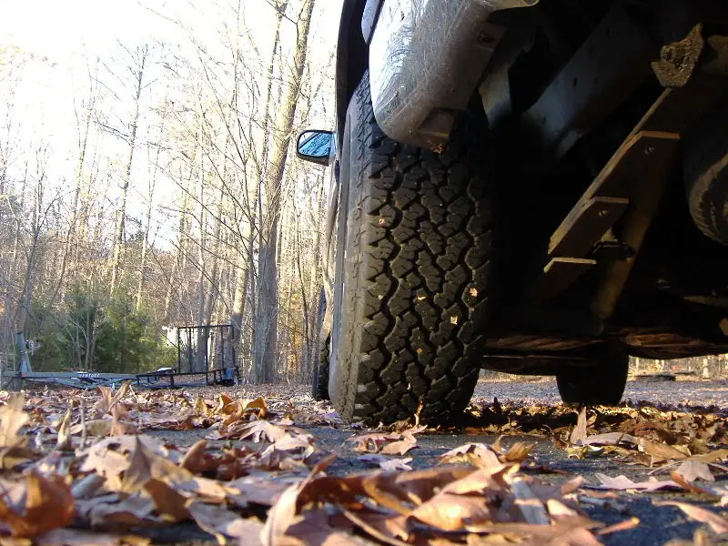

OK here are some photos of the General Grabber AT2 in LT235/75R15.
