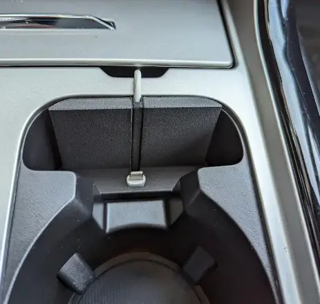

... found an accessory on Etsy that should be a standard offering on the Explorer. It basically is a tight fitting block that then allows me to just push my phone on as I get in the car and just pick it up as I get out, no more fumbling with wires, looks clean and automatically connects to the screen as soon as I put it in the slot
Looks nice, but will that require a near-perfectly sized phone for it? Otherwise it seems like the vibration of the vehicle is going to eventually rip the USB port off the phone PCB if it has some play due to the phone not fitting tight enough.

I purchased one of those for my wife and it works really well. A well designed product. Won't work with my Samsung unfortunately but I'm not the primary driver of the vehicle so that's OK. I have since changed phones to the s23+ and with my case it does fit. It still charges slow but doesn't get hot anymore. So I guess I'm good for now.
I have not had any issues. It seems to be a very stable holder. I have even hit bumps without losing the connection
Thanks!
It will work with both my wife's Samsung and my Pixel phone. :chug:
If you get one let me know what you think. I really like mine
