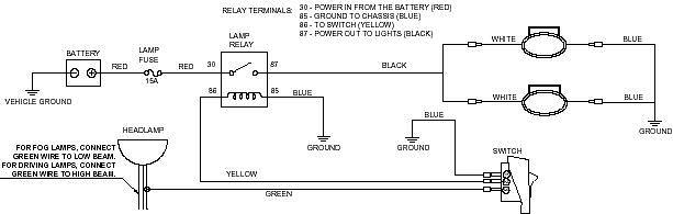

You can use the relay and wire them to come on any time your parking lamps are on:
or activate them with a switch.
if you want them to turn off when you activate the high beams (the legal method) just wire them like this.
