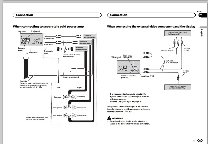

I bought a Pioneer AVH-X1500DVD to put in my X. It has AV inputs on the back but I believe it's for a rear view camera? Reading the manual (yes, I seriously read it. No joke) it only mentions using it to play DVD's and use a rear view camera.
So my question is, can I hook an xbox up to the AV inputs and it'll play? More importantly have a quality image?
I'll be grounding out the parking brake wire so I don't think making it play will be an issue :D
http://www.pioneerelectronics.com/PUSA/Car/DVD-Receivers/AVH-X1500DVD
Sorry my fault it appears those numbers are section numbers not page. (page 47 i think) here's the ones I'm talking about.
The rear view camera according to the next page should plug in on the left of the shaded area, near the subwoofer outputs.
Ah, so it should work! :D Thank you!
