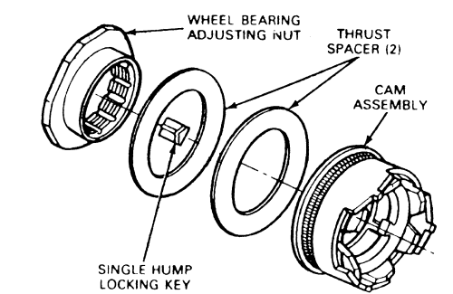

I'm trying to put automatic hubs on a truck that came with manual hubs from the factory, but there's nowhere to put the retaining ring. It seems like the axle shafts are different. Is it possible to drive in 2wd with just the bearing nut on until I get a manual conversion kit?
Do you have any pictures of your axle shaft and retaining hardware? The axle shaft should be a Dana 35 and work with auto or manual hubs. But if you're switching to auto hubs you must use the auto hub retaining hardware as shown. the manual hardware will not fit inside the auto hubs.
Automatic HUB retaining hardware
