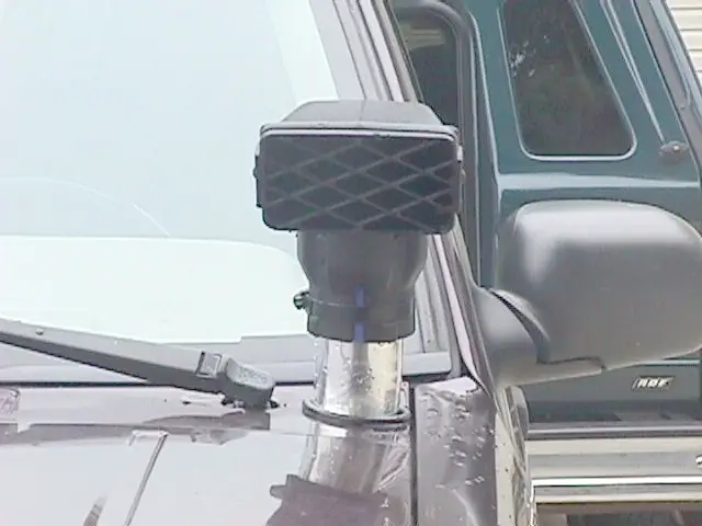

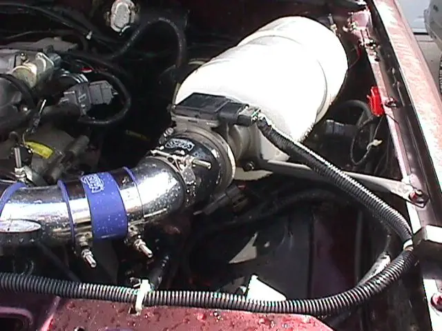

Looks good. Can you post a pic of your snorkel (some from the outside, and some at the air box)?
Sure. Email me if your serious about this because there is a ton of little things that may turn you off to doing this on the drivers side anyway.

Oh ok, thanks. I've seen that setup before. I plan on doing it on the pass. side instead, and coming out the fender (like 75% of the snorkels on this site are made). Thanks for the pics. :)
Thank you. Good Luck bud. I was just looking at you SAS thread.....Dayum dude... :thumbsup:
