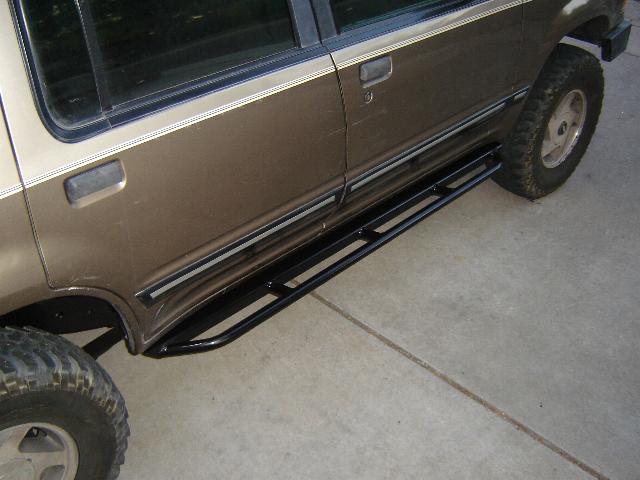

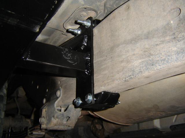

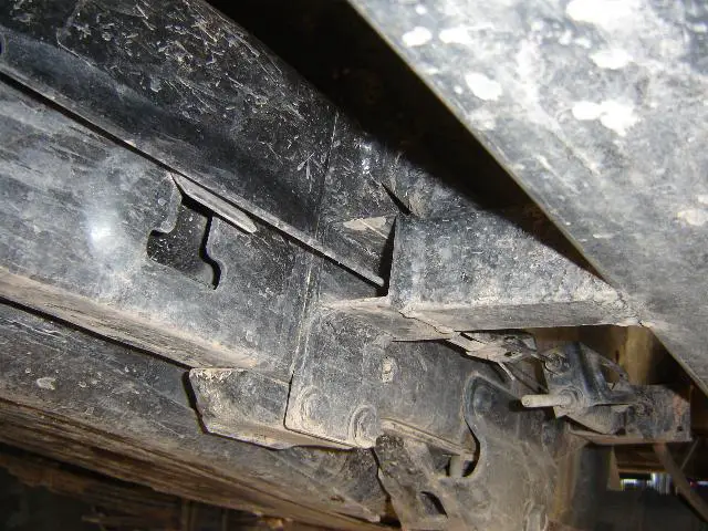

We ended up doubling the width of the sliders to keep the body away from obstacles. It's worked out great.
Oh yeah, we also took the lip at the bottom of the body and folded it over so the sliders would ride closer to the body.

For 4-doors, just hacking off the whole rocker is great, then you can weld up a set that are similar to Rick's, but that just go straight to the bottom of the frame without having to worry about that pesky body lip or anything. It also lets them ride just a bit higher for more clearance.
thats about what i have inmind! just runing from the bottom of the door to the bottom of the body where that pesky lip is, im not planing on doing major 4x4ing so i wont have to worry about clearance! and this is more for the looks part, so i dont have one side with no rocker, and the other with a partial!

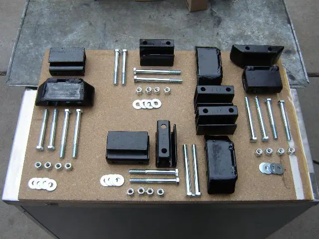

I just posted a link to some made for a Cherokee by cutting out the body and welding in box tube like a week or 2 ago somewhere in this forum. Look for that if you want ideas for what you are talking about doing. Mine: 100% true bolt on and very stout. I also folded the lip in like Rick mentioned, just have to watch bending the front where the fender bolts on or your fender and door will go out of alignment.

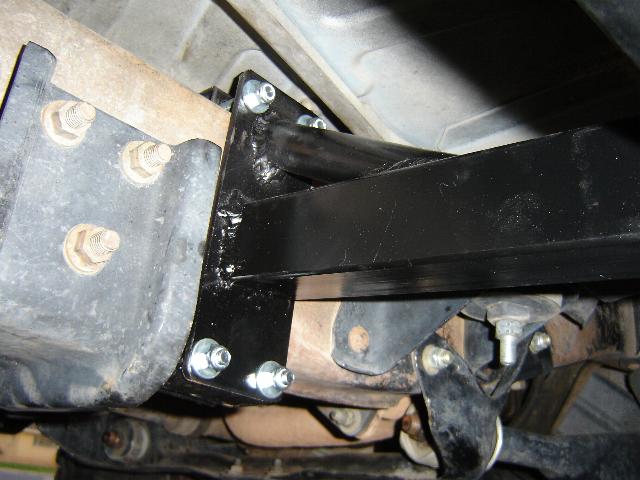

got any picts of how you did the brackets around the ebrake line?

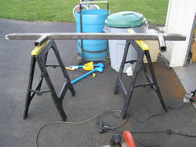

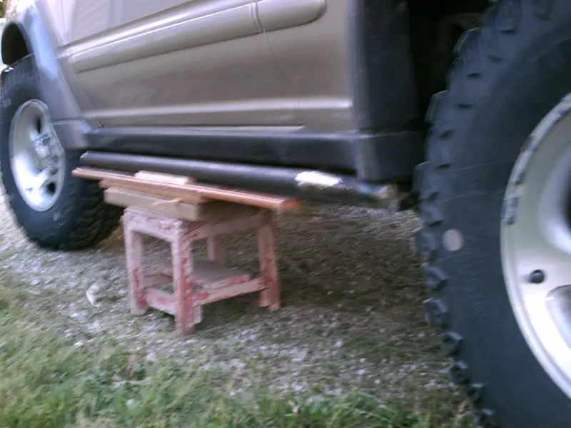

My sliders Pre-Installation:
And Post Installation:
Mine in their current state...
I'll be finishing them this weekend.

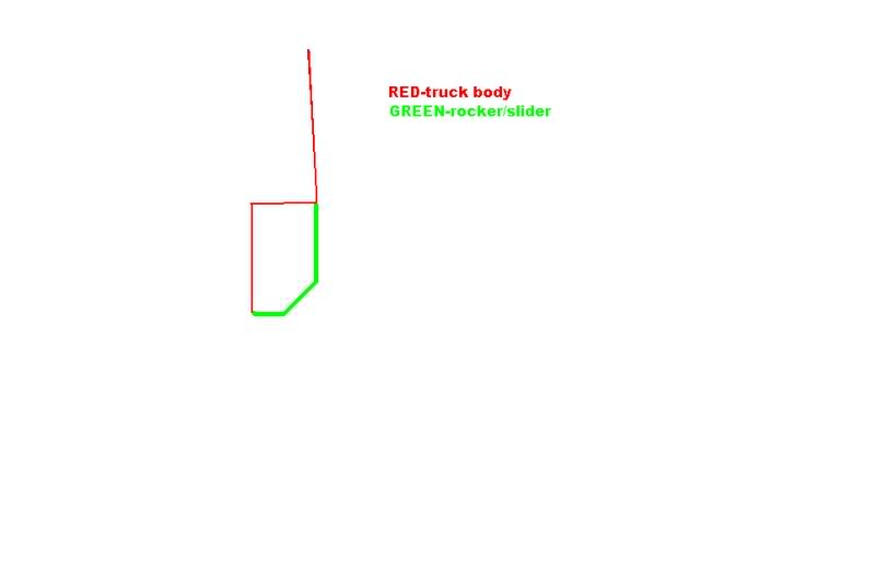

You could do something like this....
wow thats almost exactly what i had in mind!
sept mine would look closer to an exploder rocker, i did think about just runing the slidder from the top like the pic ,and then just slanting it, but i dont know how it would look i think the way i had it would look killer!
