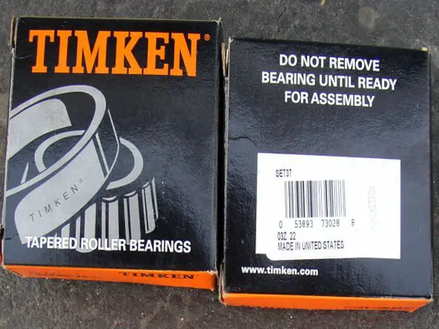

...Pulled over about five houses down and realized I would have to repair it where it sits the next day...I had previously installed new bearings a couple months back with one Timken and the spare pos Valuecraft to just get rid of it as I new I would replace them again before it went Wheeling next season...
...This time there was no sound or warning of any kind and yes, top quality bearing grease was used and this was an empty vehicle and trailer...In Fact, the Timken inner bearing looked Immaculate and the Valucraft exploded like the last time, and I mean exploded...
