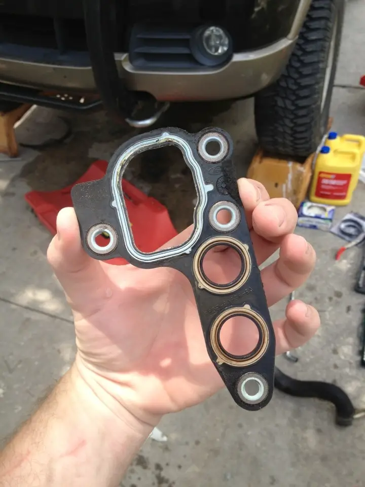

Here is a diagram and the bolt torque. Please make sure you drain your radiator before you pull this off otherwise it will be a huge mess as Command Pressence somehow experienced. I worked it from underneath but mine is 4WD. Maybe I had more room.
The big hole in the gasket is coolant to lower radiator hose. The 2 smaller openings are for oil in and out.
