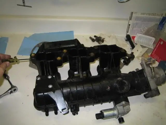

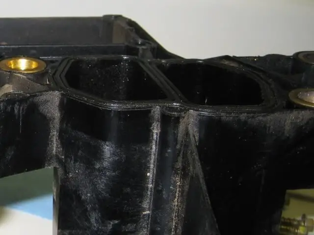

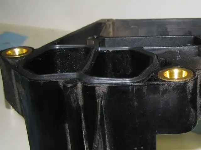

Moving on, all that said, at 181,000 Miles, your (3) upper intake rubber gaskets are TOAST - I guarantee it.
LINK TO EXPLORER FORUM WRITE UP:
Bottom of Upper Intake Plenium
OLD GASKET
New Gasket

I find that due to tight clearances encountered in the center of the plastic upper intake, you will need a 1/4" drive deep well socket (12mm or 14mm - I can't remember) so as to keep the socket outer circumference to a minimum.
This is necessary in order to have the socket at a true "straight up and down" direction when torqueing down the upper intake manifold (which is critical). The socket must be square to the nut in order to get a true torque value.
Came back to add this: Over dinner I remembered remembered an issue brought about by the TOP of the black plastic intake "plenium".
The top portion is glued to the body of the plenium, and that top portion has edges that extend outwards very far.
If you try to use a 3/8" drive extension and a 3/8" drive socket on the center nuts. your extension & socket will be at 5-7 degrees off center on the center nuts that you're attaching to. The 3/8" drive extensions outer diameter will rub up against the top portion of the black plastic upper plenium.
Lets put it this way - if this isn't clear now, it will be when you're trying to button up this job - PROPERLY.

intake gaskets are a must!! Also with the intake off you will want to replace the large green EGR O ring, not always included with the intake plenum gaskets
Also check the plastic intake plenum is not warped while it is off, a good way to do this is set it on a glass table
