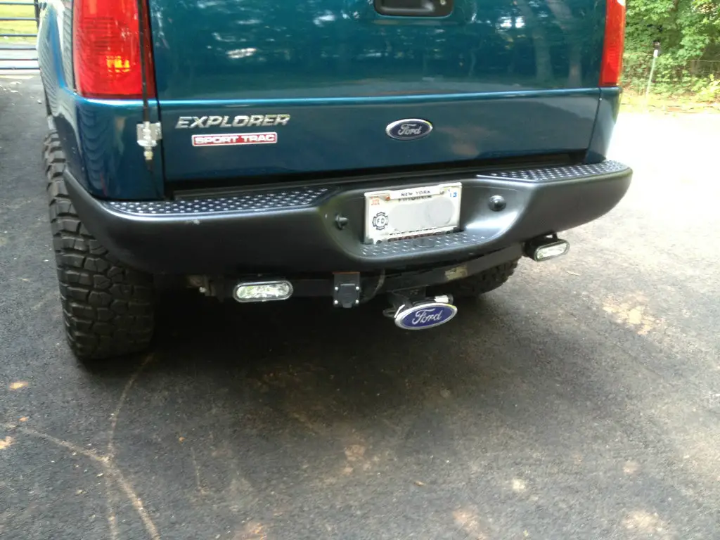

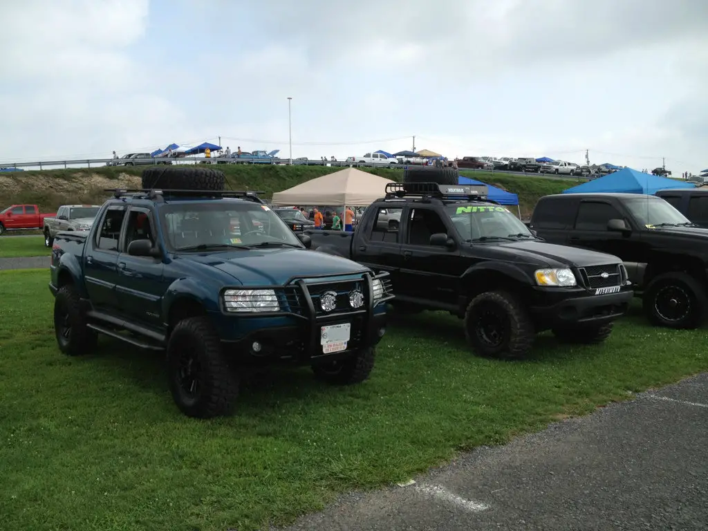

TT/Shackles + 3"BL on 35x12.50-17s. The black ST next to me is on 33x13.50s. The gap really isn't that bad, maybe 2" to the top of the receiver since most hitches have a little room for adjustment.

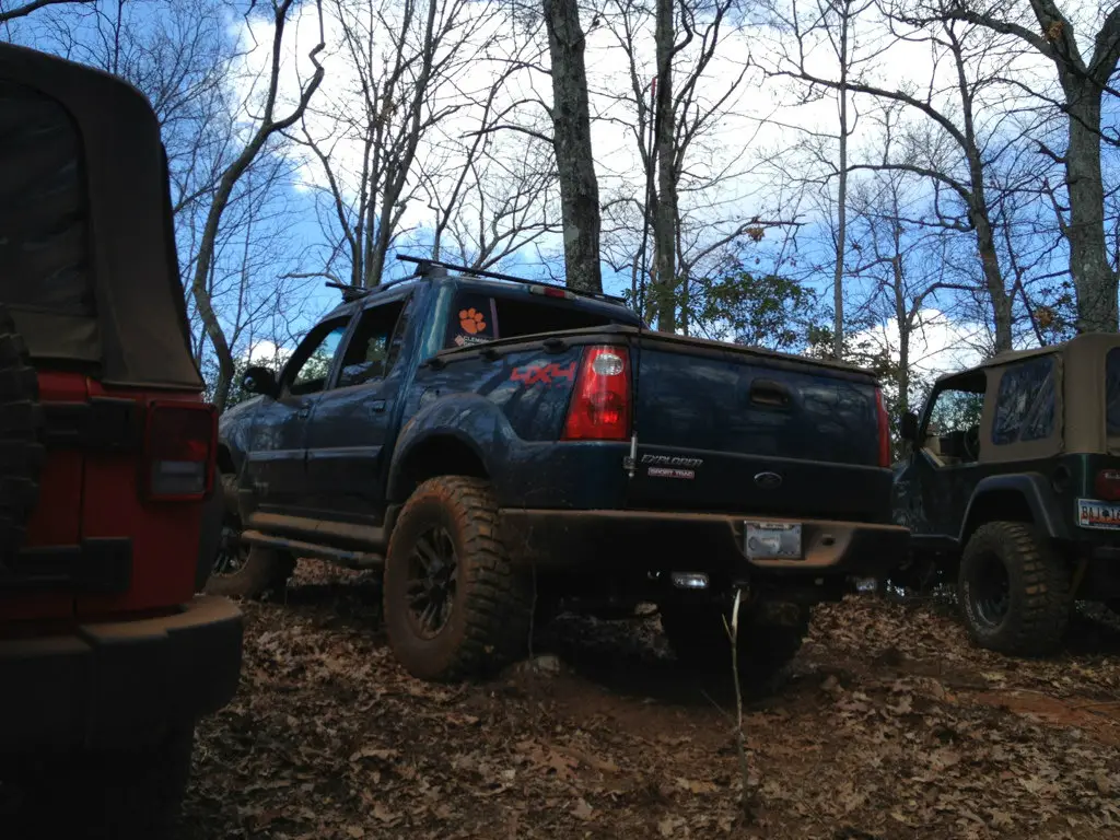

This is with about 9 or 10" of lift on 35s. My wheel specs are 17x9 with 3.75" BS -19mm offset.
