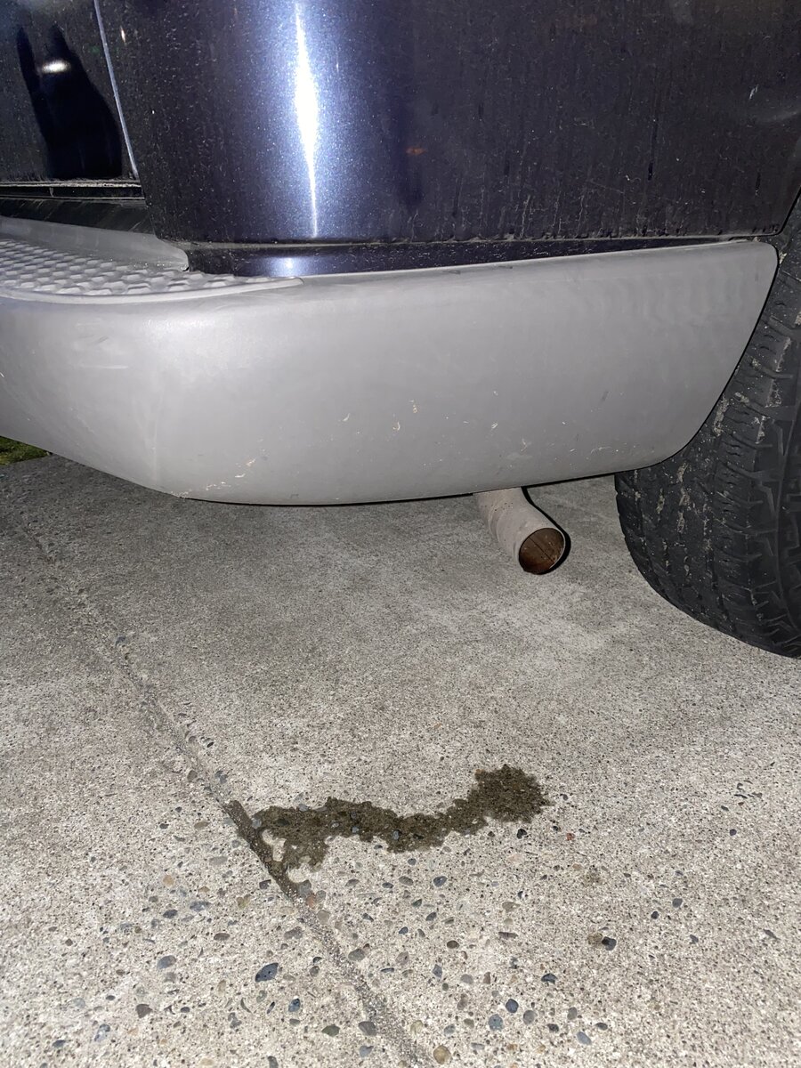

I’ve noticed the strong smell of gas when the truck first turns over and the exhaust seems to be leaking a small amount of liquid when stationary.

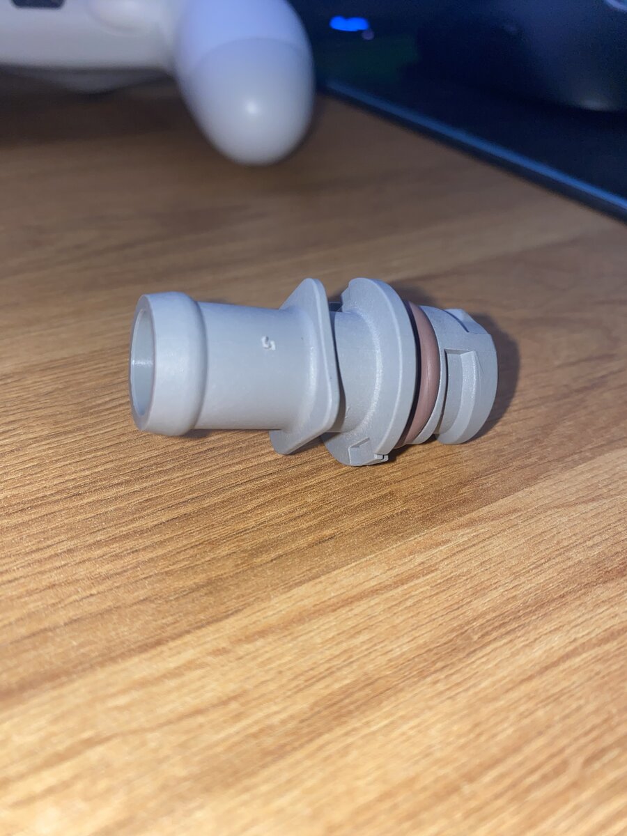

Took it to Autozone earlier to have the codes pulled and the 2 came back as p0171 & p0174. They told me it was a PCV valve issue and to replace it, however I don't believe the one they gave me will work after looking around on here. I had an 01 Job lot 1, the PCV valve goes into a T splitter, the piece they gave doesn't look like it'll go in...

(Edit: Added image of PCV valve they told me to install)
Po171 and 174 are almost always intake plenum gaskets in the sohc 4.0’engine
Try doing a search you will see the intake o rings dry up and allow air to leak
It is a fairly straight forward job
And not terribly expensive
Pcv is not likely to fix your issue
