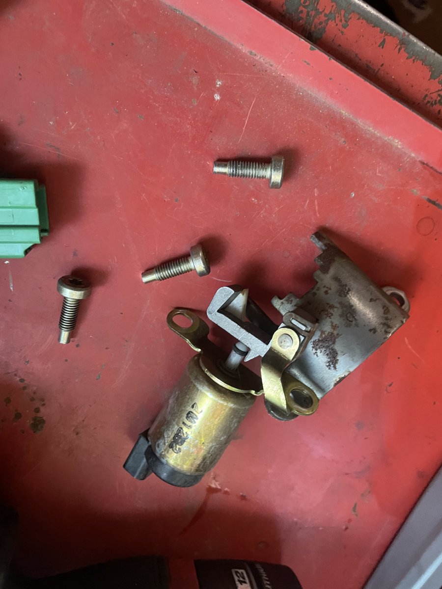

This one is actually bad believe it or not it refused to communicate with the rear speed sensor. I juggled them around a little bit you see the abs module in the 01 trac went bad (this one) so I had previously swapped it with the one from this 03… so this module is bad and will get crushed/recycled
The good one from this 03 is currently under the hood of the 01 v6 trax and working great

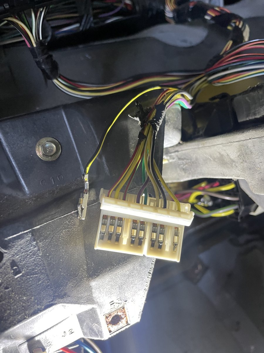

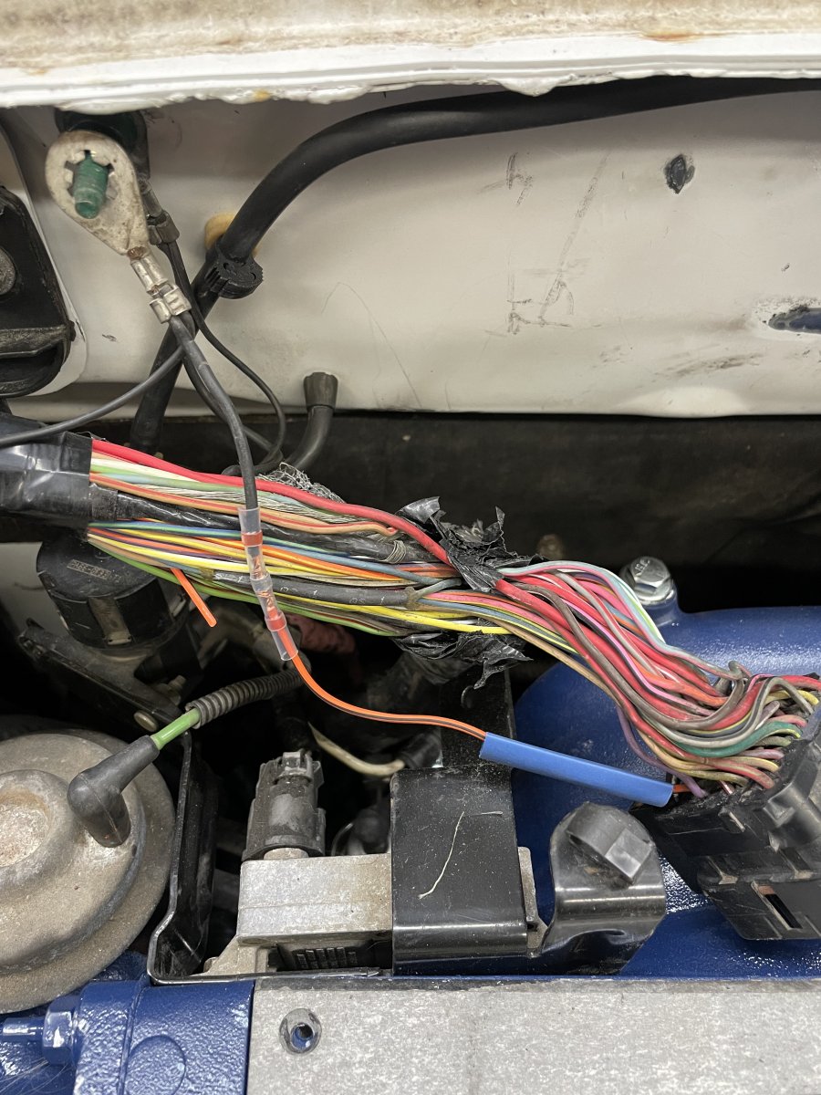

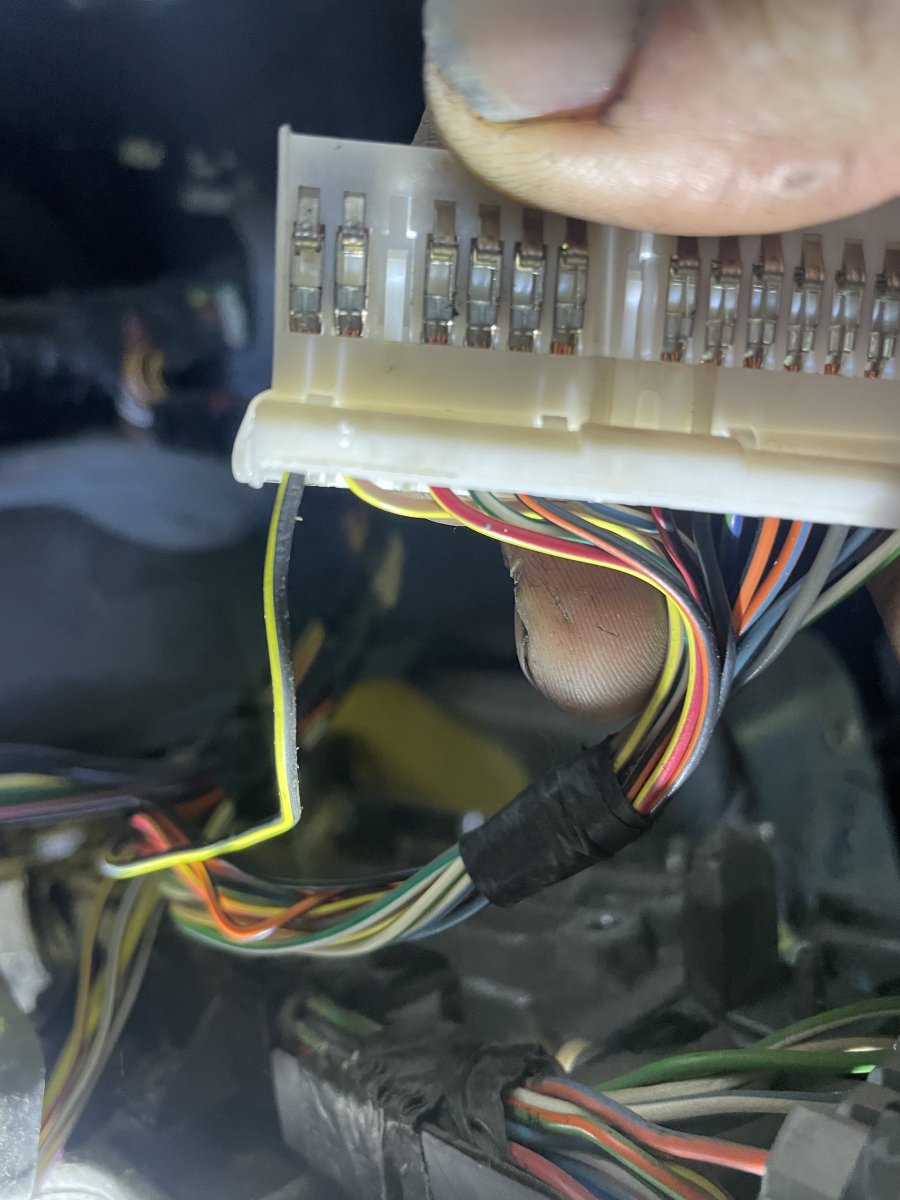

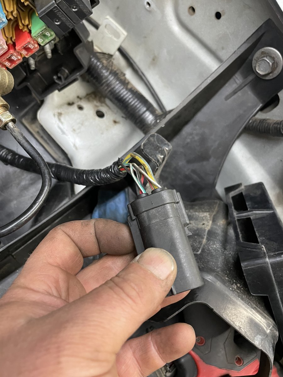

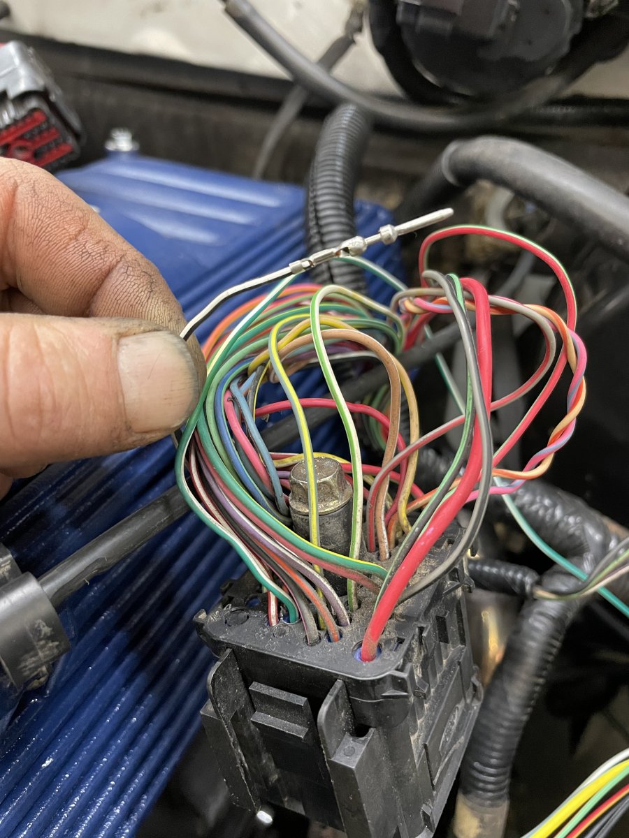

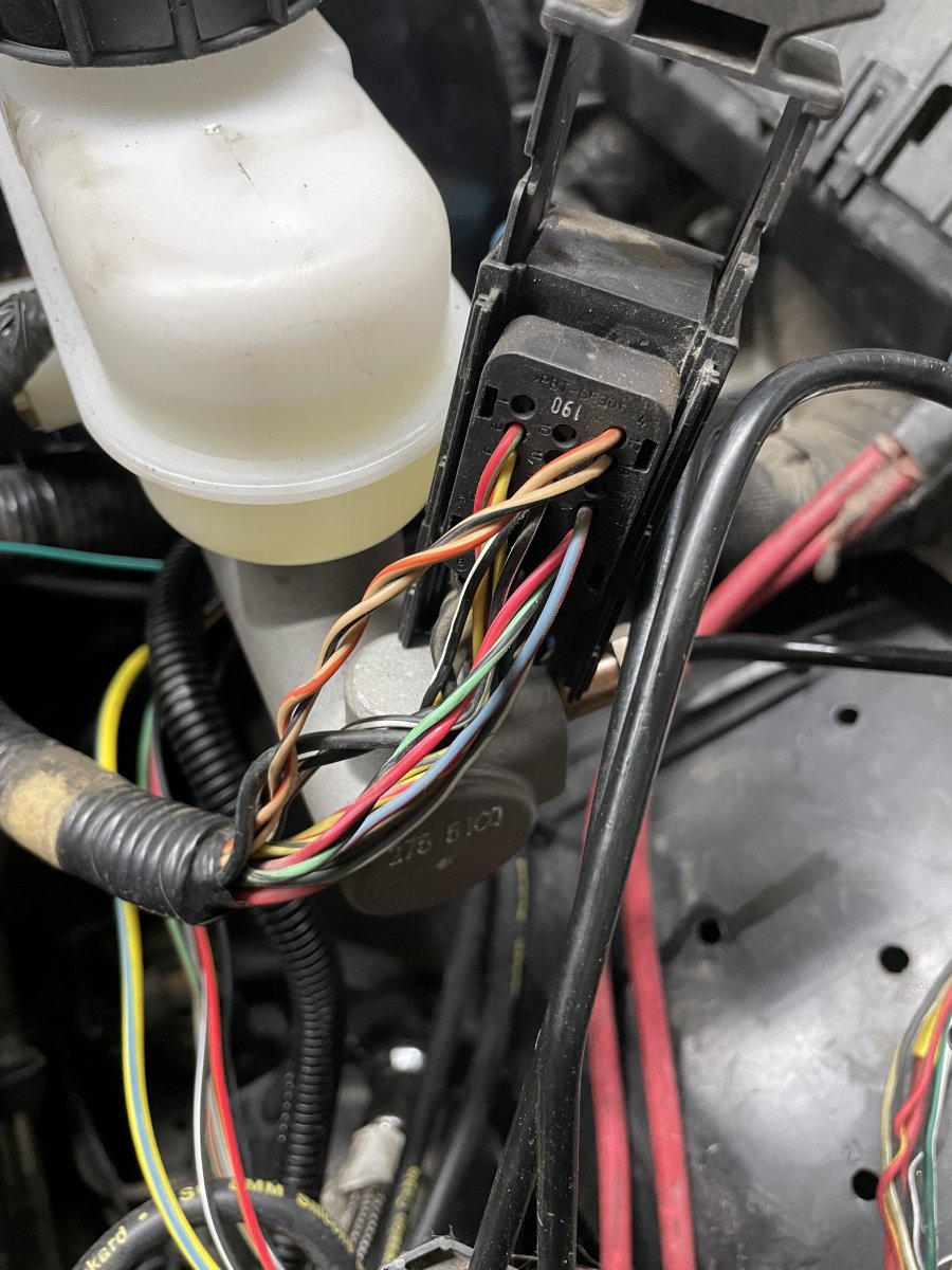

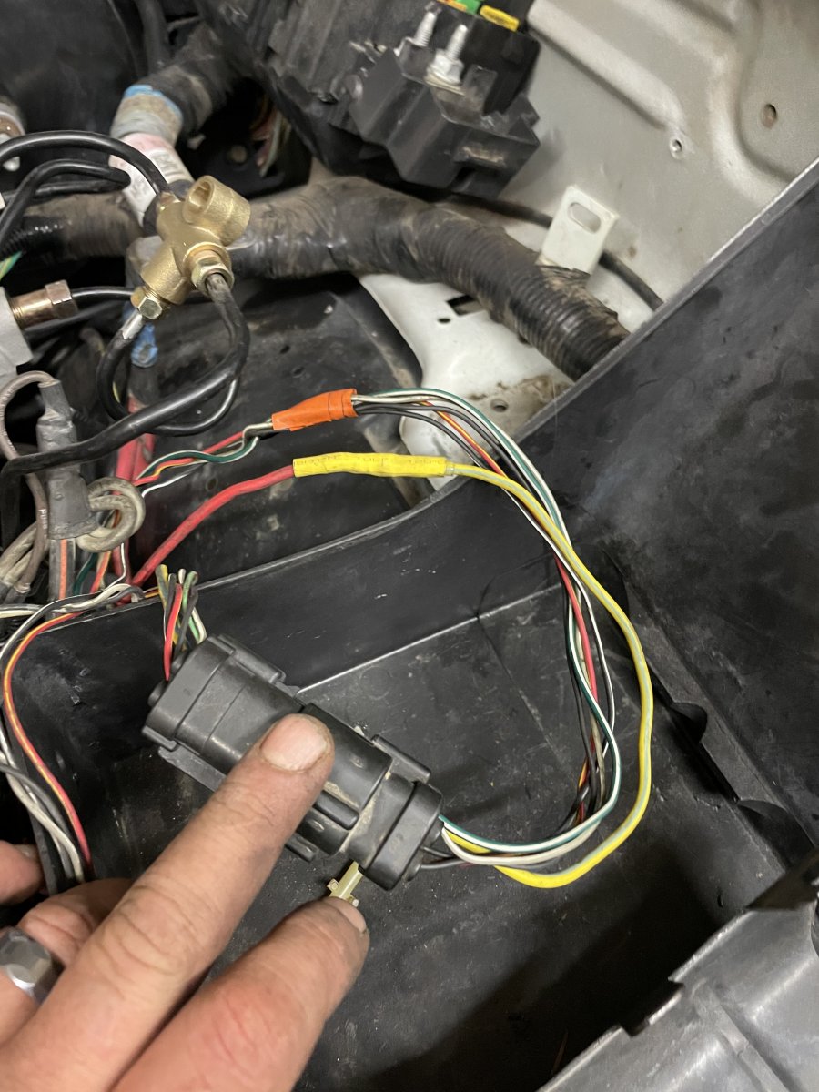

So here are some pics of all that wiring
Starter enable from ocm
For pats gets grounded near pcm

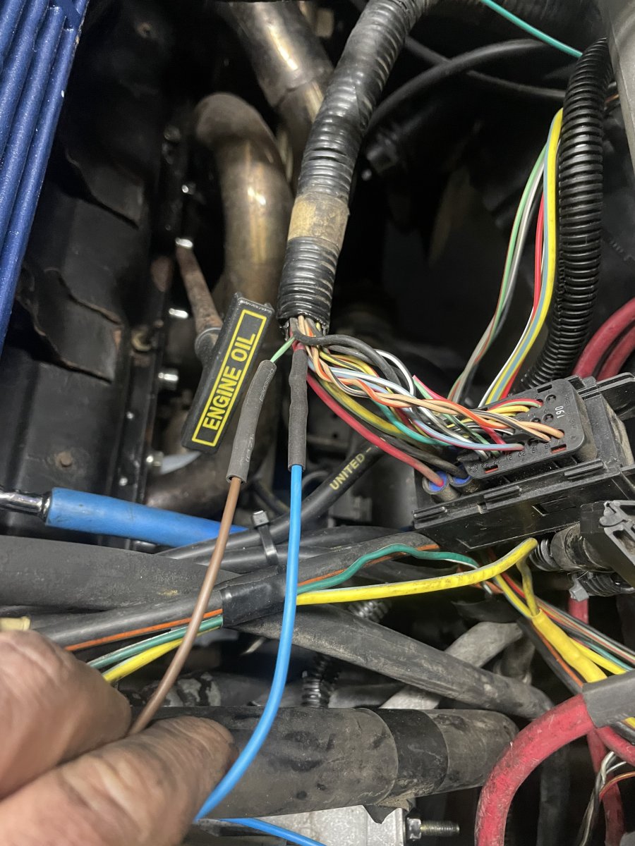

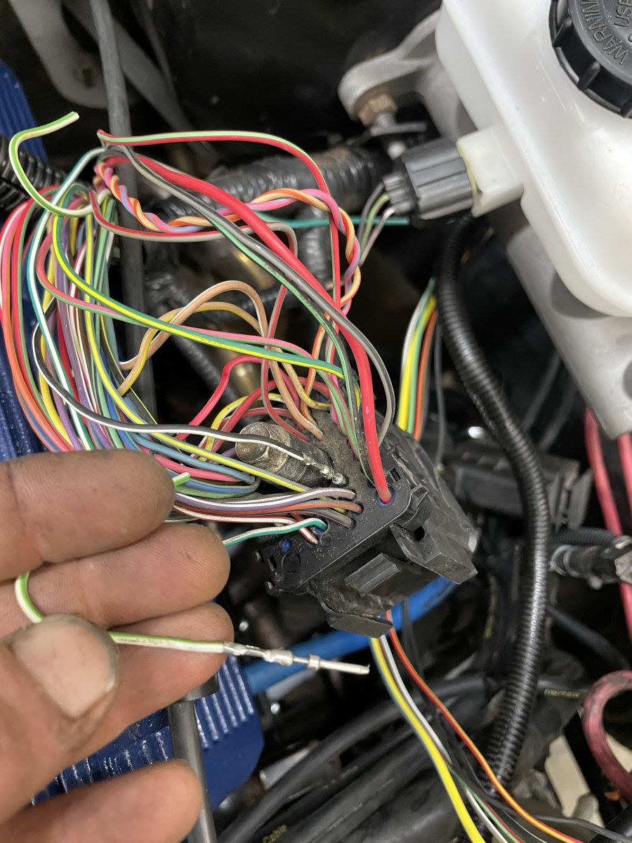

Dark green w white oil pressure to dash is re located from c139 to c110 pin 26
Rx signal that was in pin26 not needed. Replaced with oil pressure wire from c139
A few wires are moved around inside of the c139 plug also. Feeds for ac clutch and high pressure switch run through here so pins must match on engine side and truck side. Easy enough. Also the starter motor feed from start relay goes through here as does the alternator regualtor power from dash battery light. Wires were moved pins and added as needed

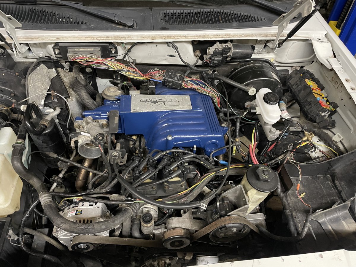

Conversion wiring completed engine bay side, everything g plugged in and ready for testing. Once it passes the test it will get wrapped back up

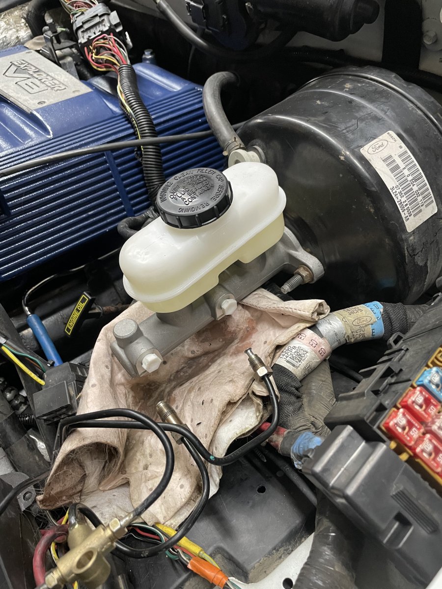

On the ABS unit, which line is the rear body line (running to differential) and on the master cylinder is it plumbed front bowl to front brakes and rear bowl to rear brakes?
I started practicing with my new line flaring tool and I may need to be cleaning the cut with a drill and bit after using the tubing cutter. That is before starting the flaring process...
Yes I file and drill and sand before flare after flare and during flare as needed
The rear port on master goes to rear line on abs pump it is obvious which is which as the front feed has two lines besides it the rear has just the one

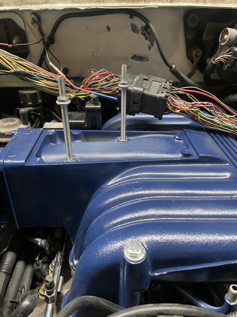

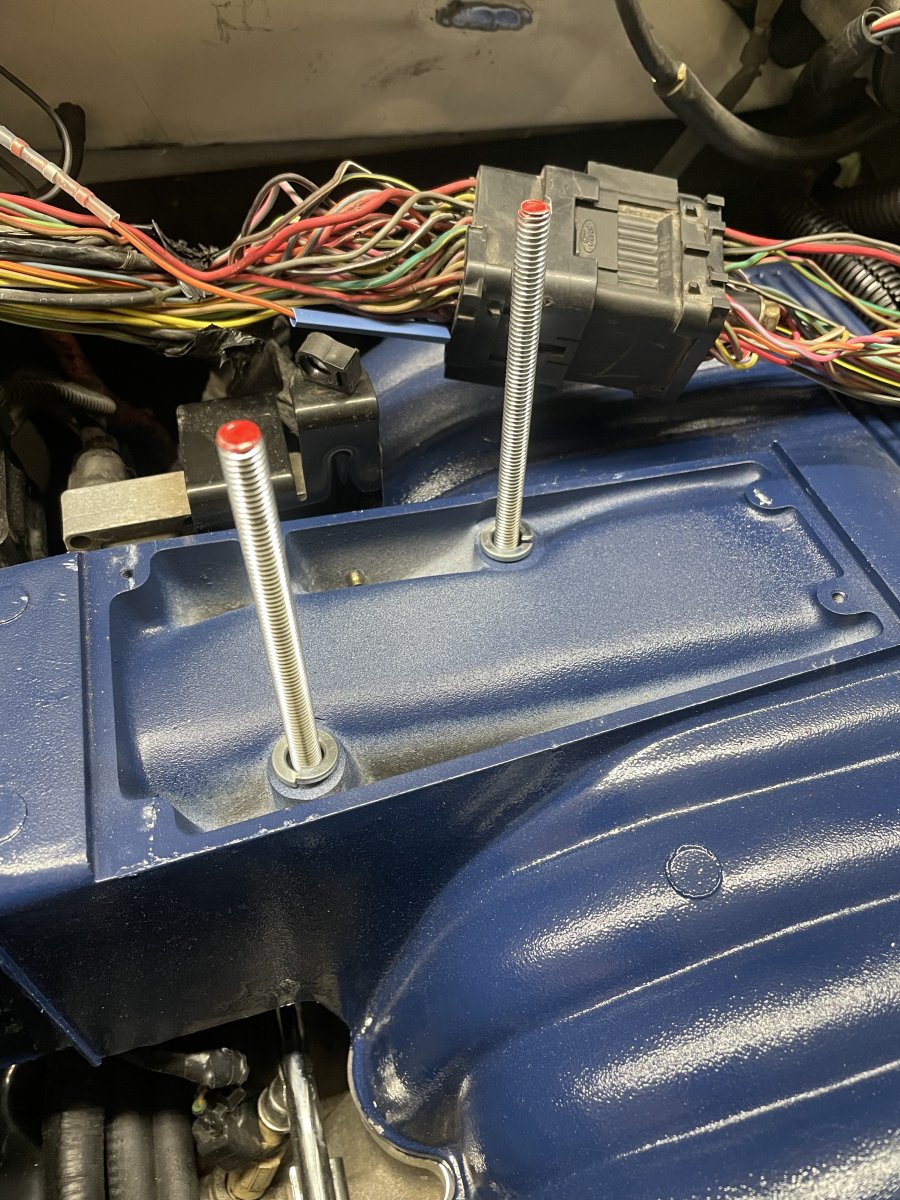

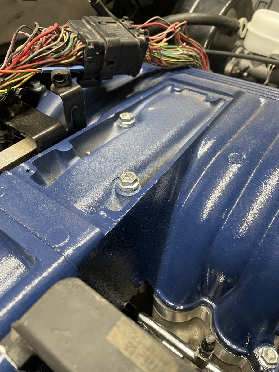

Got some 5/16-18 threaded rod to
Make my intake bolts for the spacer
I ordered 7” long bolts but got tired of waiting
Carefully cut them

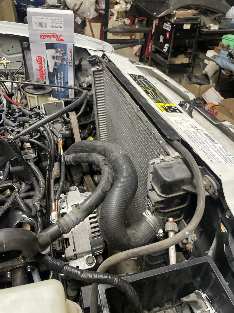

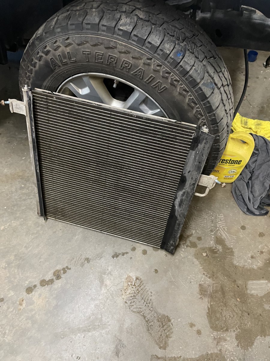

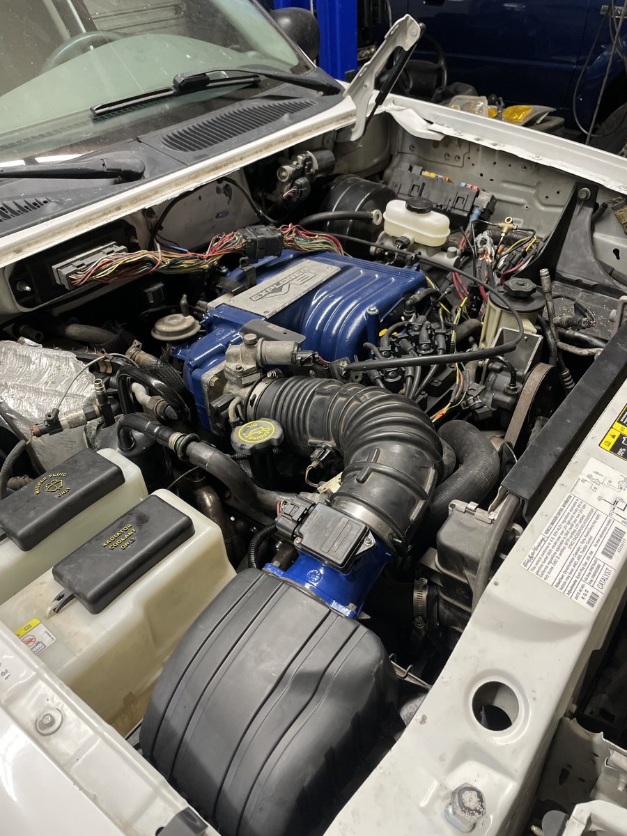

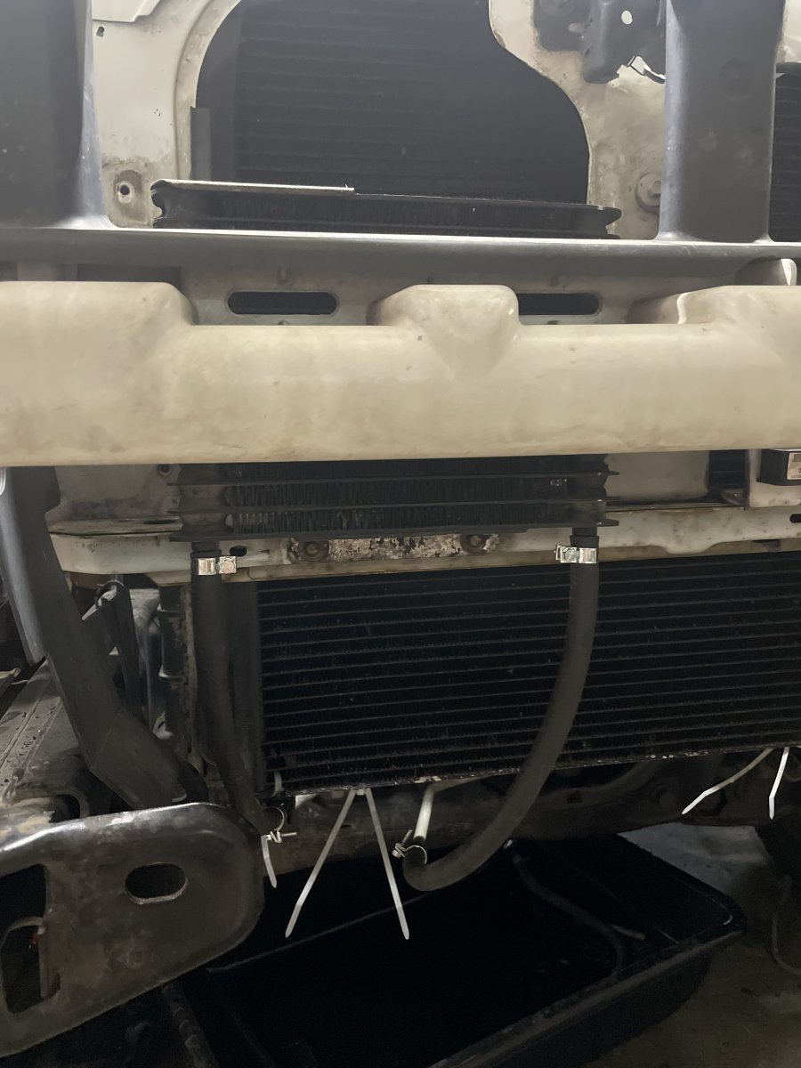

Then I found a good radiator and ac condenser
So the cooling stack is in complete w fan

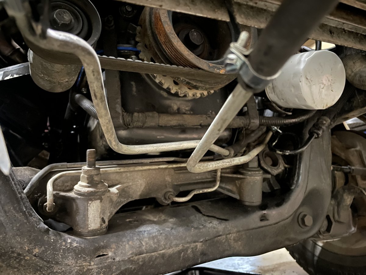

I plumbed the old trans cooler as the new power steering cooler. I made some simple
Metal lines from old trans lines
Finally time to add fluids starting with brake fluid
Brake master was “bench bled” in the truck. Very light and small pushes on the pedal until no more air

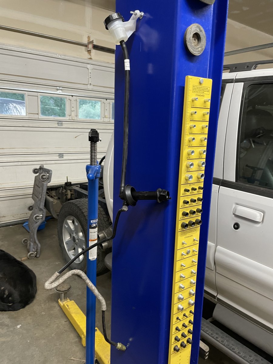

Finally ended the night by assembling the new clutch master cyl and hydraulic line and bench bleeding the assembly
I put this screw on my lift post to hang things from, works perfectly for this
I see something similar on your lift post that I have on mine, I/we have strong magnets that were "harvested" from dead microwave ovens to stick things to the post. We have them stuck to other things too. Tool lockers, one under the hood of something to stick bolts to.

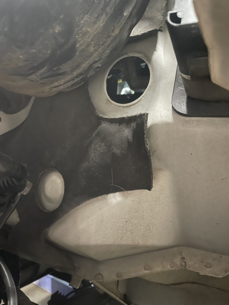

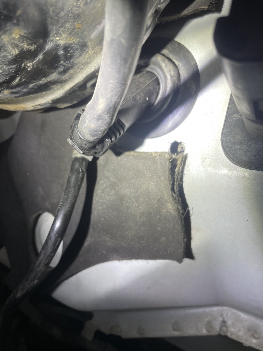

Clutch master goes where the shift cable used to reside

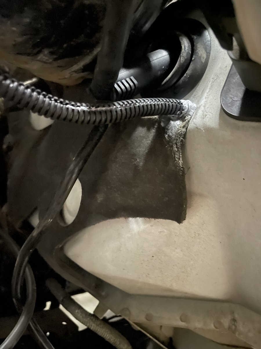

No place to run wires!
Drilled hole added grommet and wires filled w silicon

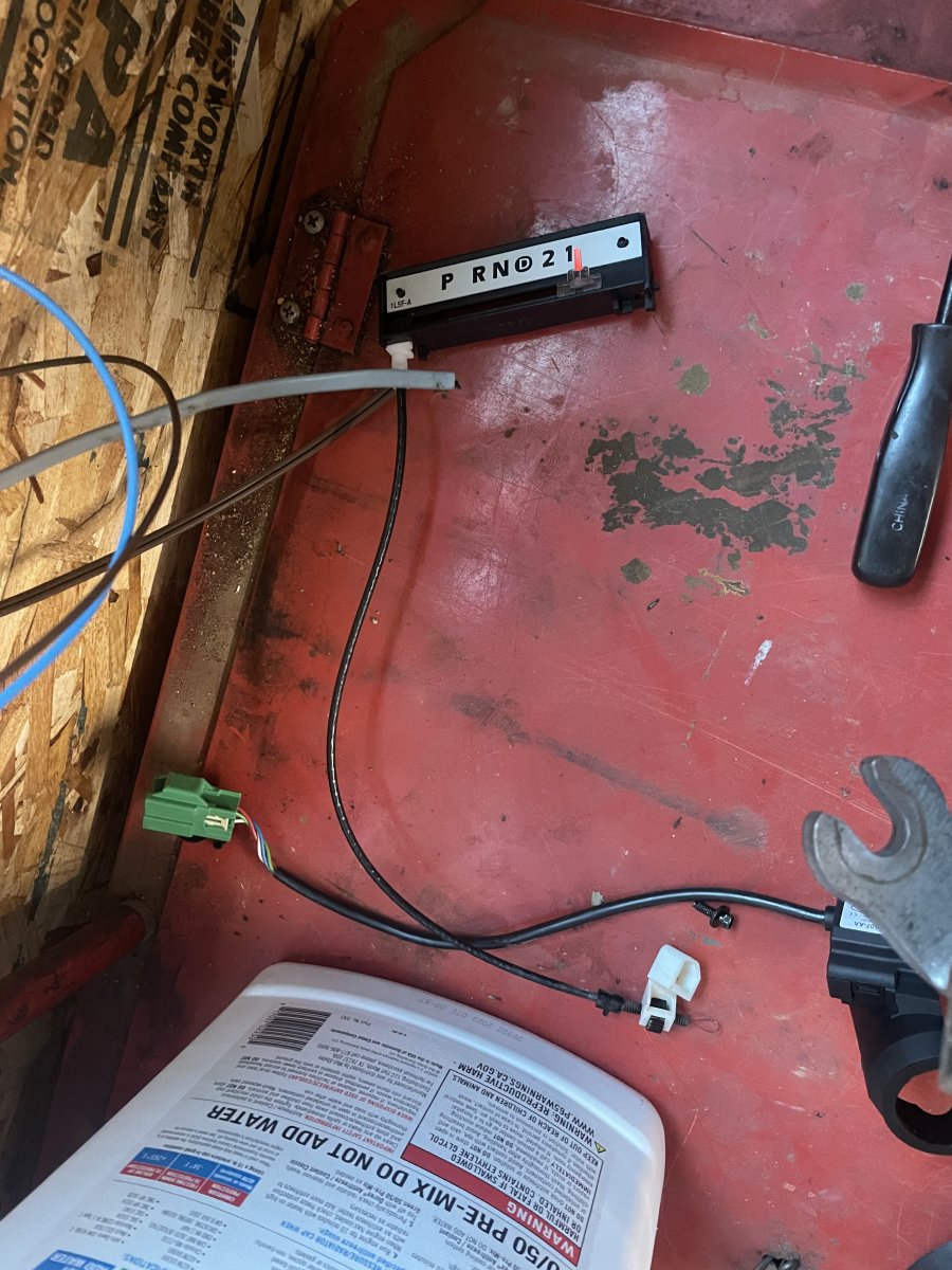

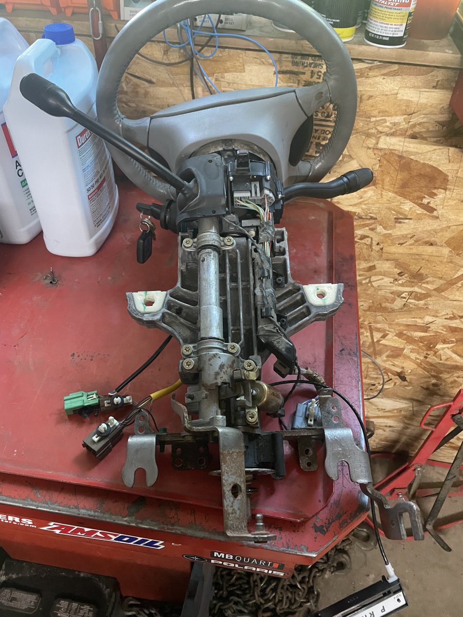

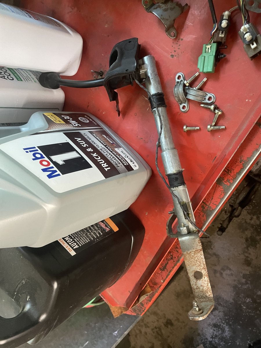

Now time to mod the steering column
Deleted the column shifter, brake interlock, od button, pats halo, and cruise control buttons

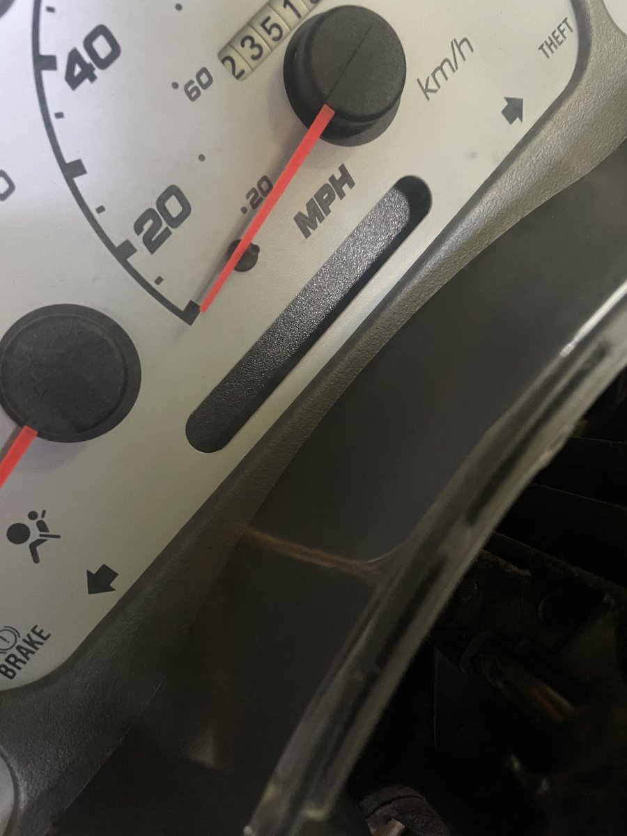

Instrument cluster had two mods, the tachometer wire ground feed was moved from the v6 location to the v8
A blank was installed in place of the gear indicator

Guess who’s running!!
Did you just want to get rid of cruise, or is there no good way to keep the ECU happy running cruise after you've had the auto trans functionality deleted? I hadn't thought that far in my swap planning, but I'd really like to keep cruise when I do my 5.0/M5R2 swap.
Should be no problem to keep cruise. We just don’t use it especially on this truck so I removed it. Speed control is independent of engine and transmission controls
