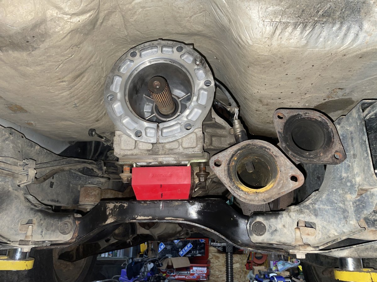

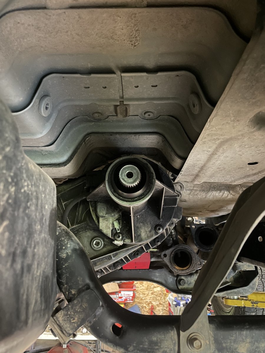

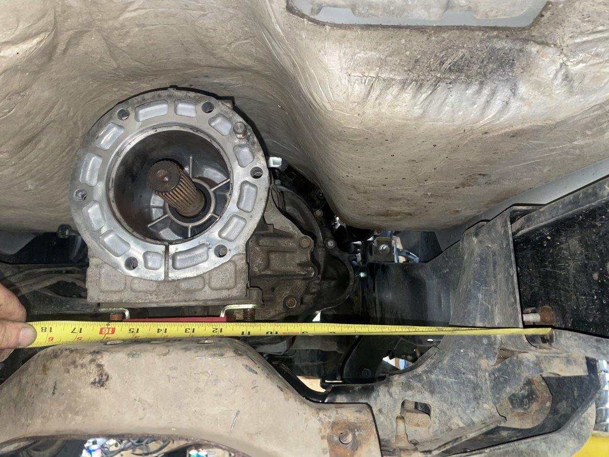

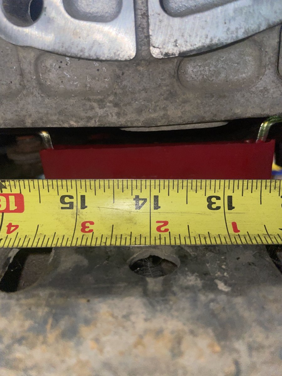

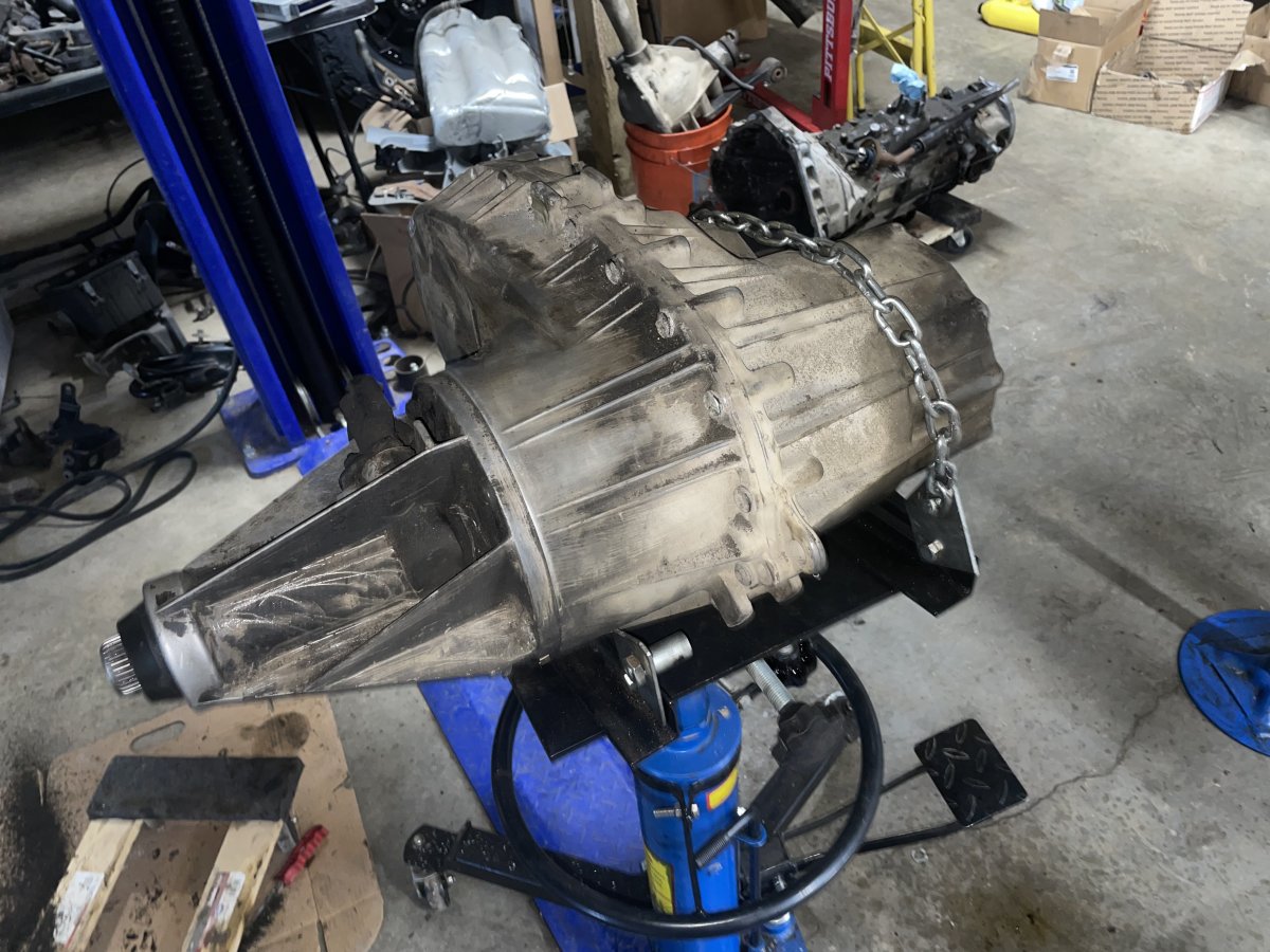

Downpipes starter and t case are in, trans mount and crossmember have been modded

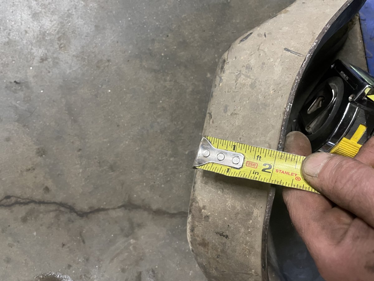

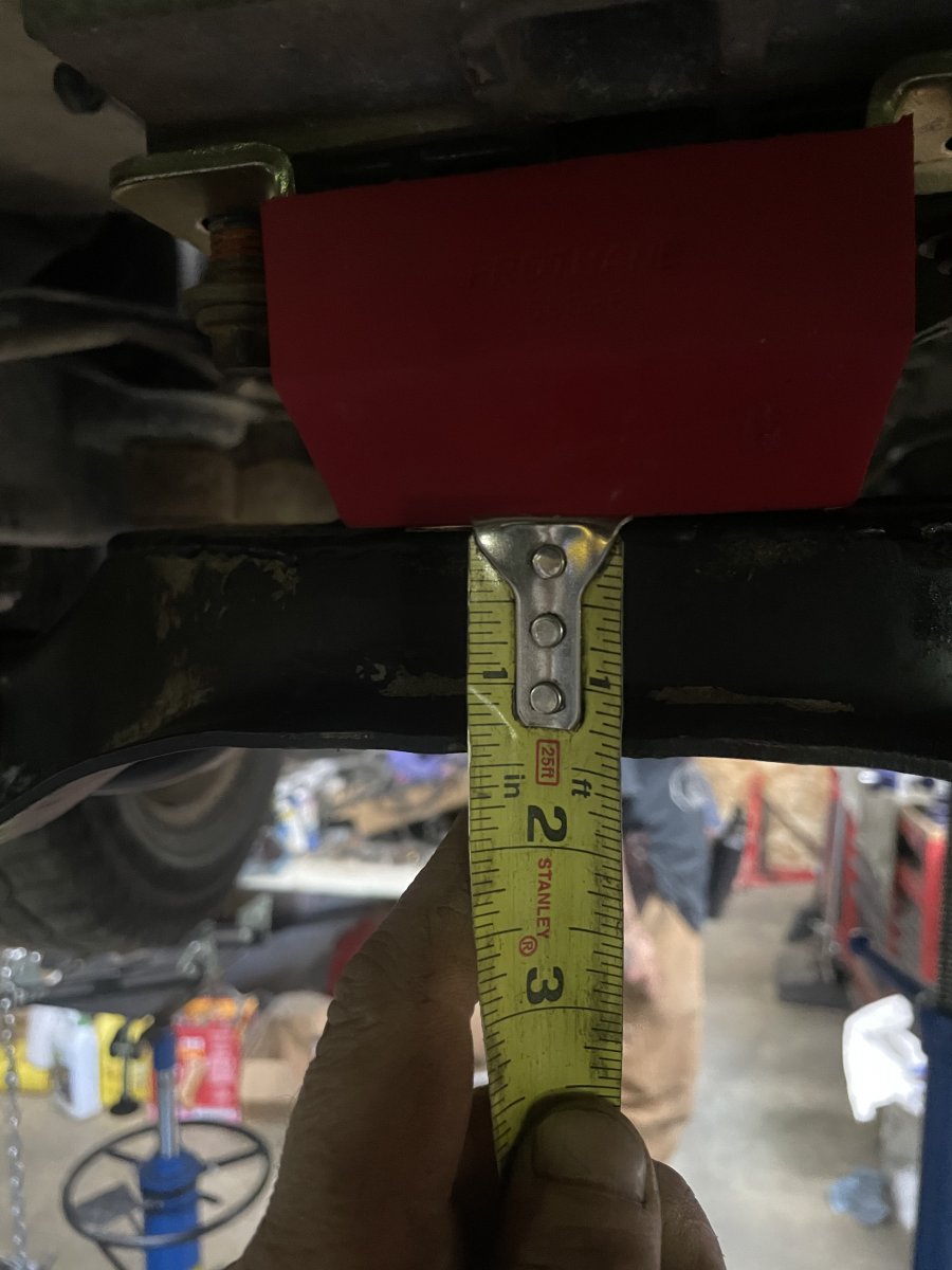

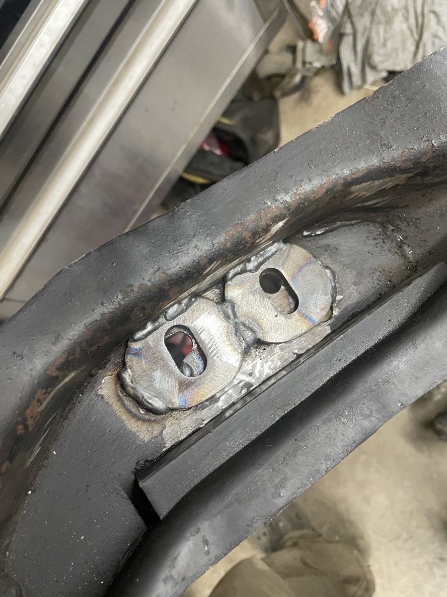

The crossmember was dropped a bit in an effort to clear this “hump” in the 5’speed
This modded crossmember measures 1-3/8”
Height the stock crossmember is
2-1/8” so 3/4” of an inch was removed
The stock crossmember puts the center of the trans mount exactly 14”’from the inside of the passenger frame rail
I set my mount at 13-7/8”

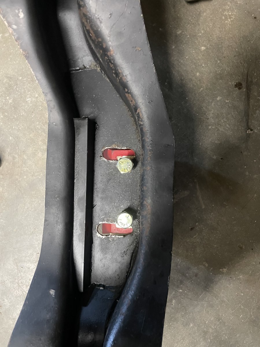

Marked it and drilled some holes

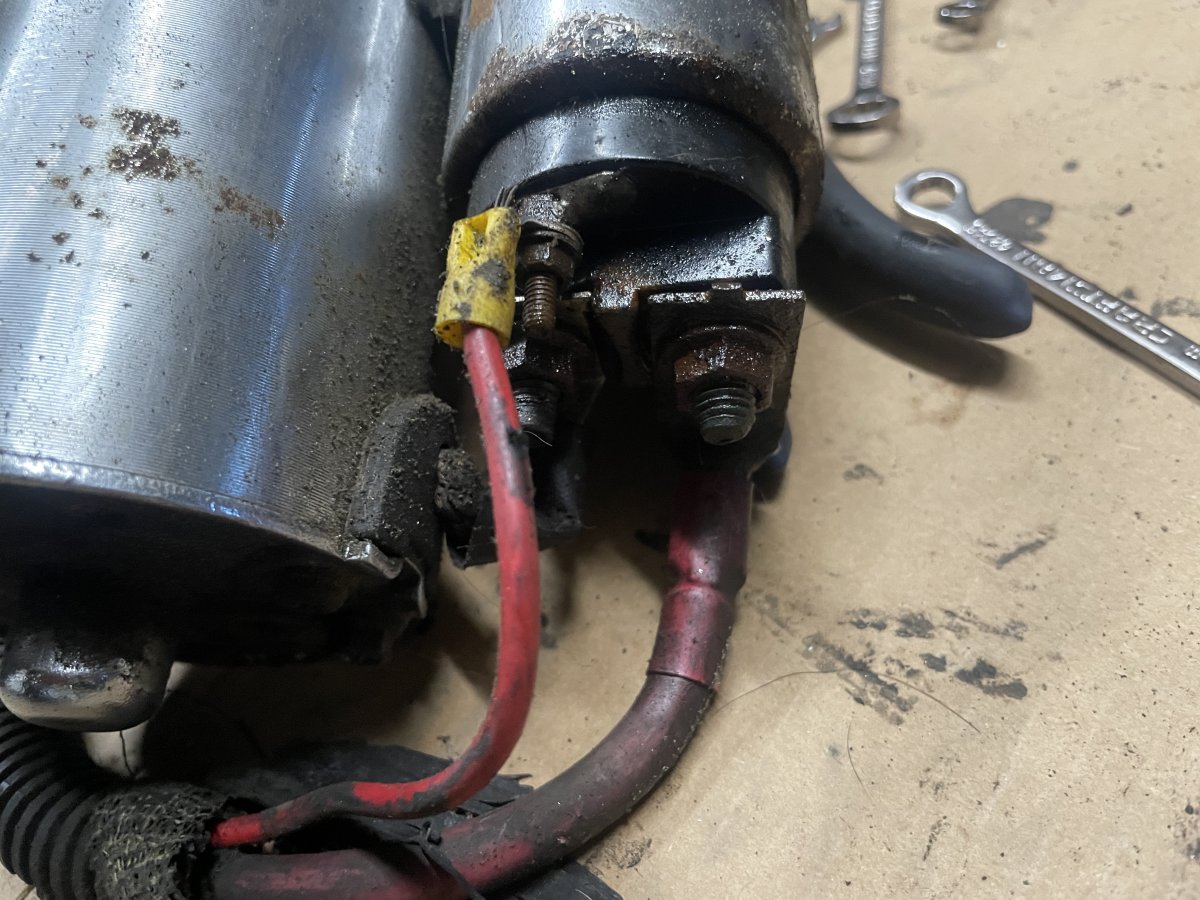

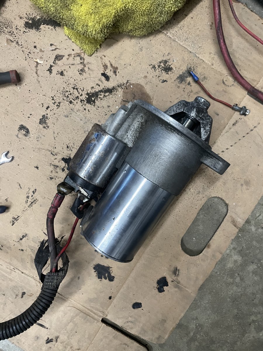

Starter was cleaned up a little and the small red ignition wire was fitted with new ring adapter
Spent an hour or so finding two good starter bolts?!!!?!! I mean I just took the black truck apart like 2 weeks ago set all the bolts in one box and still this happens hahahaha fun fun
Starter went in

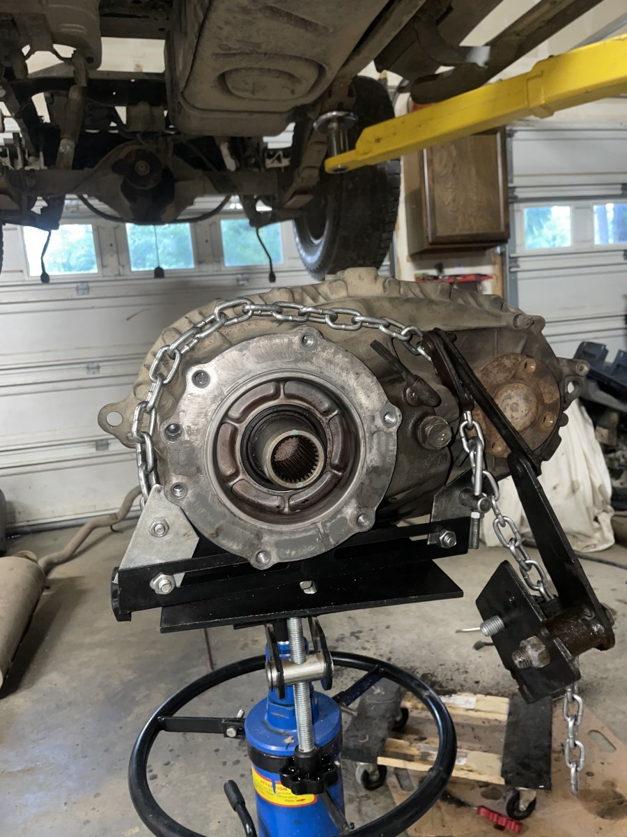

Then the t case was prepped and installed w new gasket

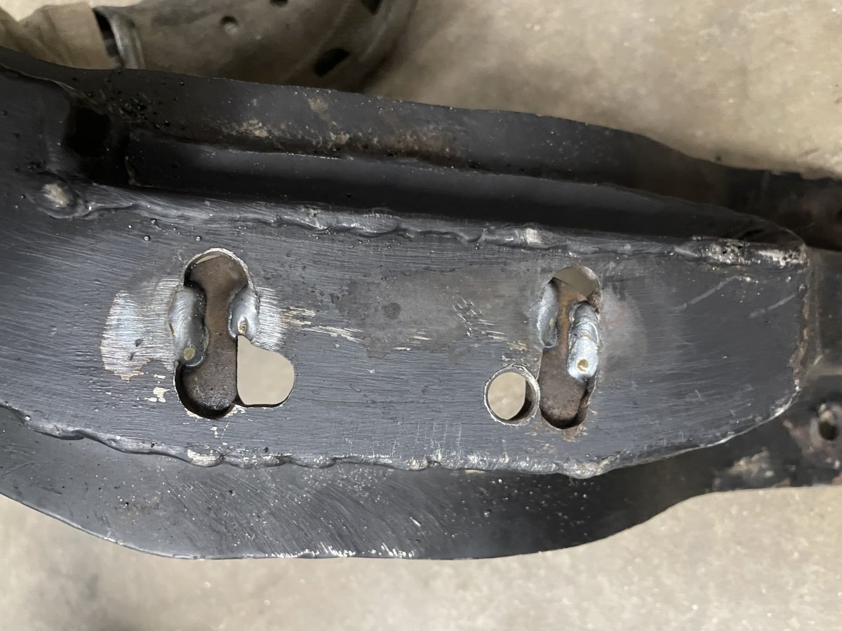

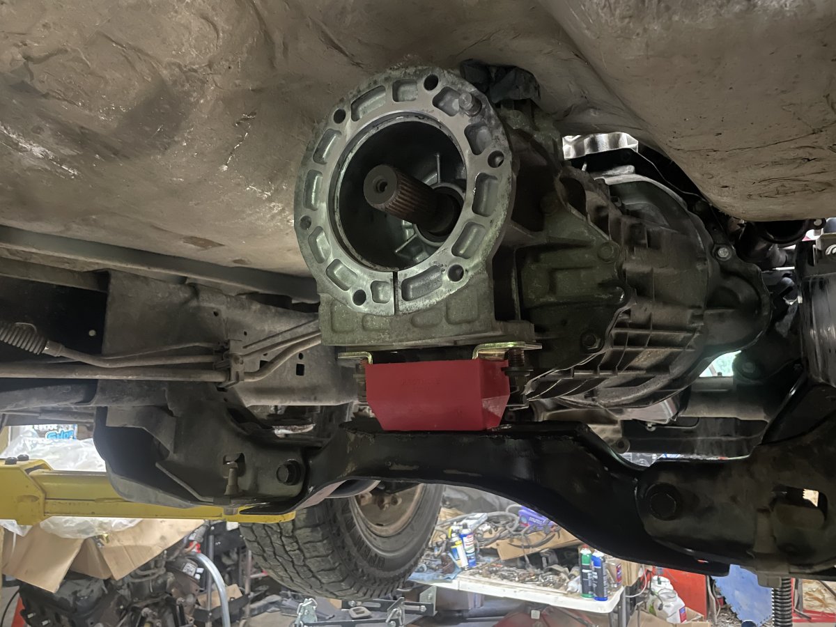

Holes drilled. I love steppes bits. Took quite a bit with a file to get the holes perfect. Welded on some body mount washers to solidify things
Then painted and installed
Final position for the transfer case
First look at the t case shift linkage

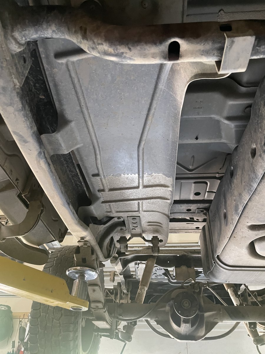

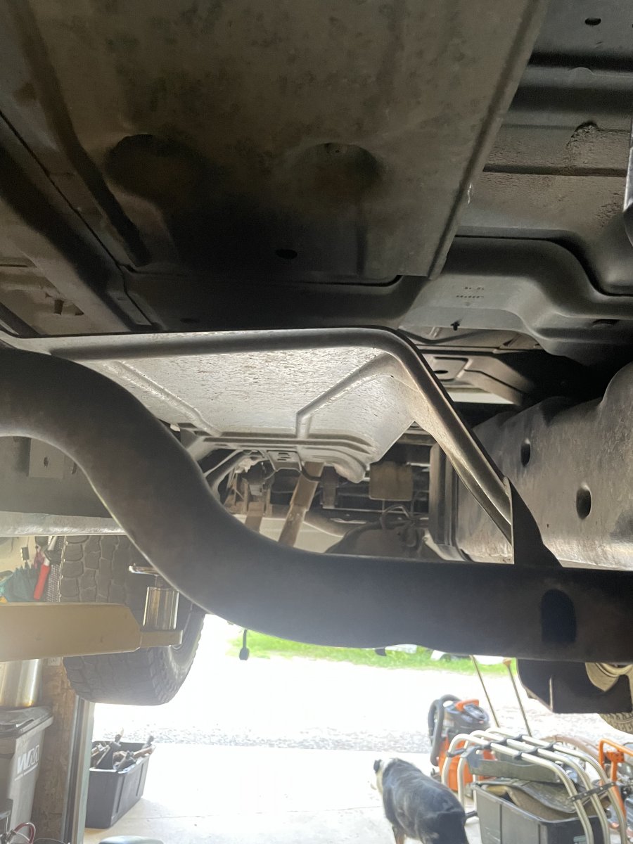

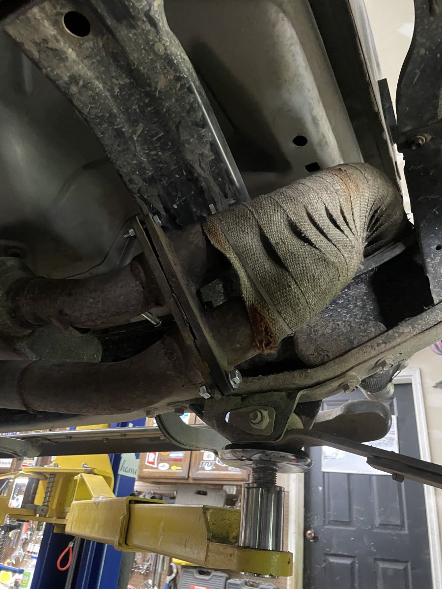

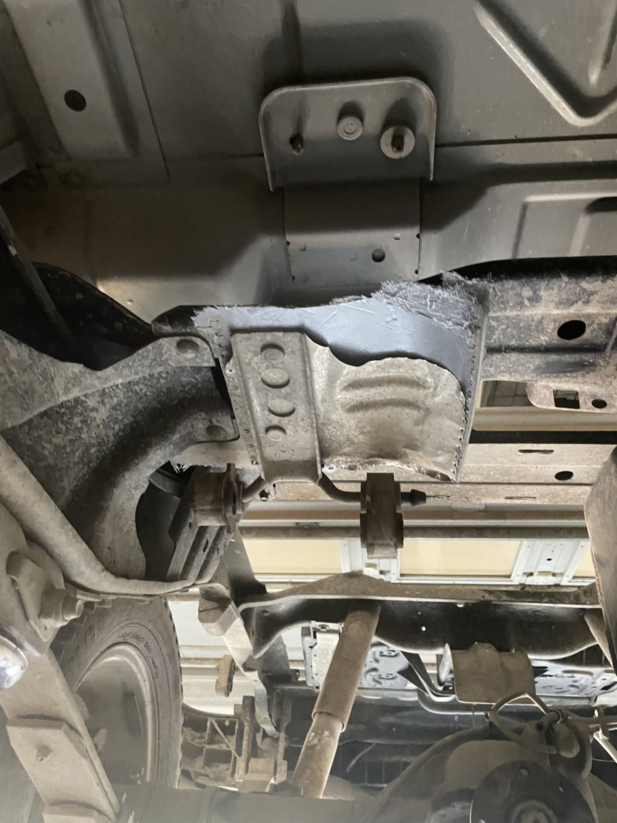

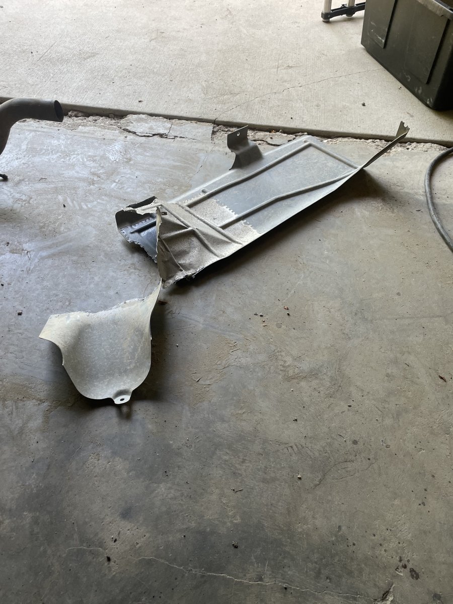

Now this lame fiberglass exhaust shield has to go to make room for our custom duals
Unbolted and then taken out
Then had to cut the rivets to remove the stock exhaust hanger assembly

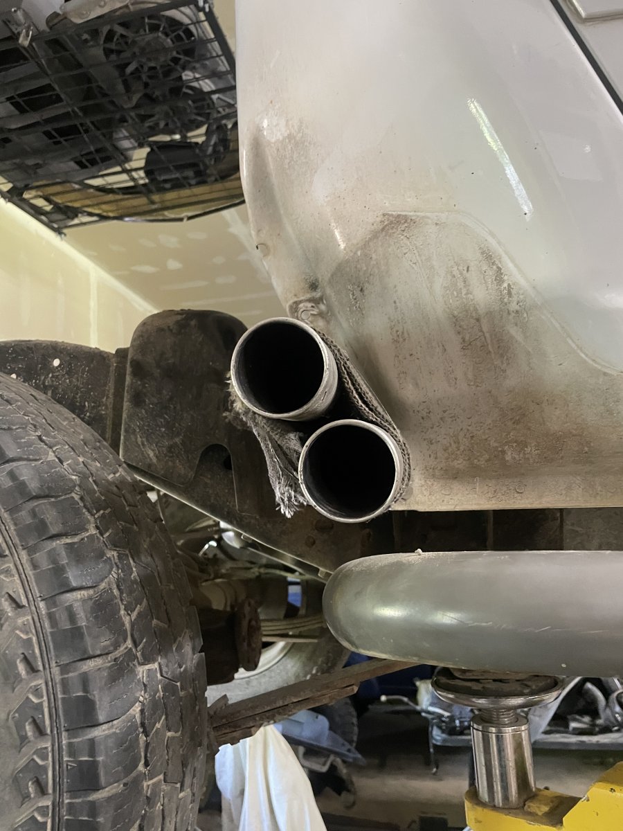

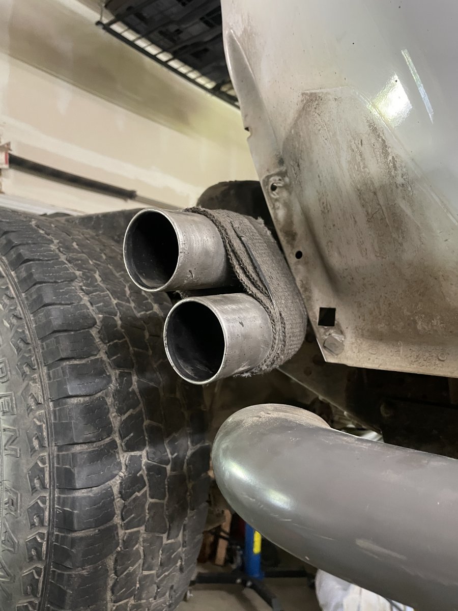

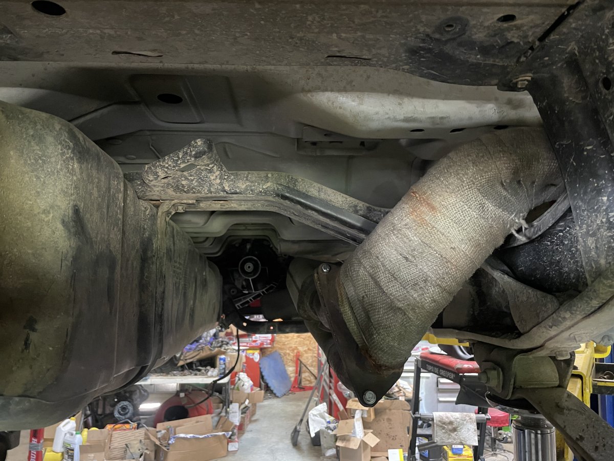

Shotgun exhaust is in and two exhaust hangers welded in place
Tight fit!!!
This system was built from a 96/97 explorer setup so I ordered some new exhaust gaskets I left things a little loose so when the gaskets get here I can slide them in
True duals with a small crossover, I love it! The 2” body lift is necessary for the side exit to fit

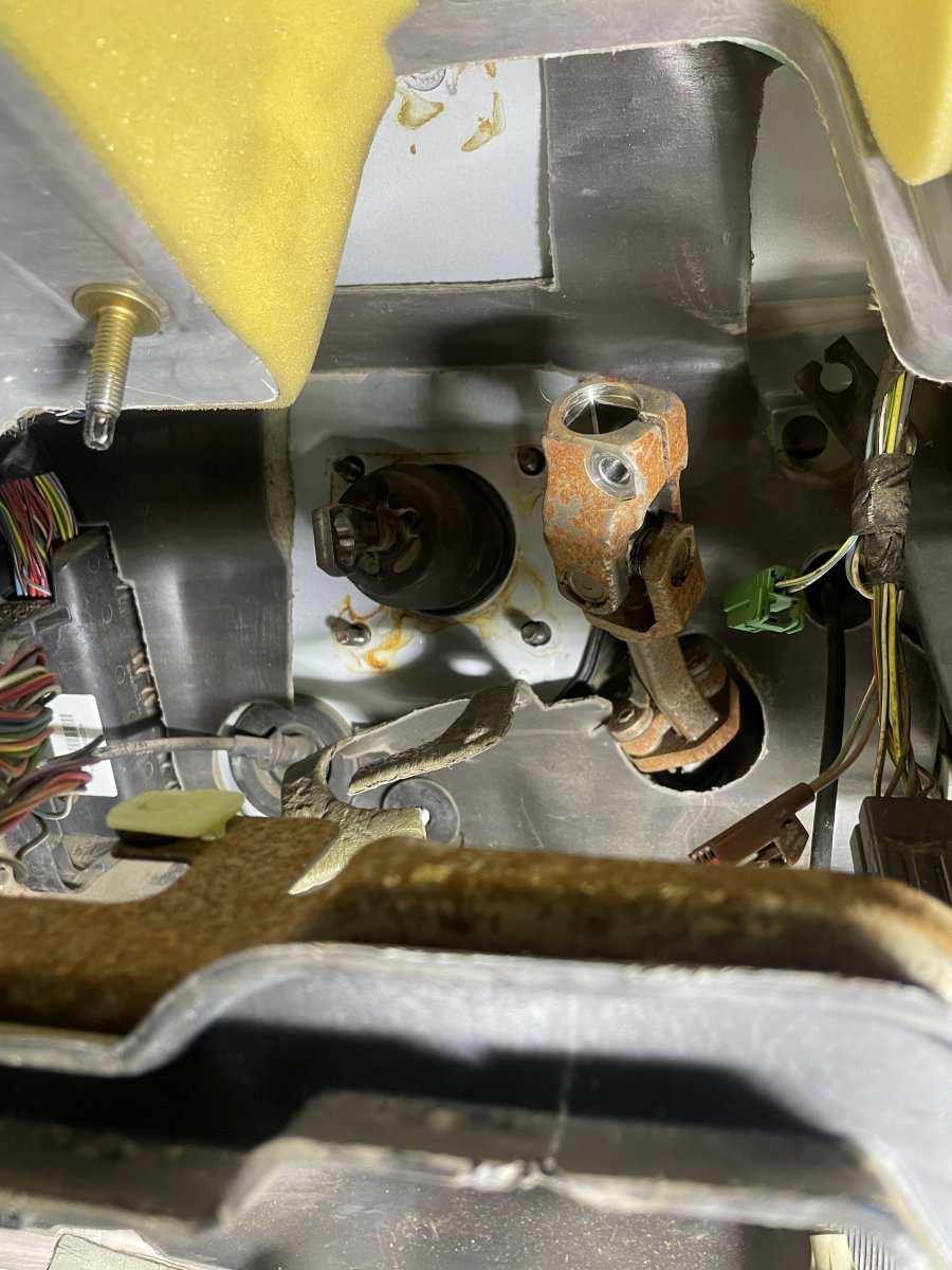

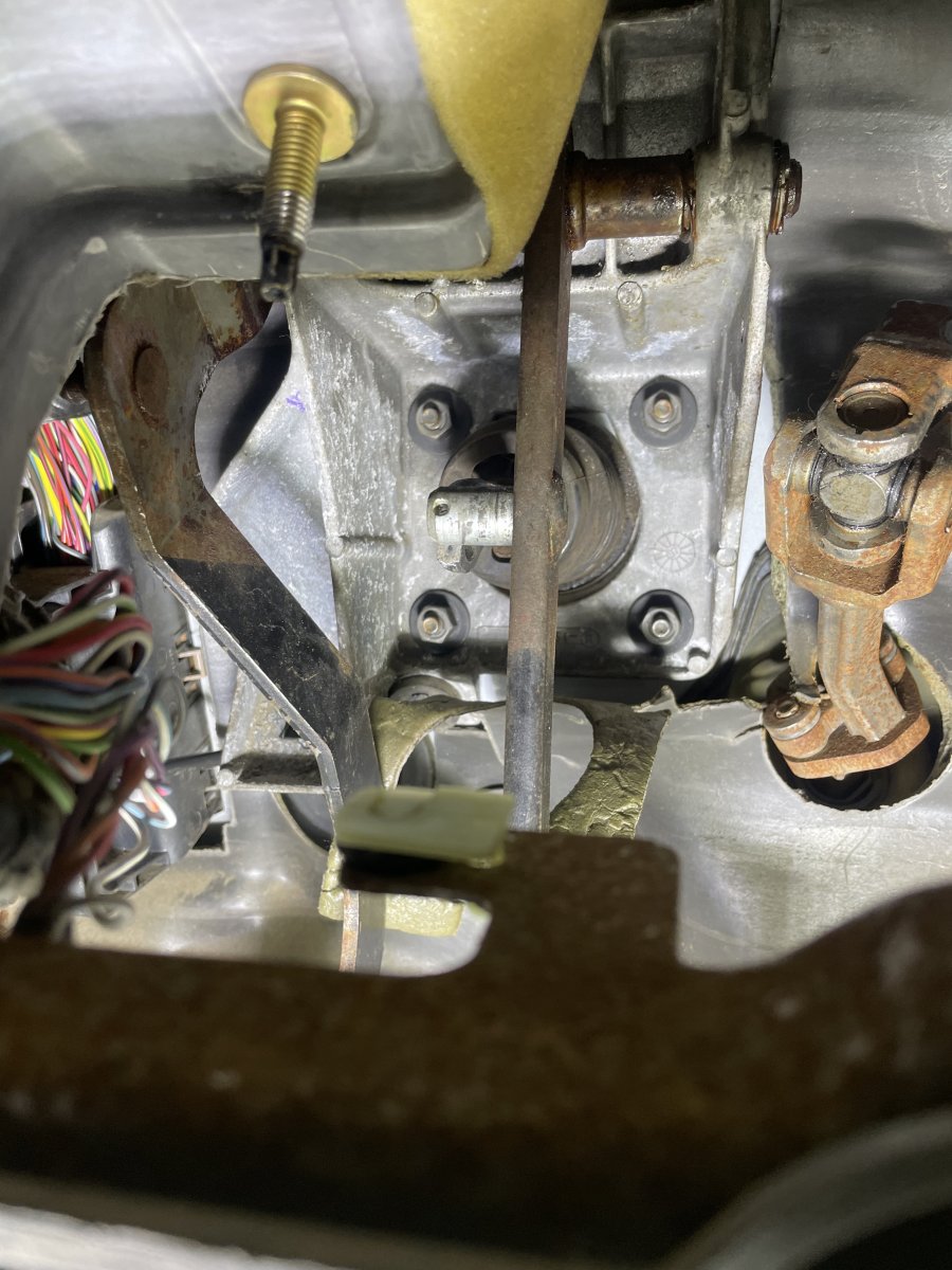

Next the truck was lowered and time to install the new pedal assembly …..
Goes here
In!!

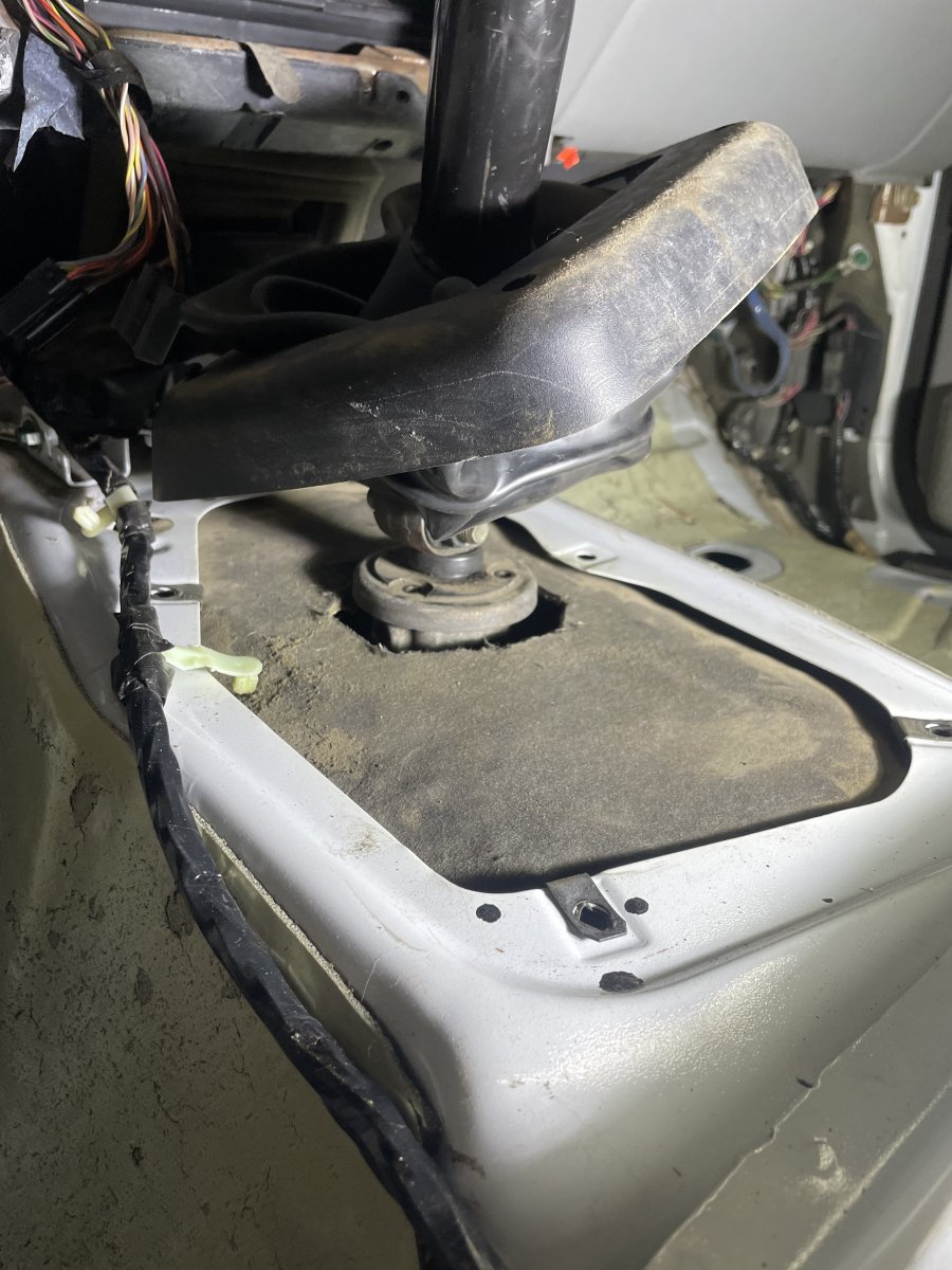

Column shifter cable was then removed, this is where the new clutch master cyl will go

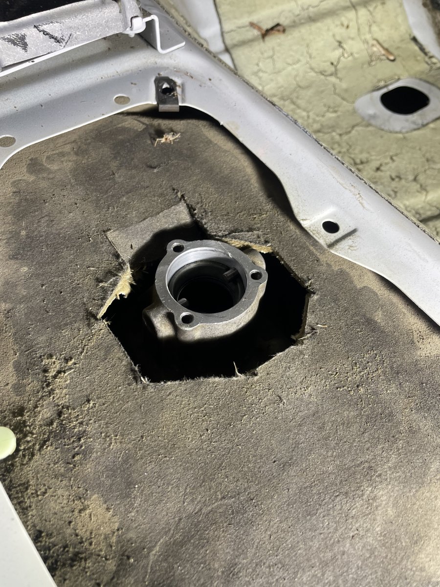

Finally cut hole for the shifter
5 speed sport trac!!!

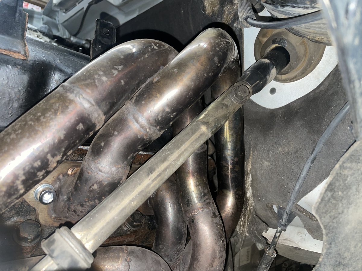

Steering shaft to header clearance is good w the 2” body lift

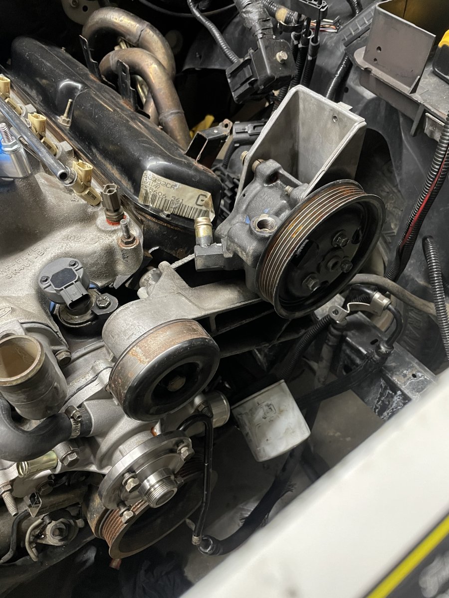

Next I turned my attention to the engine bay

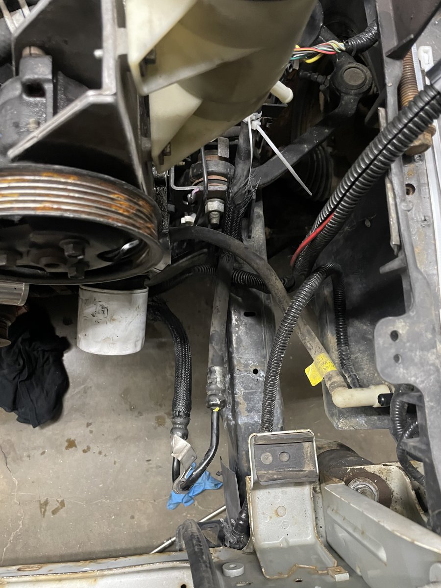

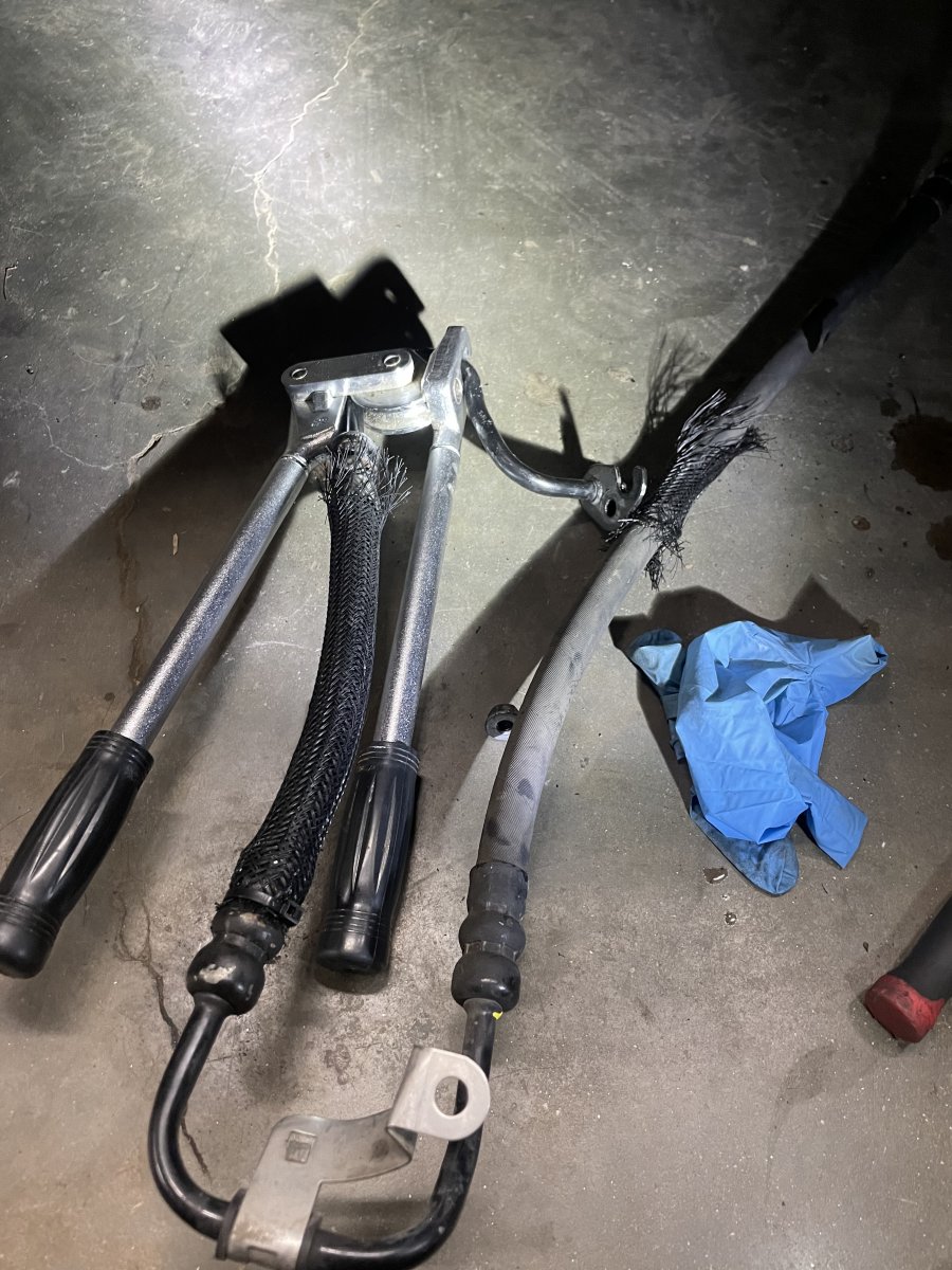

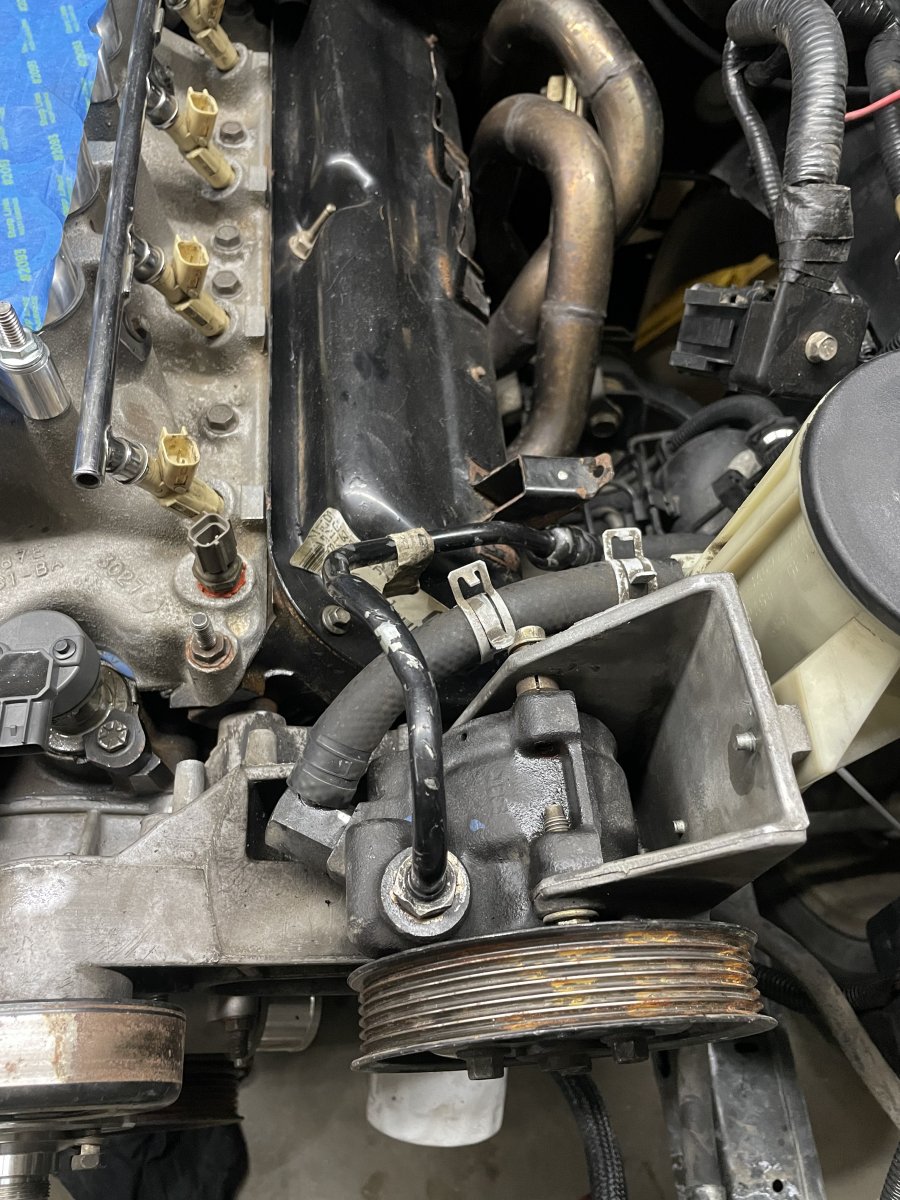

The 4.6 power steering line needs to be heavily bent into shape in order to work with our 2003 rack and the 5.0 pump
I have this handy tubing bender
Complete u turn
Driver’s accessory bracket cleaned and mounted so I can plumb the steering high pressure line
Many small
Bends until it rotates completely around (was facing up) And threads in. Have to be sure to clear ac compressor and ac line
You can see the new routing for this 4.0 gen iii explorer factory line

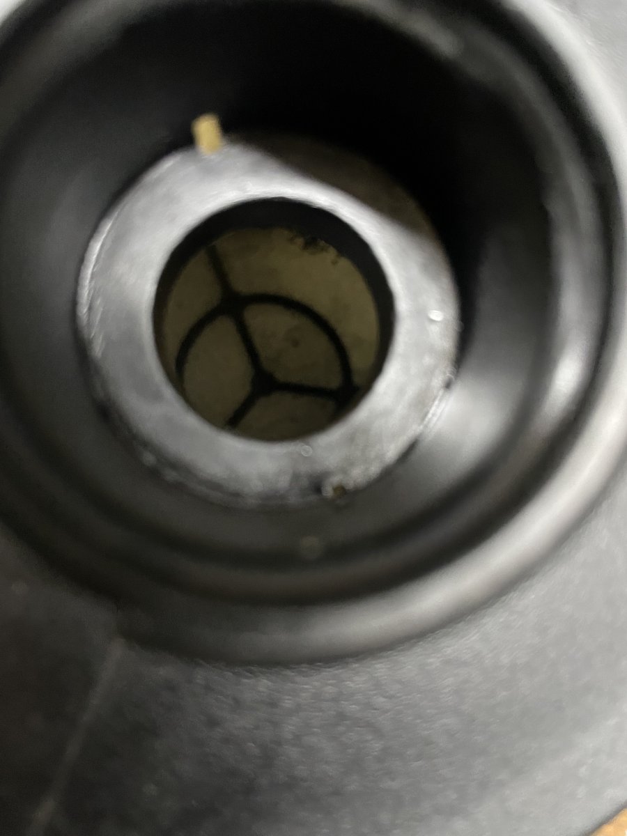

Power steering reservoir was cleaned with carb cleaner there is a screen in there

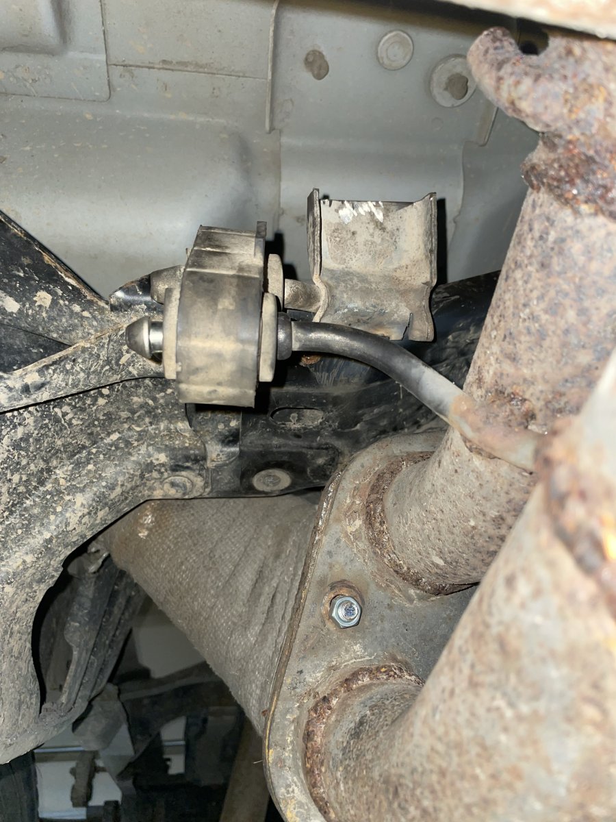

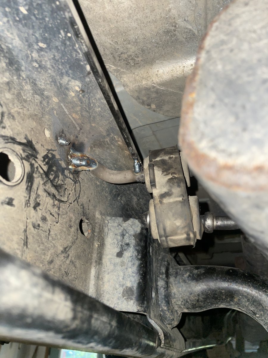

Where is the front sway bar, gone for good? The oil filter has to be short due to that bar, if you have it out of the way, you might hunt a full size quart filter(if they make a metric version).

no sway bars on this truck
You would have some fun up here!
having time to actually drive the rigs is the goal!
this one will be a daily driver....our road is much better with no sway bars
ifs should be independent
I could get away with a rear sway bar, it would make the front work harder, depending on how much towing and hauling this track does, the rear one may go back on
I prefer a wide stance, good springs and good shocks and then I remove all the factory band aides like sway bars, anti vibe weights, and go from there. I am a big fan of simplify and lighten, less moving parts, less mass (strip weight where you can)
With stiff body mounts, stiff drivetrain mounts and a good soft suspension these trucks can be alot more fun to drive (big wide tires/stance help with grip)
I find it puts you more in touch with the vehicle and the road, make that suspension work

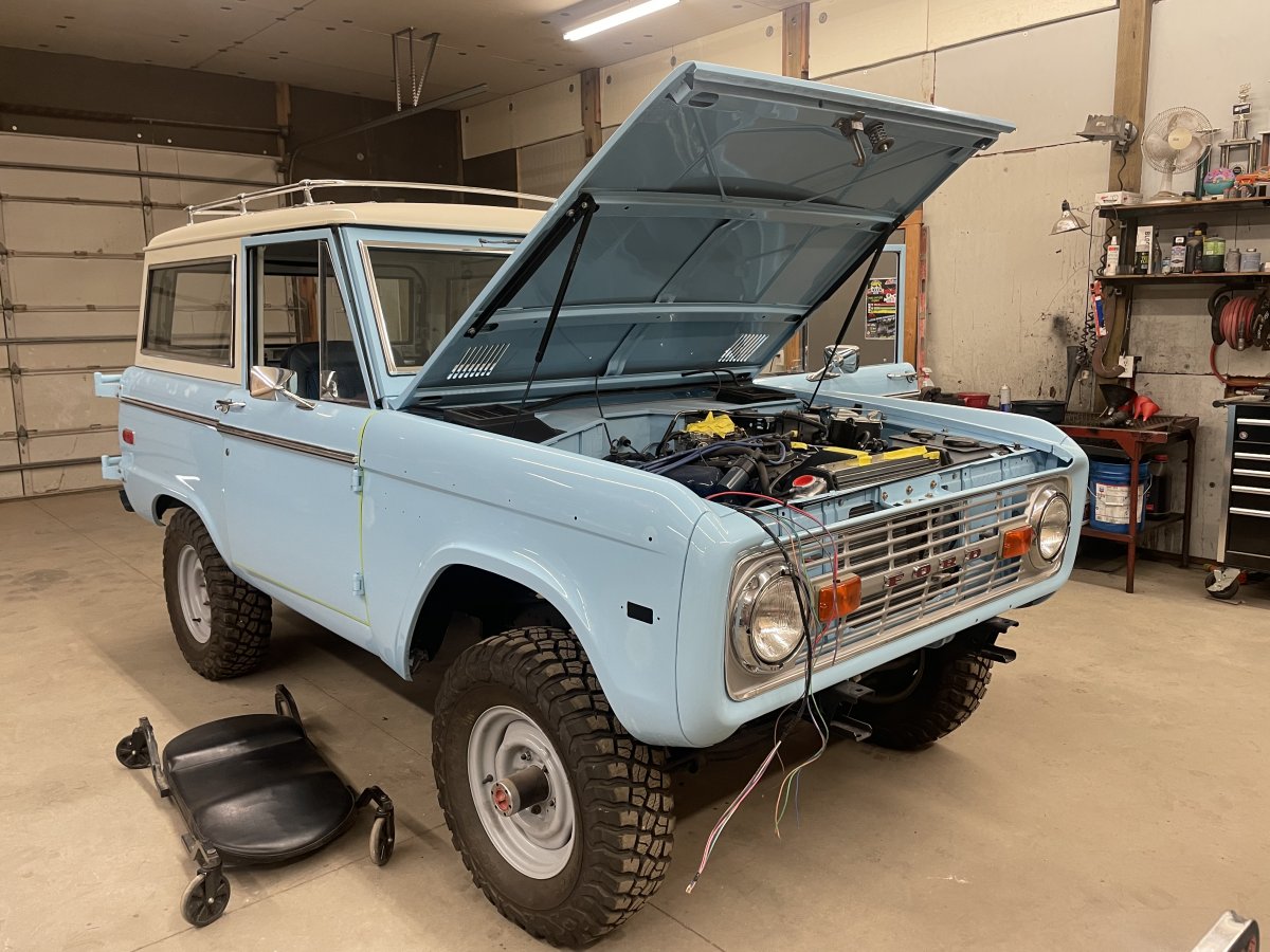

Installing an American auto wire update kit in this 1975 beauty, they called the right dude for some wiring help!

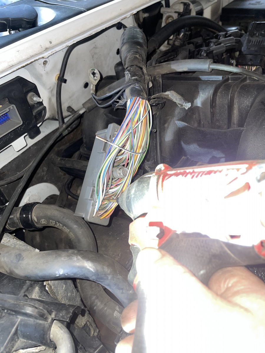

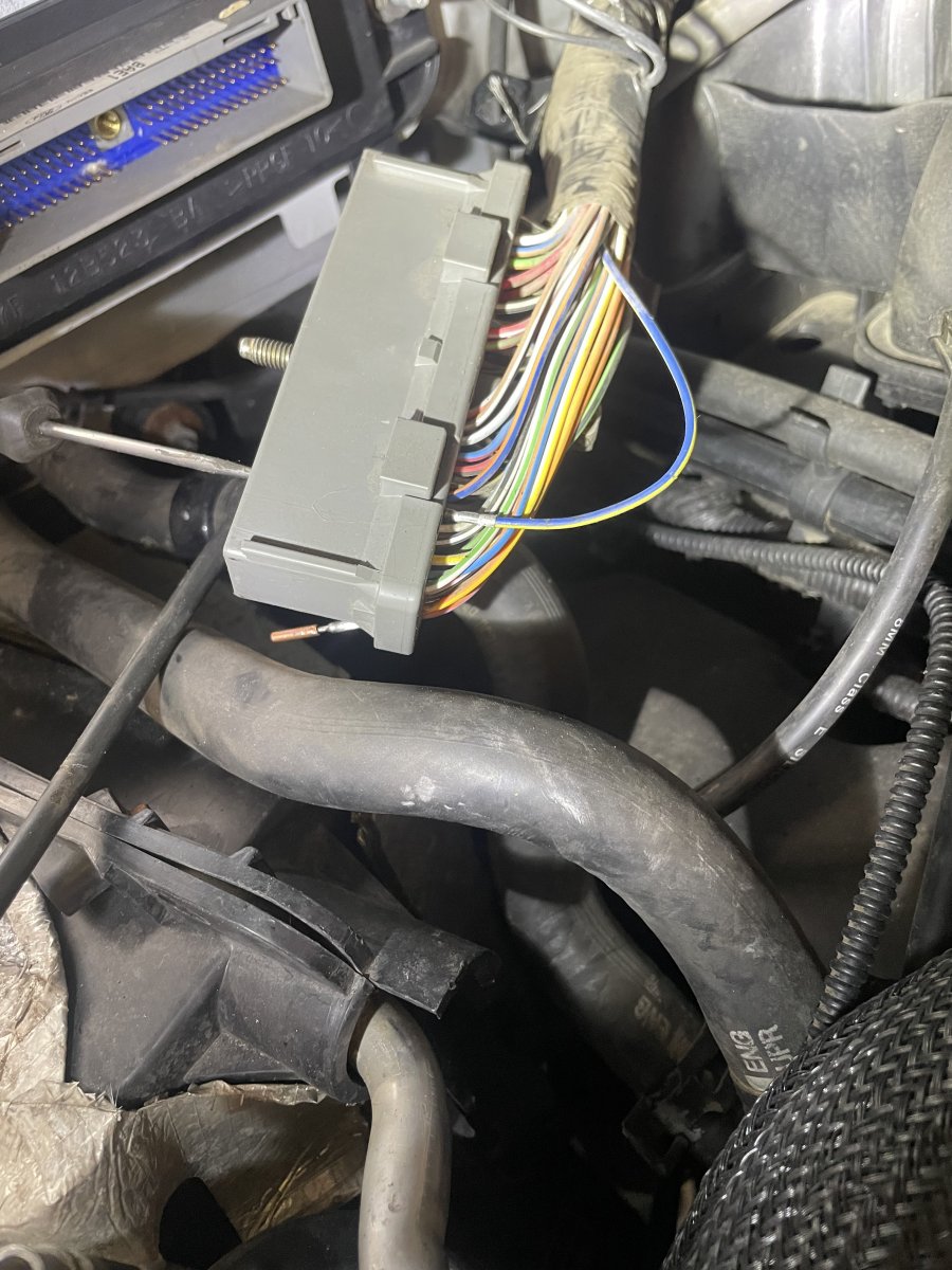

the fliptrac we built, the 2001 white truck with the 2005 sohc engine (2000 explorer pcm) and 2007 ranger transmission using a 2003 sport trac wiring harness and accessories = can of worms.
Our 01 truck is a JOB1 early production sport trac, which means the truck wiring is like a 2000 explorer. The wiring harness I used is from a 03, or JOB2 trac....many changes to the wiring! I had to relocate 3 wires at the PCM and add a speed sensor wire from the abs control module to the C115 connector......and I still have 02 sensors not switching.
at least that gets rid of the trans codes and the p0500 speed sensor code. the odd thing is they show a 4th oxygen sensor on the books for a 2001/02 trac and then it went away in 2003? these sohc engines never had a 4th 02 sensor?? stupid!!!!!!!!!!!
Its okay............... I'm getting it wiring at 9 pm at night and now at 6 am the next day, I'm outside in my sweat pants and no socks checking to see if a wire exists... once you get deep into a project like this hard to shut brain off. I'm carrying around 2000 Explorer, 2001 sport trac and 2002 sport trac wire books like they are my life blood
poor buddy already bought this truck from us, then driving it developed limp mode and 8 codes......... I'm fixing it now
