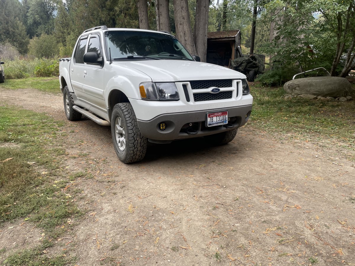

The 03 is making a wicked daily!

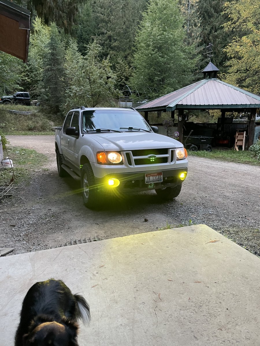

I tinted front windows

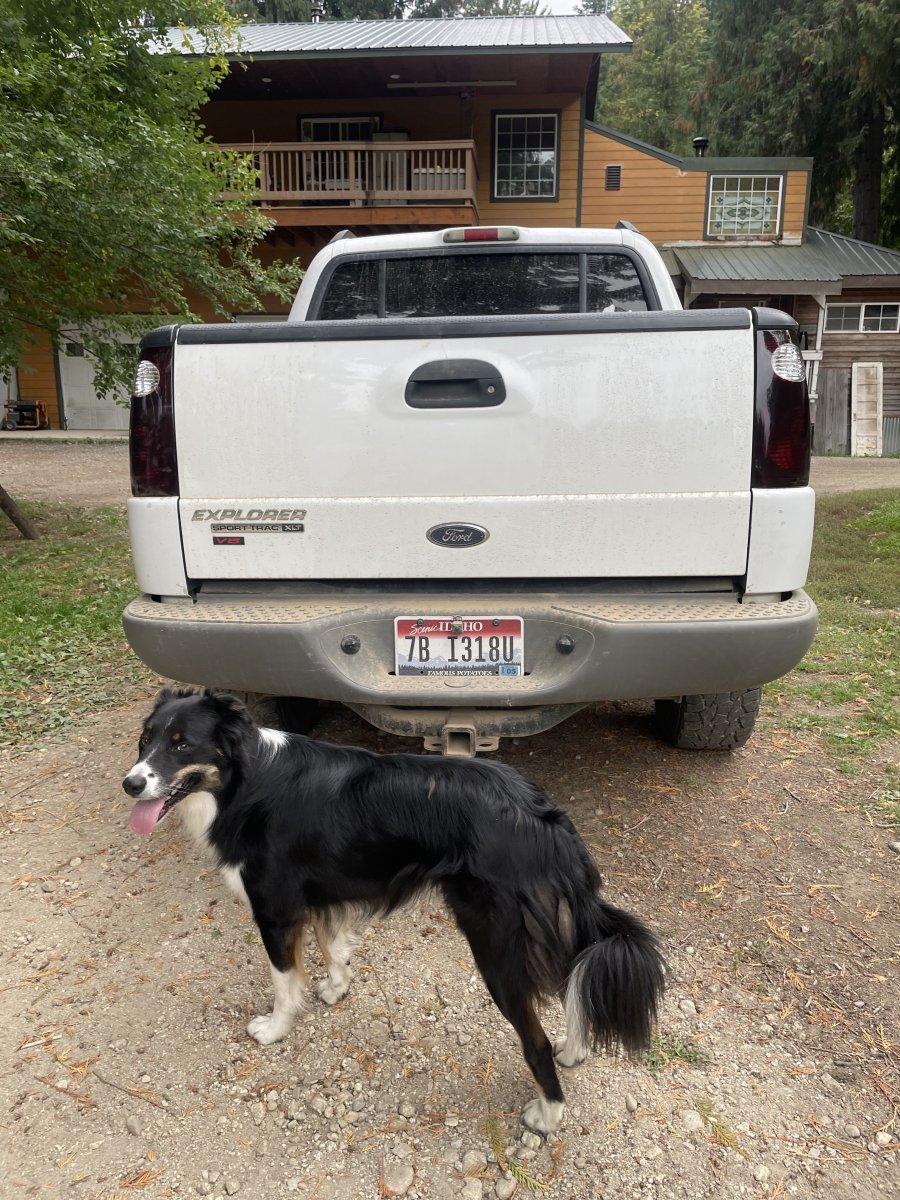

Added headlights corner lights and tail lights ;)
Changed the oil once already, I drive it every morning she drives it every day
