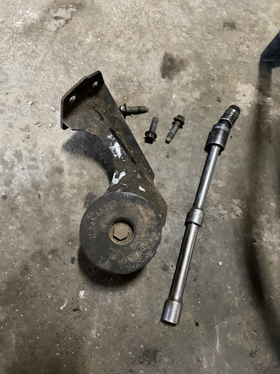

Stupid sohc starter access!!! Also the stupid huge weight they installed on the sport trac front diff mount sucks ass

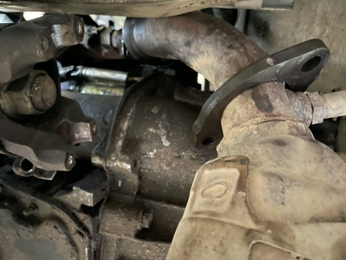

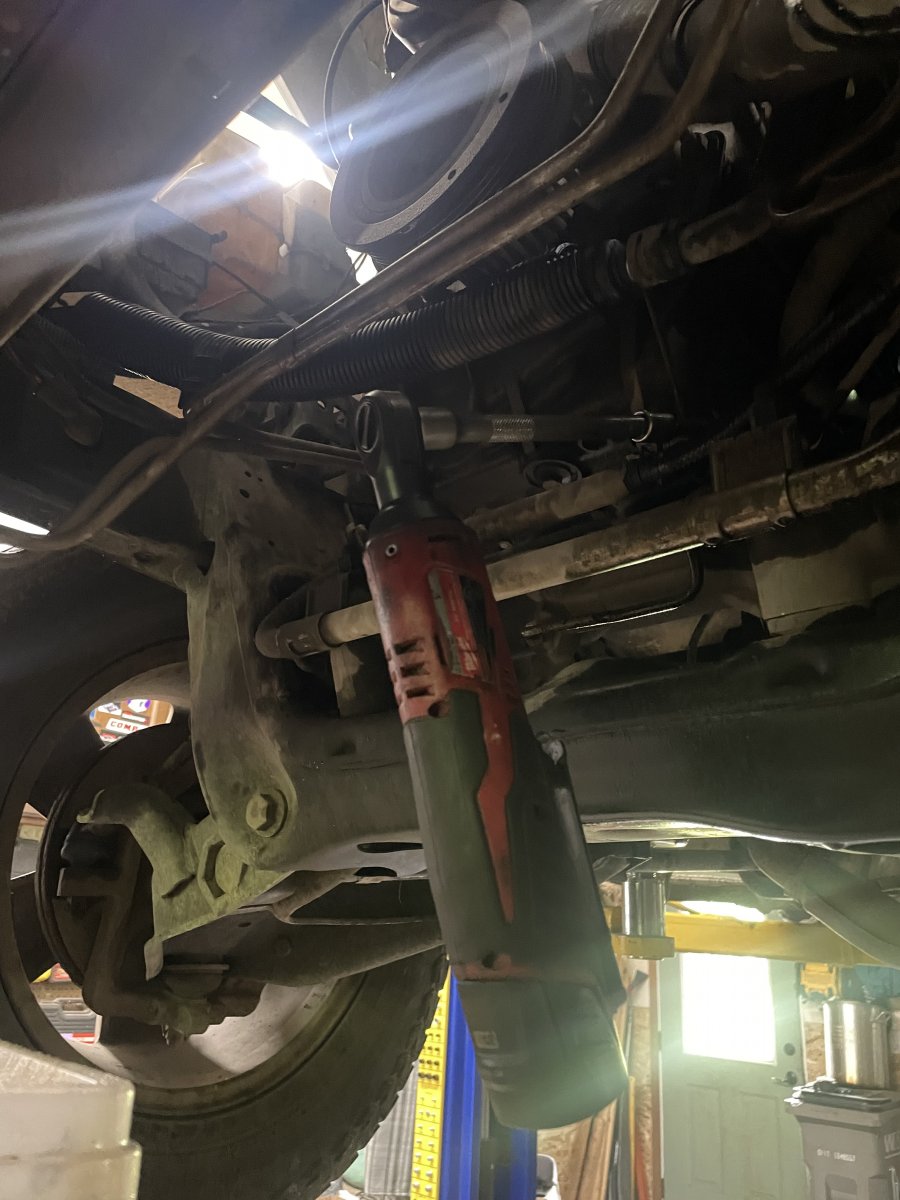

Real pita to remove this sucker
1/2” drive with wobbly gets access
Bolts fight all the way out
Makes getting at the starter easier, then finally the torque converter nuts
When I was turning the engine over by hand to get the converter nuts water was being pushed out the exhaust and onto my head lol
Access to top starter bolt from up by radiator much easier

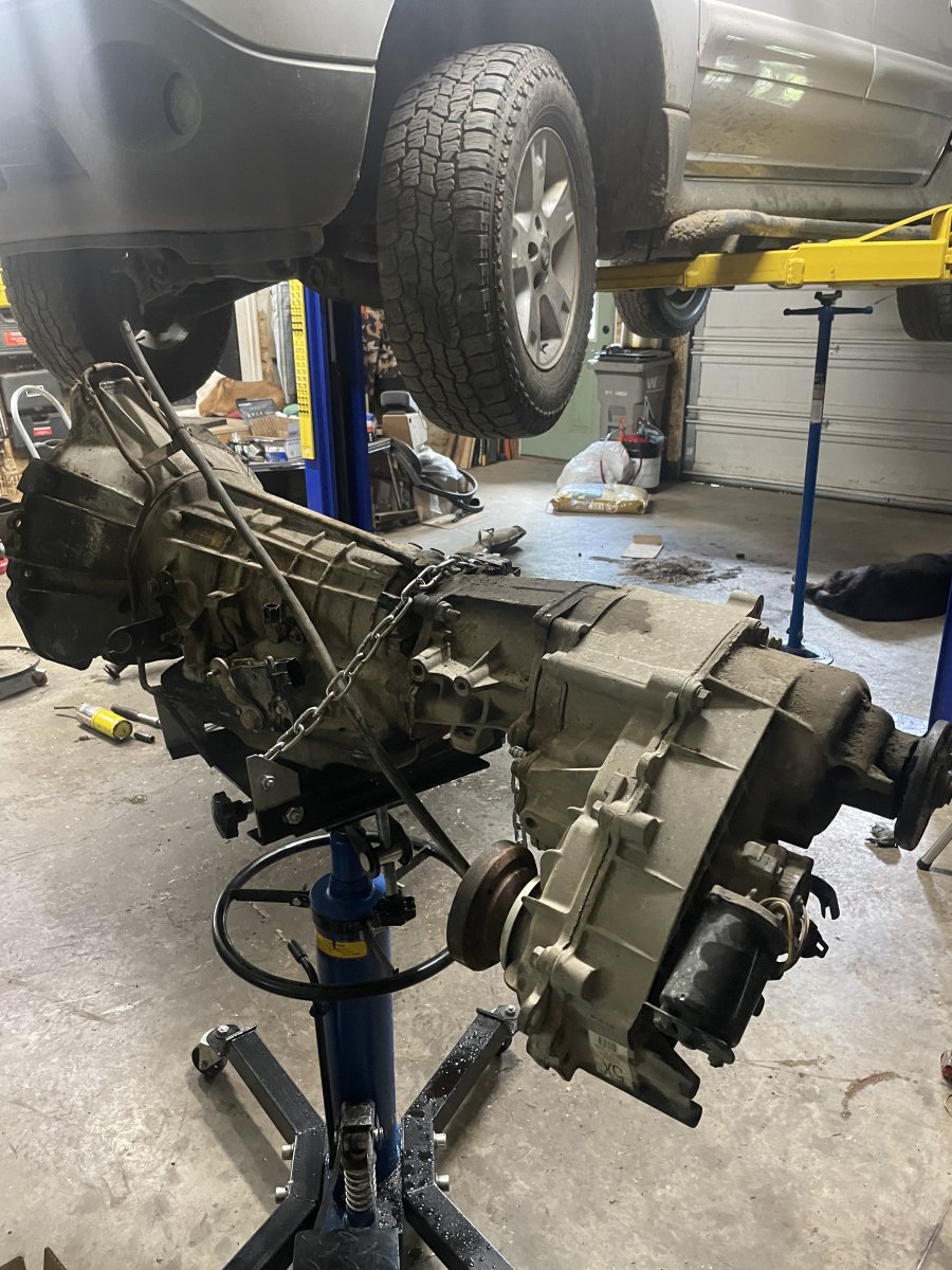

Dropped trans and t case together
Engine was out minutes later
Thanks for the pics! That will help me and others that have to do this task.
Question? Do you think that I can remove the engine and transmission together? Mine is 2wd. The intake bolt situation is blocking the transmission top bellhousing bolts. Otherwise, I have to remove 7 intake bolts and pry the intake until the back ear of the intake breaks off. I'd bet that you have a 2002 4.0 SOHC intake in usable condition if I have to resort to that "savagery".
It is really easy to get the bellhousing bolts with a long extension working from around the side of the trans. This is with the crossmember out and the transmission hanging down
Yes you can get the engine and trans out together if you have to, just make sure the truck is waaaaaay up in the air so you have enough angle to push the back of the trans down. Make sure trans is drained really well, everytime I do that I end up with a bunch of Mercon on the ground… those rwd trans always dump atf out the tail lol lol

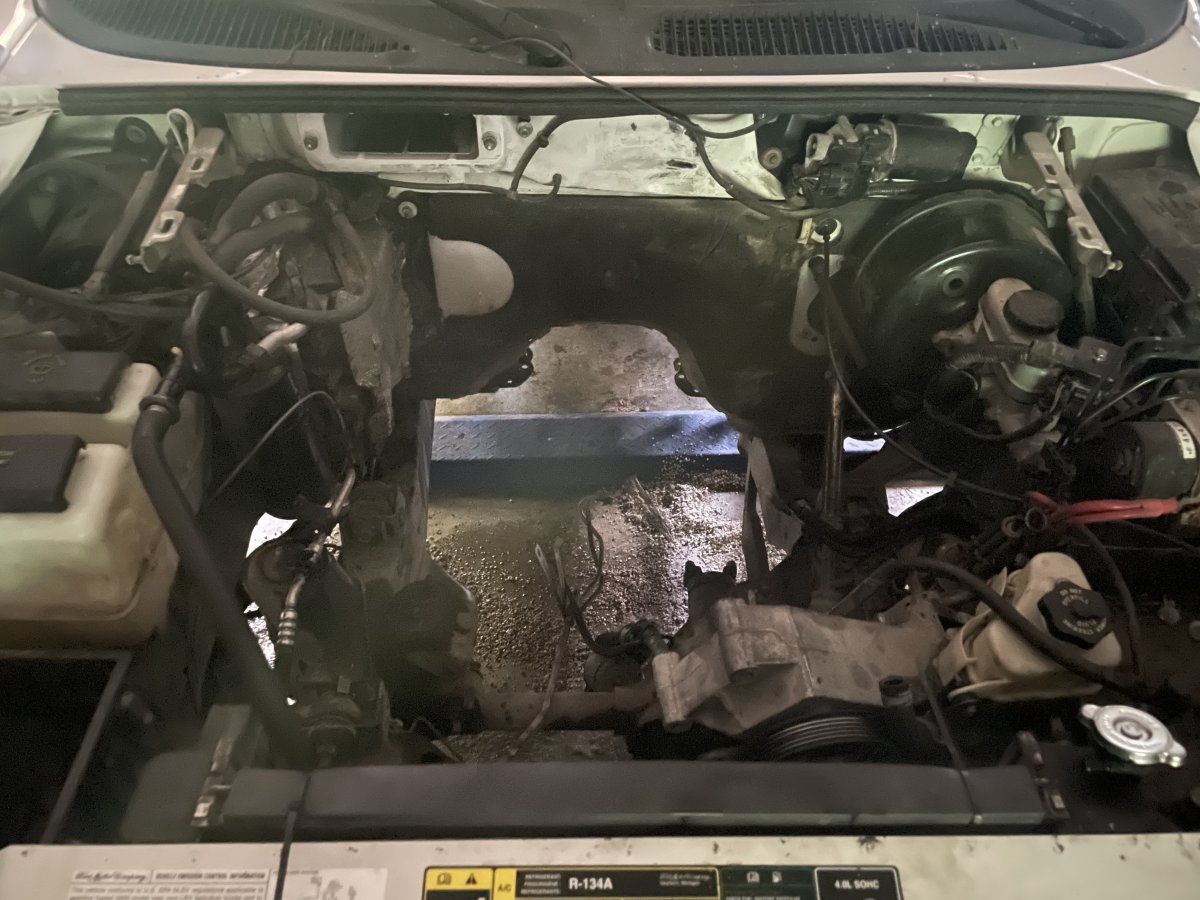

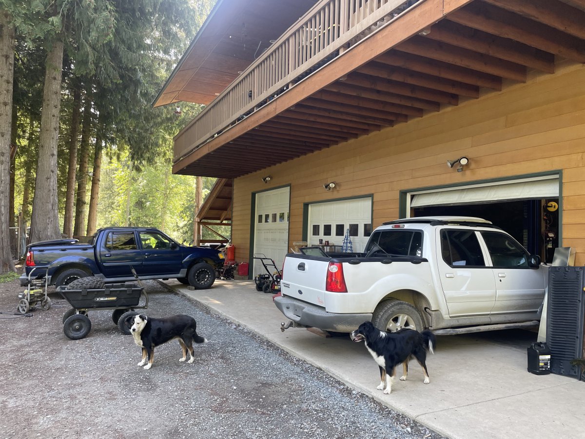

It’s sport trax craziness here right now
There is a blue 05’in bay 3 getting a v8 and superlift right now.
I’m using many of the parts I just removed from the $700 03 so I can put together a 01
For a friend. The 01’is getting a low
Mile sohc engine from a 05 gen iii and a 07 auto trans from a ranger. The parts from 700 engine are already in a new home.
As soon as this 01’is running (like later today) then I can get back on putting a v8 into the 700 truck. In order to do that I need some parts, so the 02 black sport trax will be coming in tomorrow to be dismantled. Stay tuned

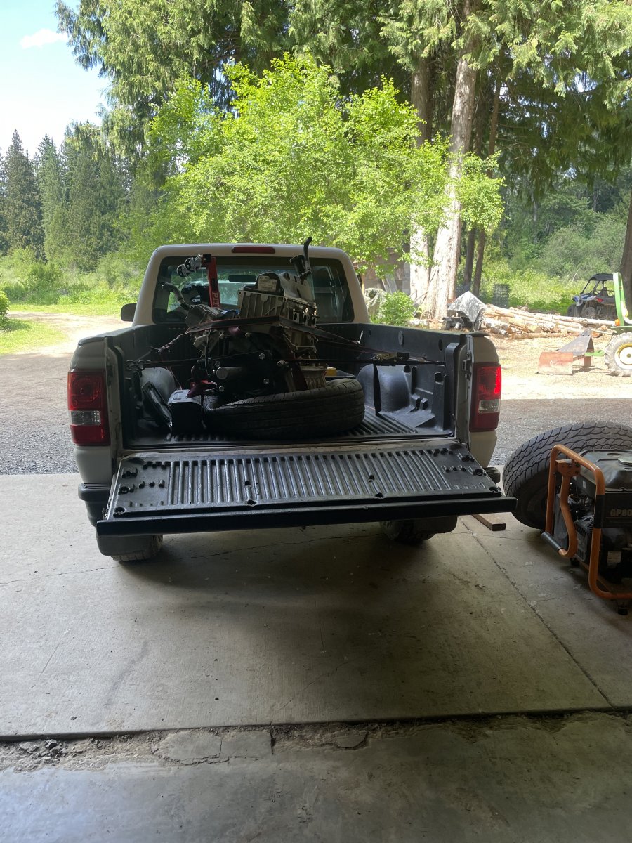

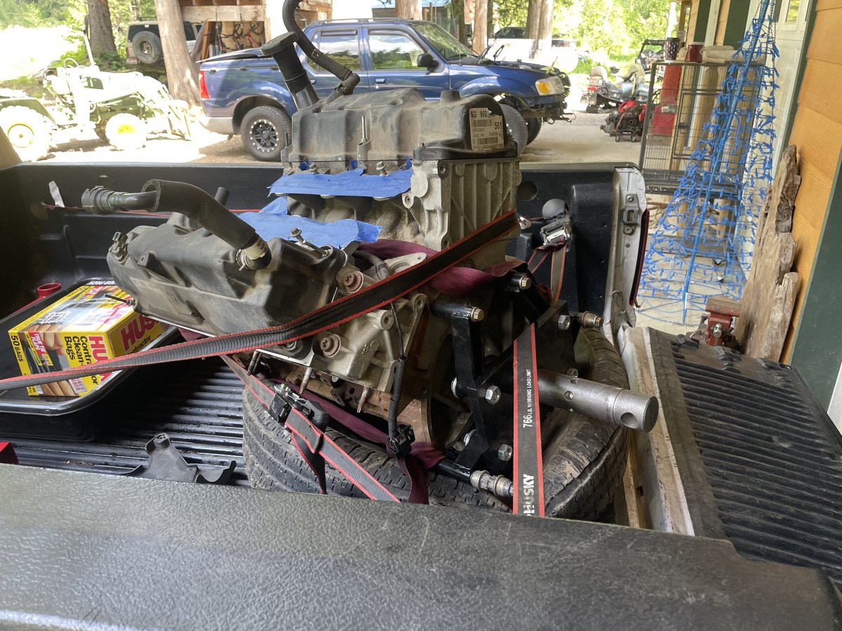

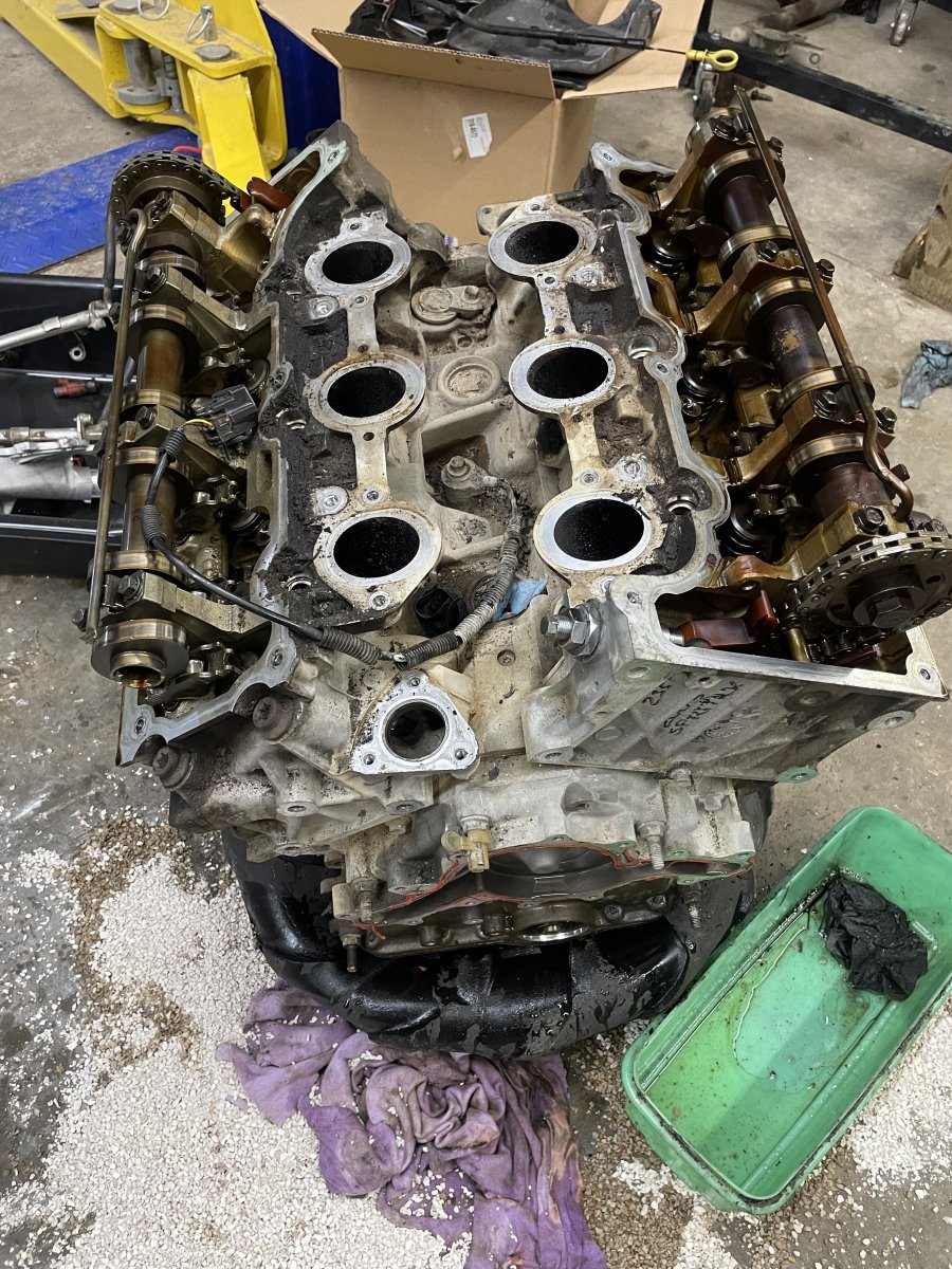

2005 explorer sohc engine 124k basically free. Bought truck for $600 w no reverse crushed it a week later excellent wheels and tires nice seats. Sold cat converters and traded the crush weight for a ranger bed. Now the engine will live on

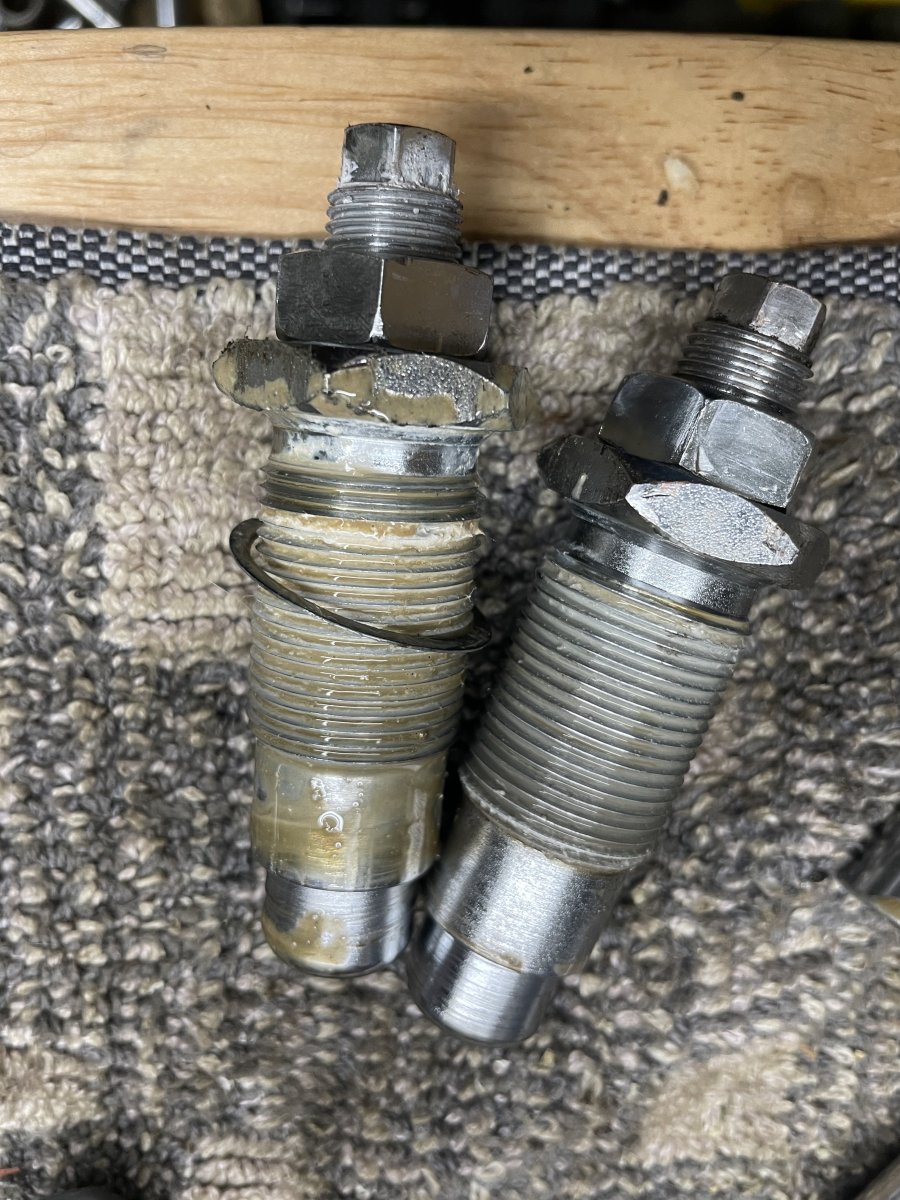

Bad sohc in the right

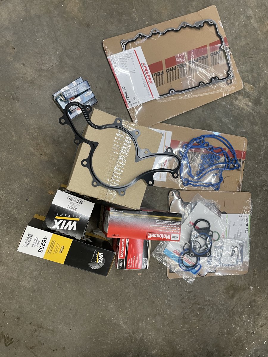

Getting lots of new parts

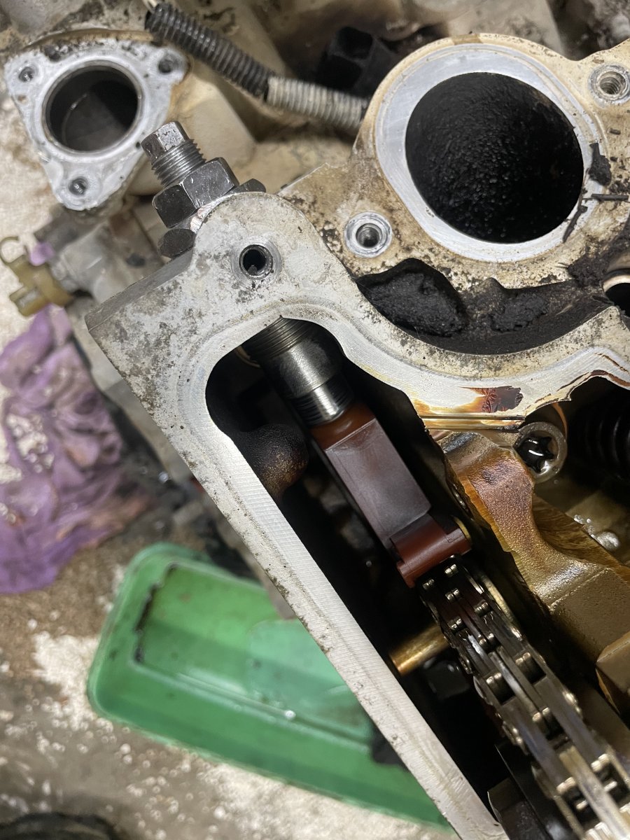

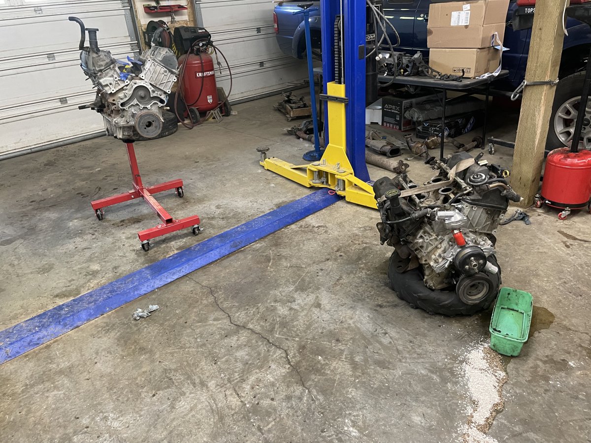

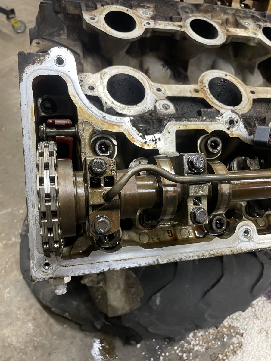

Here’s the bad engine good chance to see the manual tensioners in place
Drivers head milkshake for sure lost head/head gasket
Nasty
Oh well bad engine ready to go away

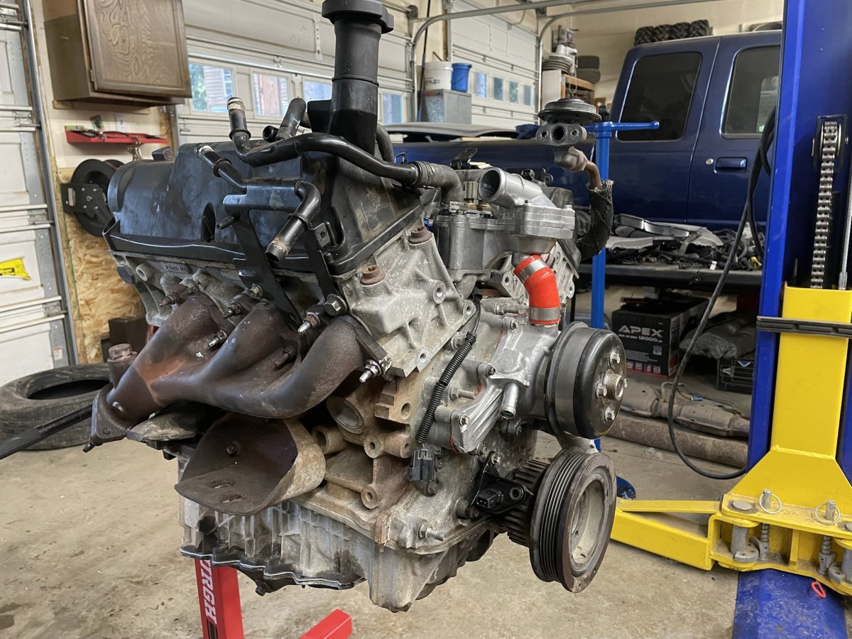

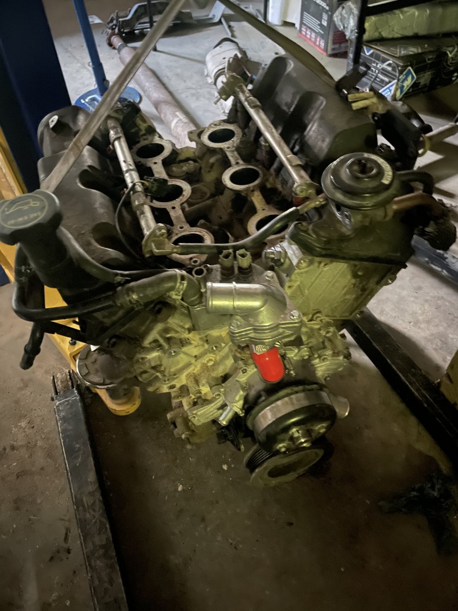

05
Engine ready to be dropped into 02 trac today

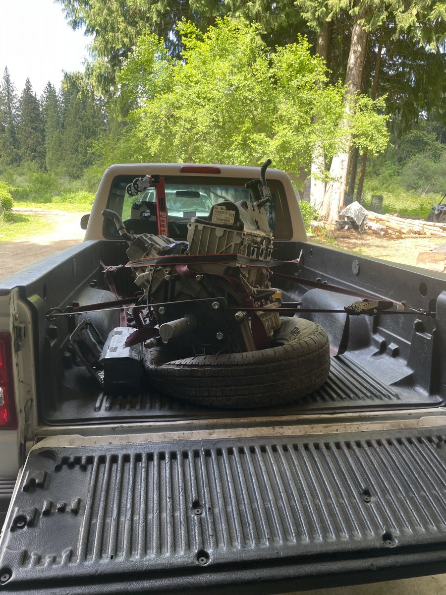

Would that 07 ranger be blue in color that the trans came from?
Yes and kinda! The 06 trans from Eddie money blue ranger is actually in the white ranger I’m driving. The 07 trans I am installing today came from a 07 ranger I got in Montana the old guy rolled it in the snow. A real
Gem with only 119k on it.
I don’t have any more good
Low mile 5r55e after today and I’m down to only one more Good low mile 5.0! I have a few high mile drivetrains/complete
Running trucks. I’m going to have to get Brett to build me a 5r55e or two now also a 4r70w the only one I have left with low
Miles is rwd

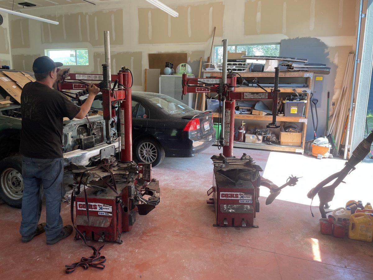

Best part of that whole deal is we scored our own tire machine last week so now I can mount my own tires!! Looking for a balancer now
We bought both machines on Craigslist, sold one paid for both

What is that big weight on the 4x4 for that you removed to gain access to the starter bolts?
I always wondered!
