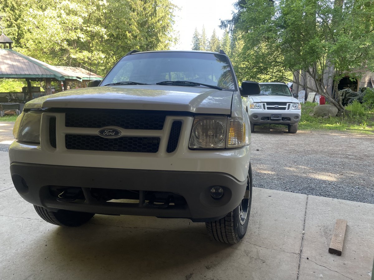

700’03’in the background

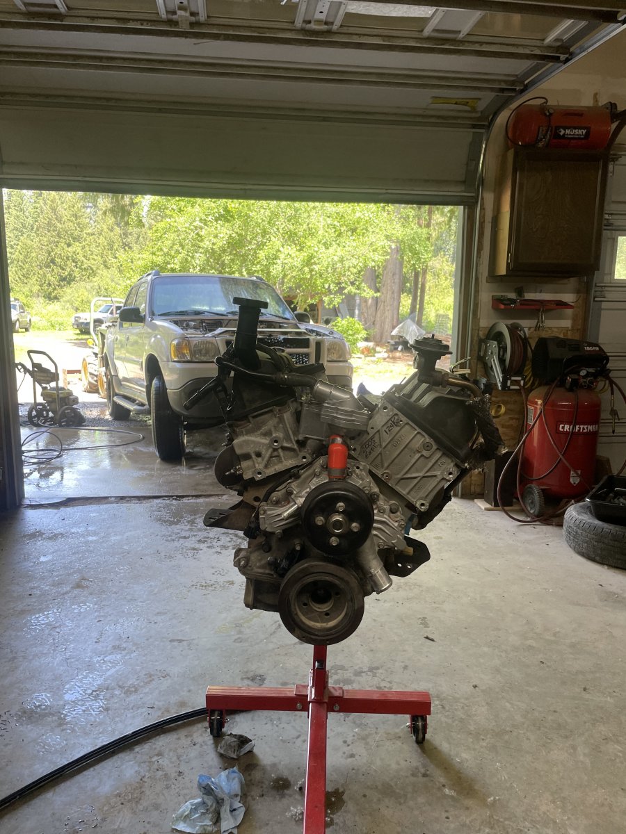

01 up front getting 05 sohc and 07 trans. This rig was gutted a few years ago I was about to put a v8 in it. So I had to work backwards here change the throttle cable and power steering line as well as the drivers side engine mount
Funny how things change now the 700 dollar truck is getting the v8 and the old 01 is going back to v6

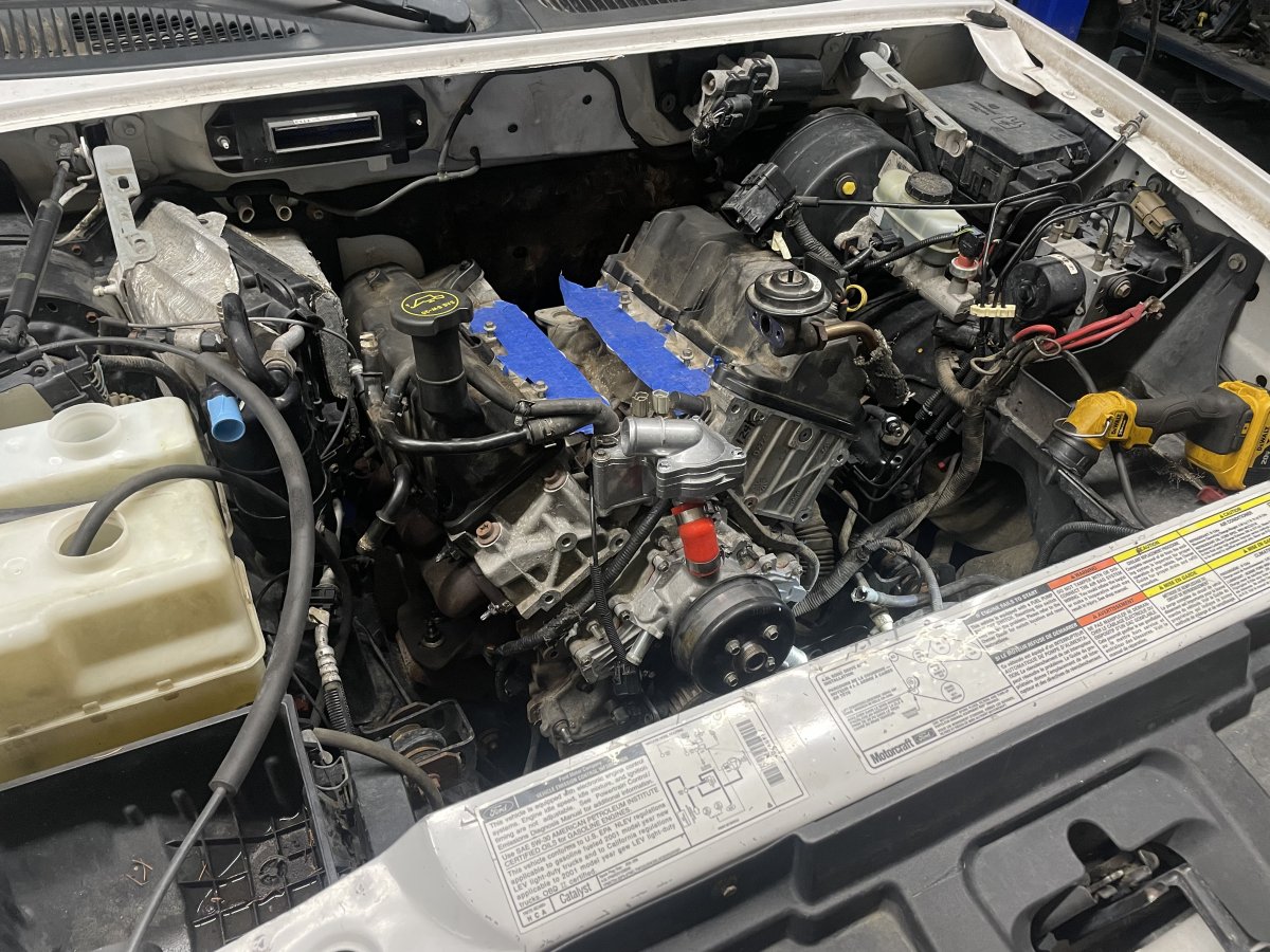

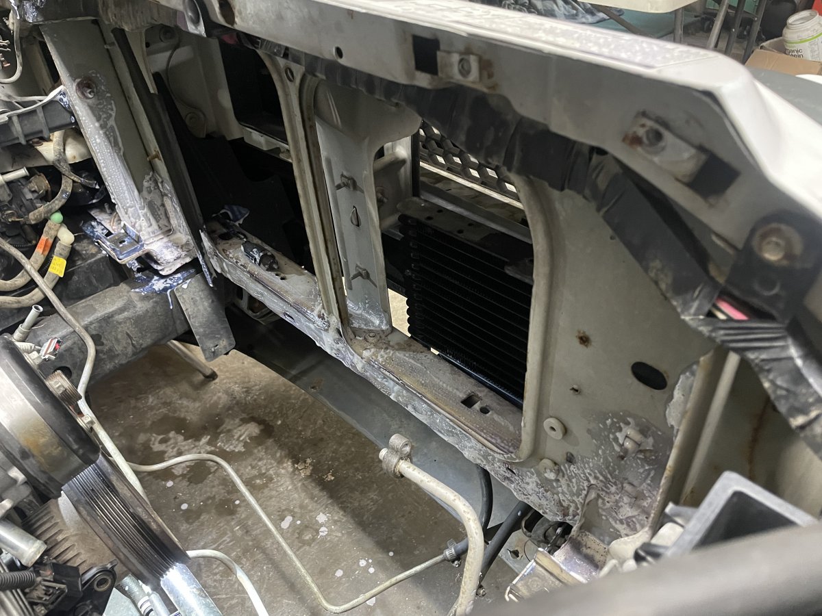

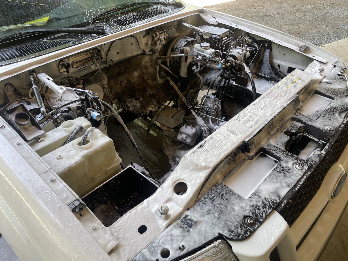

Engine bay washed degreased and some rust treatment on the radiator support before sohc dropped in

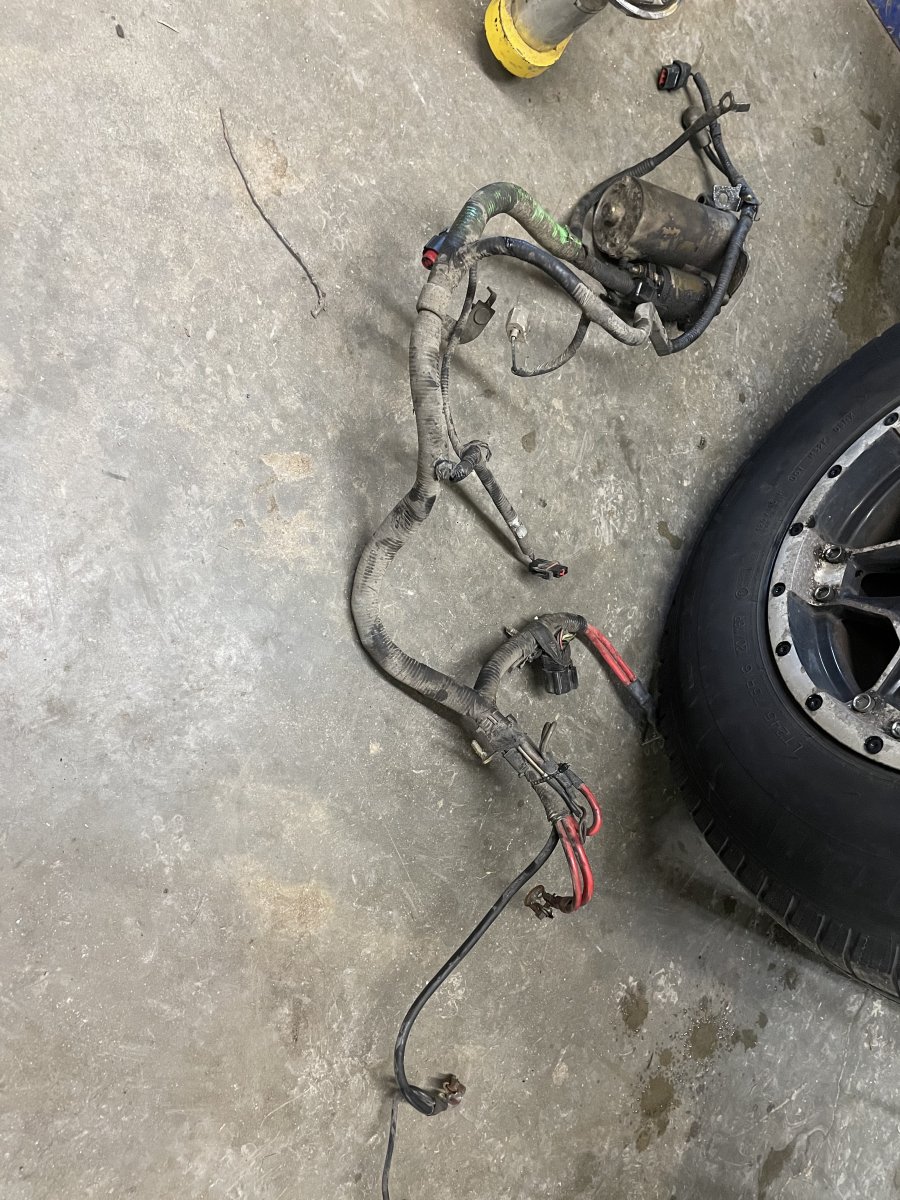

First thing to go on is the starter/alternator harness for the sohc then the engine is dropped onto the mounts
This old hoist has dropped and pulled so many engines

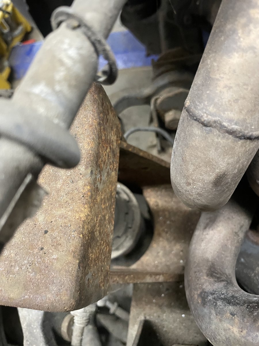

Ford used these round vibration damper weights in different spots on different ranger based trucks
I usually remove them from my rigs with no I’ll wffects
However there was one 2000 ranger ohv we built that was better w the transfer case weight installed back in place solved a driveline clunk

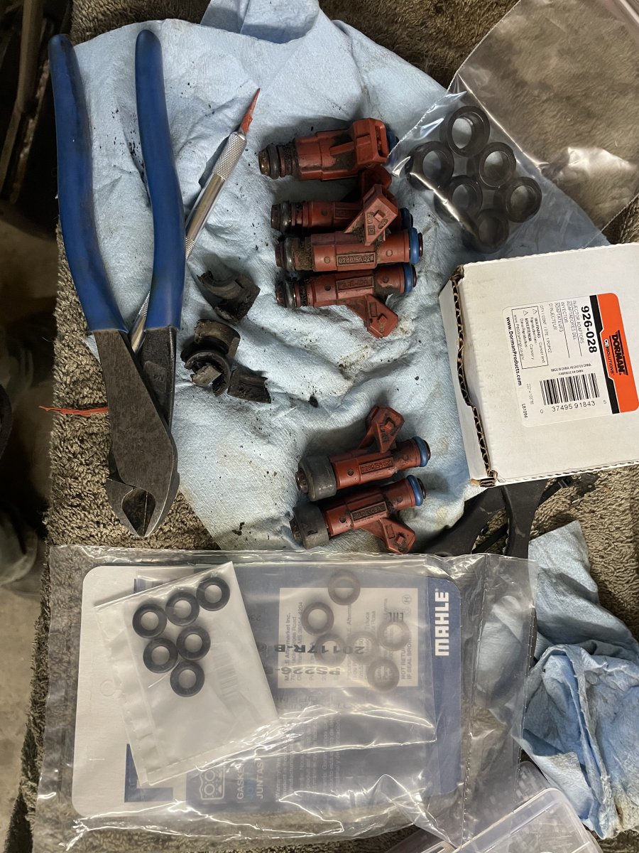

Got the parts for re seal of the injectors and fuel rail, new Dorman injector seats and 12 o rings
Easiest to just cut the old stuff off the injectors. With snips the old seats just crumble and with x axacto makes short work of old o rings

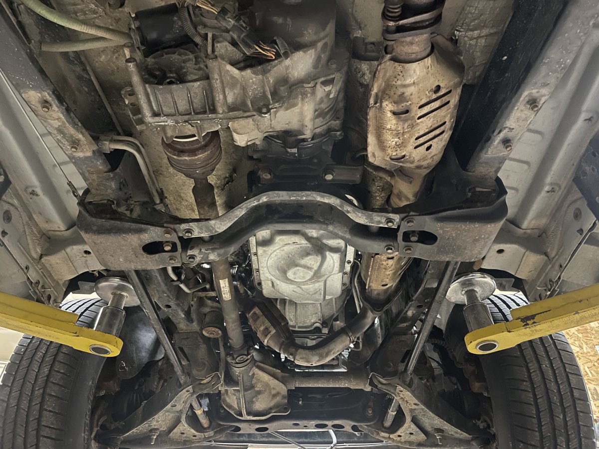

I put most of the engine bay together and then turned my attention to the under carriage

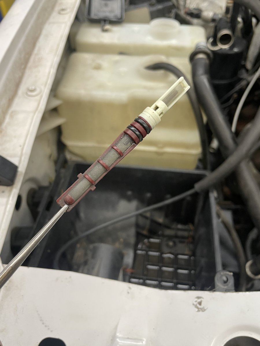

Don’t forget to clean the orifice tube
Trans stabbed, torque converter bolted down, starter in… t case hung
Then finished up exhaust plumbing wiring crossmember drivelines, serviced the trans filter and fuel filter..
Lower mile drivelines were used.

I can't make it out, which side is the starter on? (The white truck?)
4.0 starters on drivers side right above the diff

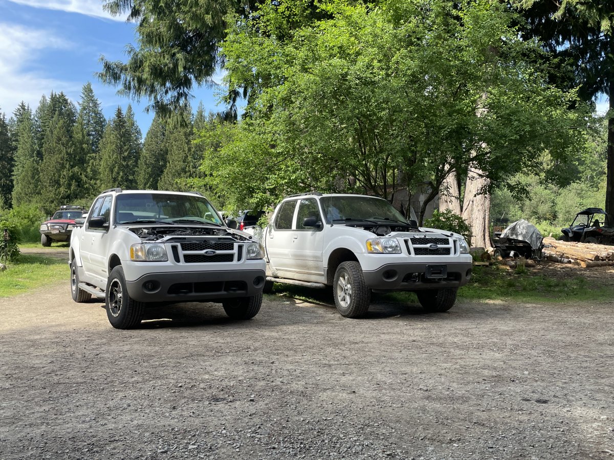

So that project was pushed outside next to the $700 truck for a couple of days

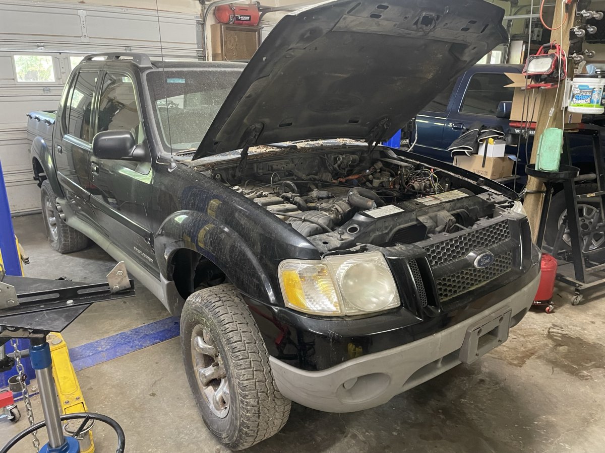

In the meantime I pushed another 01 trac I have into the shop to be completely dismantled this one is a real gem
The parts it’s giving up will go into the 700 truck…. After this I will have to change the trucks name because once it’s a 5.0 5 speed with a 4406m t case it would take a lot of money to buy it away from us….

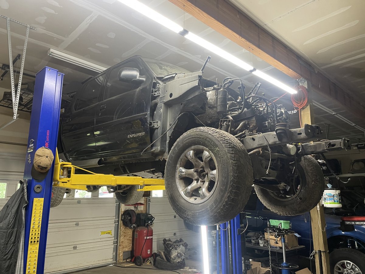

Black trac giving up its parts while I waited for wiring book
I hate to say it but I decided to crush the black one she is just too far gone
Roof caved in from heavy snow, frame repair in back and s title
The parts will live on in my 03 white $700 truck

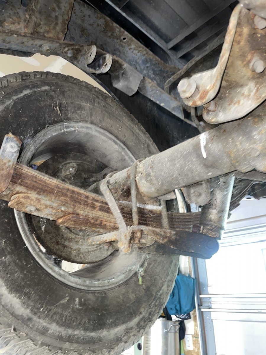

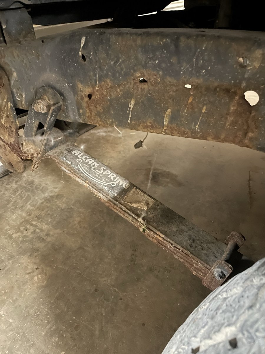

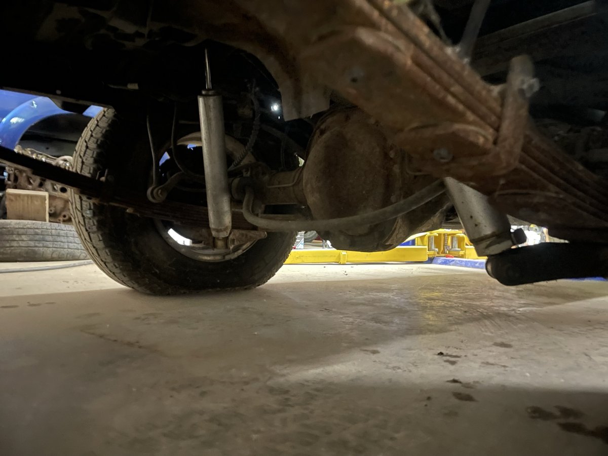

Lots of wicked good parts. Door sticker says 3.73 open and built in 04/2000 it would have been drums from factory… lucky me this one has a 4.1 disc brake rear axle
I marked the tire and the pinion counted rotations. Nice disc brake rear and even nicer rear Alcan leafs

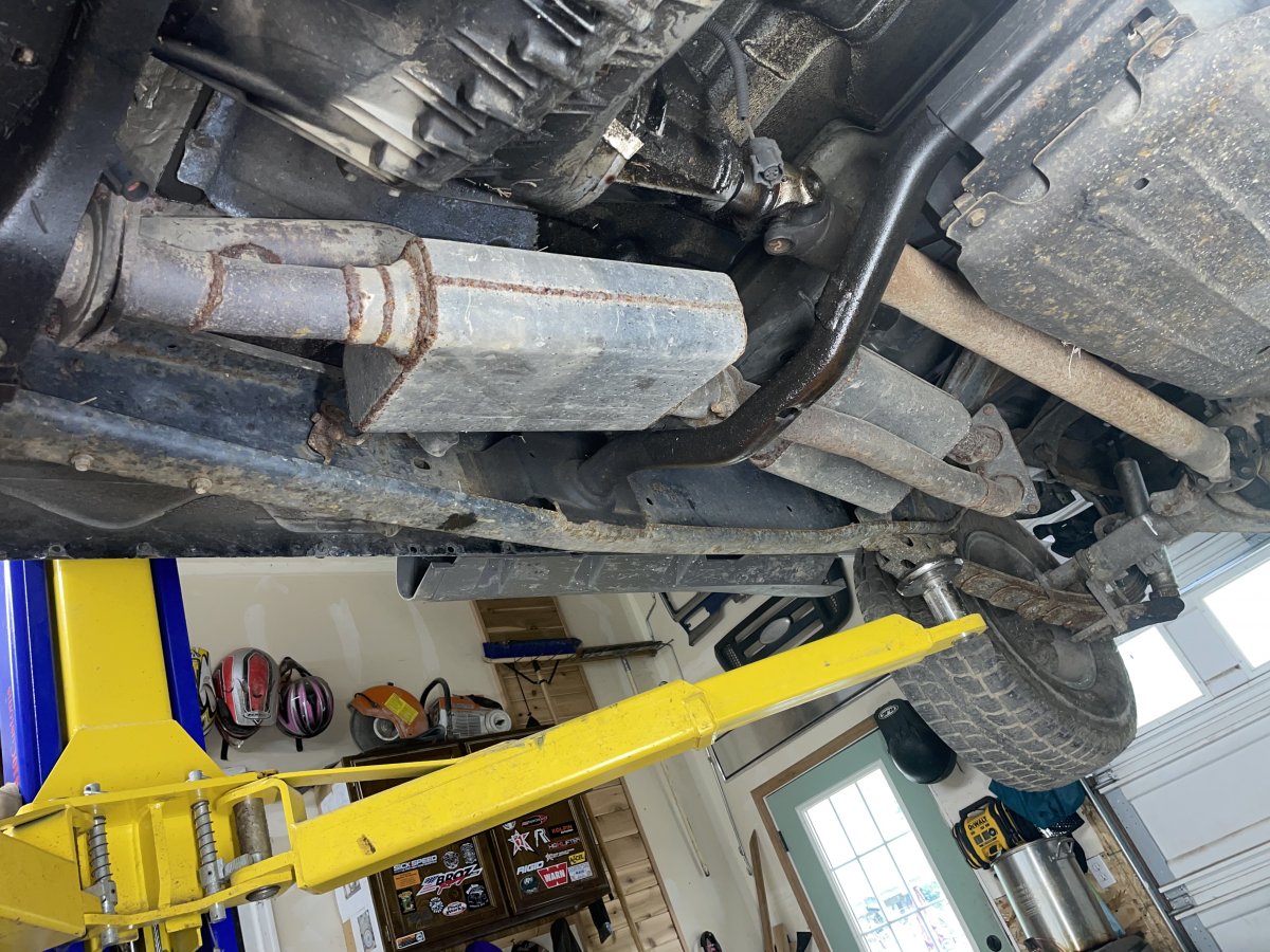

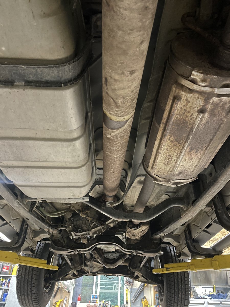

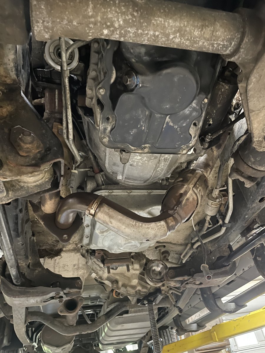

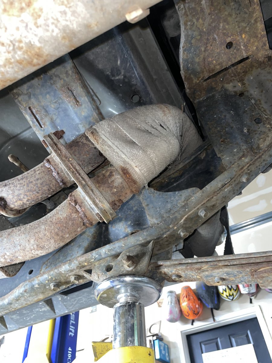

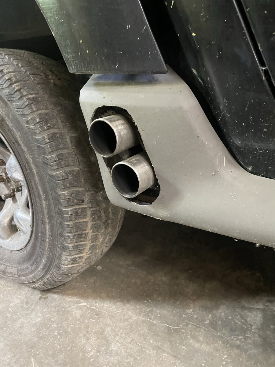

I love this exhaust setup! Wicked cool setup and well done w true duals, shotgun side exit (thanks to 2” body lift) and a crossover pipe
Will go into the 03 this way

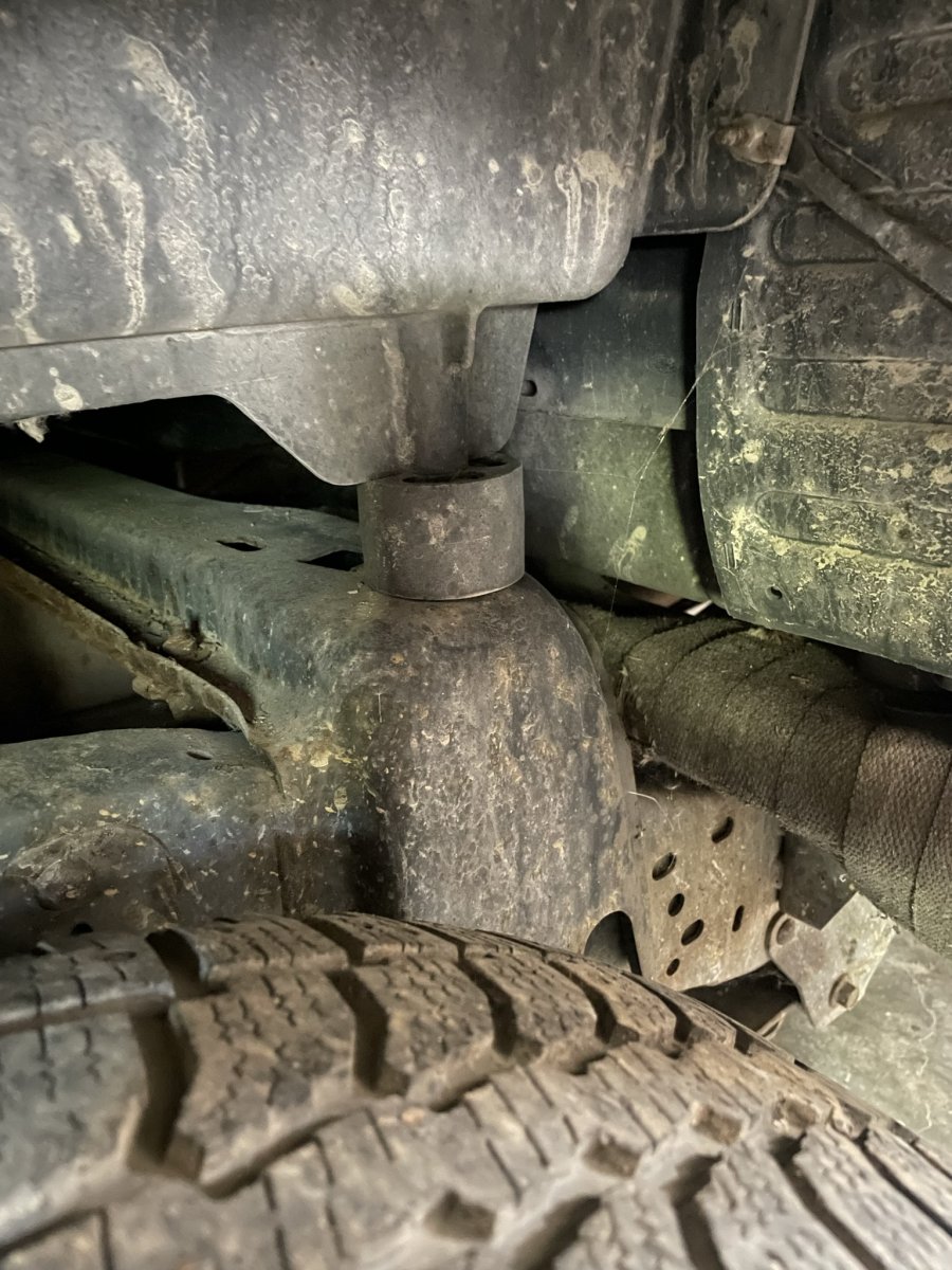

Stock trans x member was modded to fit the 5 speed/ lowered and notched

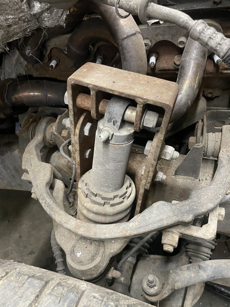

Checkout the cool fox coilovers and adjustable brackets. Frame rails were completely shaved of stock towers
Obx headers!!

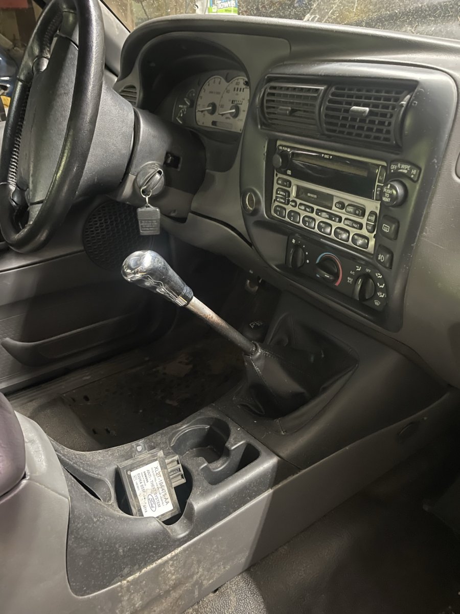

5 speed manual!!

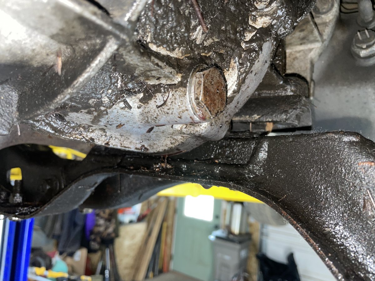

The 4406m was leaking pretty good from the rear slip yoke seal also
Maybe some
Coming from the vss speed sensor hole. Since it has a vss we know this case came from a pre 98 f150.
Two more bolts and the drivetrain/exhaust is out
