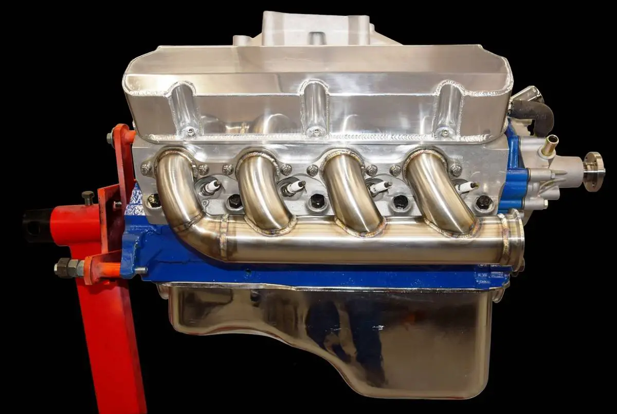

Flip that log over and put a T3 flange in the center.
One in each side!! does that make it a t6? Lol
Oh the heat under the hood!!! would melt my crocs!!!!
@410Fortune In reference to post #170, If you could make a log manifold with that design that would work on GT40 and GT40P heads, either or, and fit 1965 to 1970 Mustangs, then they would the Fox body years, Ford trucks and would they fit Explorers or is there a steering shaft interference problem? Is that header meant for a turbo? That would work on the drivers side then make a passenger side one.
Well I think it was Holley who started making the Blackwood log manifolds, maybe hooker I’m not sure. Once I saw them I was like “that’s the ticket”
I would make them fit a gen ii explorer and then a ttb ranger/explorer
They are already plentiful in the aftermarket for turbo and non turbo applications of sbf
It’s the explorer ifs that has the limited market due to steering shaft, frame rail, heater box clearance issues
Lots of cheaper headers made for rwd 302 swaps into beamed trucks (rwd 84-97 ranger, 91-94 ex and 84-90 bii) But like none for the 4wd trucks although there are some mustang headers that can work with little to no mods
The 2nd gen Explorer has big issues for the headers at both the steering shaft, and the UCA mounts(frame). A proper header has to route the middle pipes on the drivers side, outward to go around the steering shaft. That's why all other headers cannot work, they run those pipes close in to the heads, which is right where that shaft runs. If you make a log manifold that brings the primaries out away from the heads 2-3", then it can claer the steering shaft, but has to still miss the UCA mounts. So there is room to make headers that will fit in the Explorer, but how well they can fit the P heads and normal heads, plus other vehicles, that's a big unknown.
I love those log manifolds, the SS pipes and the V-band flange.
