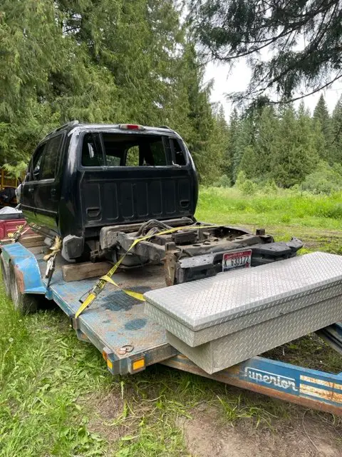

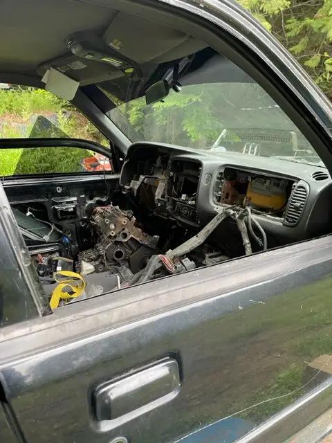

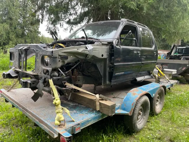

The black trac has been completely stripped, strapped down and ready for the crusher
Sad to say I scratched the crap out of the tint on the driver side front window glass when trying to remove it. I was hoping to install the tinted front glass into our sport trac.....I got the passenger side out just fine......then I had two beers and we had company over for fathers day....whoopsie. Otherwise I got all the parts I need off this thing. Oh and one of the rear Rancho 9000's is blown....dang! I was hoping to use them
I did get the whole body lift though :)

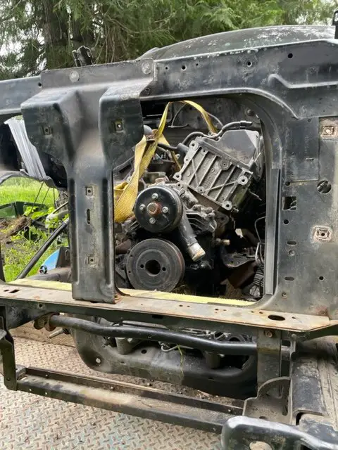

I also was able to put a bad sohc engine back into the black trac frame and a old 3.0 block inside the cab, should help with the crush weight a little
say bye bye to crushy

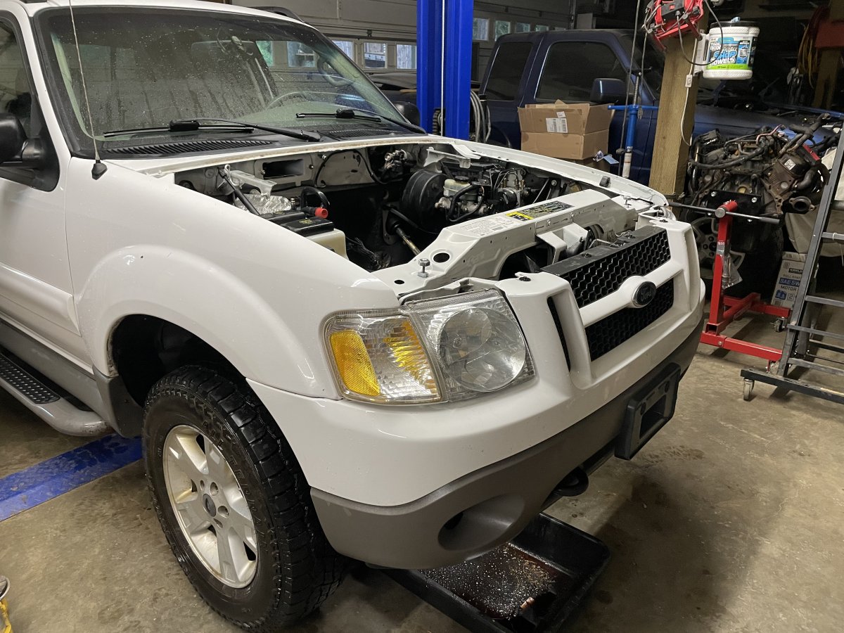

700 truck in the shop getting prepped for 5.0 in the engine bay and ready for body lift

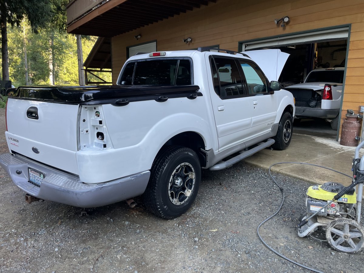

2001 with the 05 sohc / 07 5r55e getting detailed, running great
black truck going crusher

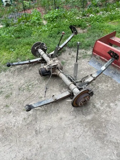

4.10 limited slip disc rear with alcans and rancho 9000
too bad rancho blown

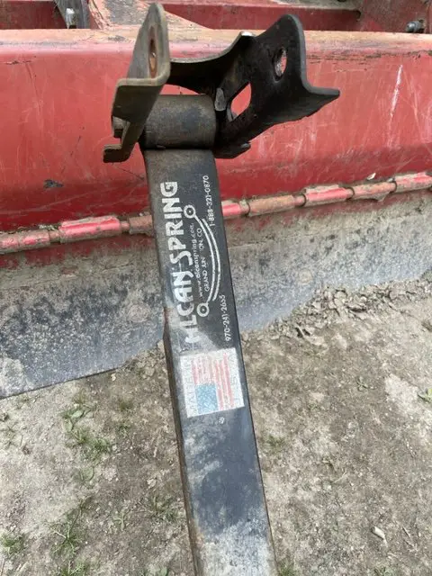

my new leafs for 700 truck
700 truck getting prepped for 306 and 5 speed

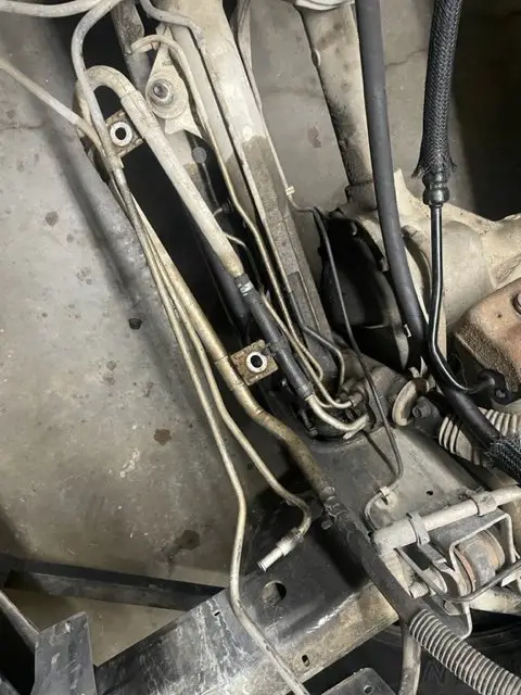

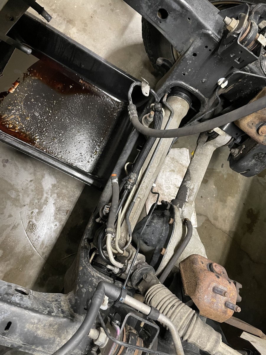

First up change power steering line for 4.6 expedition line (can be bent to fit 5.0 like I did 07 Ranger)
Always snag this piece at JY if your truck doesn't have one
removed v6 trans lines
Added plugs for all open lines, ready for power wash

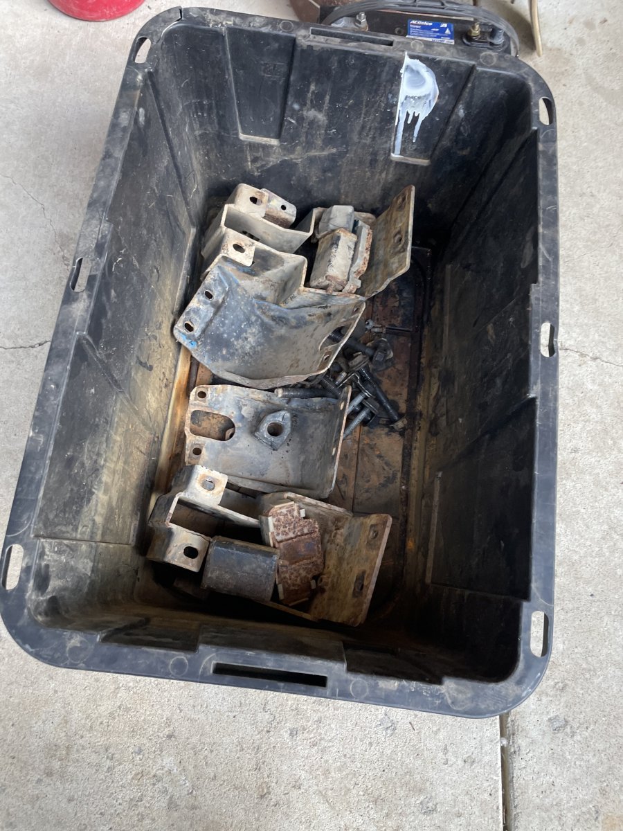

PB blaster all body mount hardware
body mount parts
soak hardware in atf

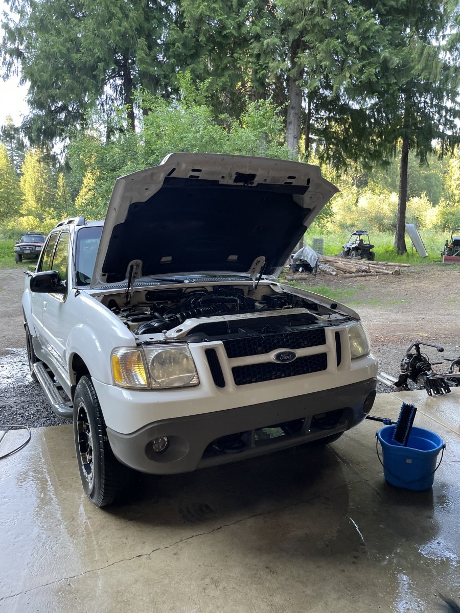

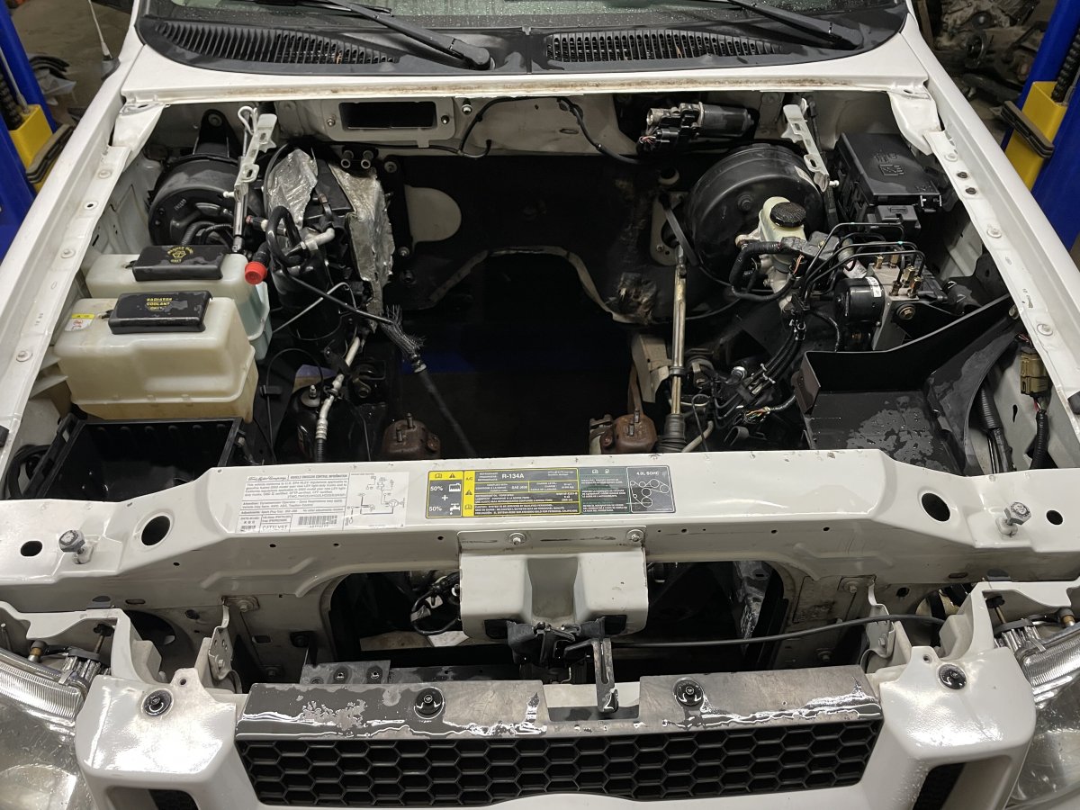

Time to wash and degrease the engine bay
Since the power washer wa out I washed 3 trucks one more blue one to do tomorrow

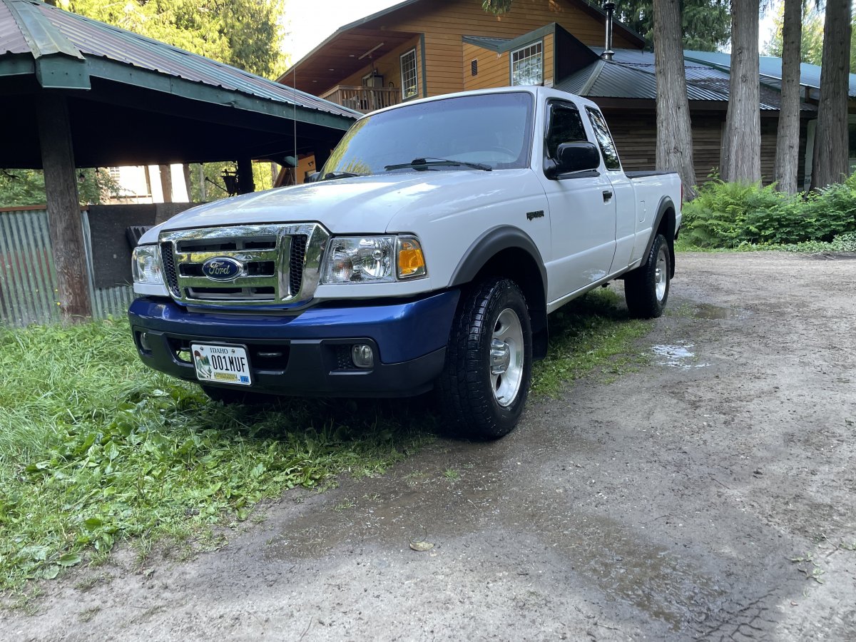

I’ve been driving this beauty around while I build us a sport trac. This is a 2000 ranger 4.0 we built for my buddy, we have since built him a better one so this sucker will be for sale soon
2000 w 06 conversion 4.0 ohv fresh heads 07 trans, coilovers, leather seats, custom custom lots of goodies
Then I washed the 01 with the 05 sohc it’s ready to go to detail and body shop

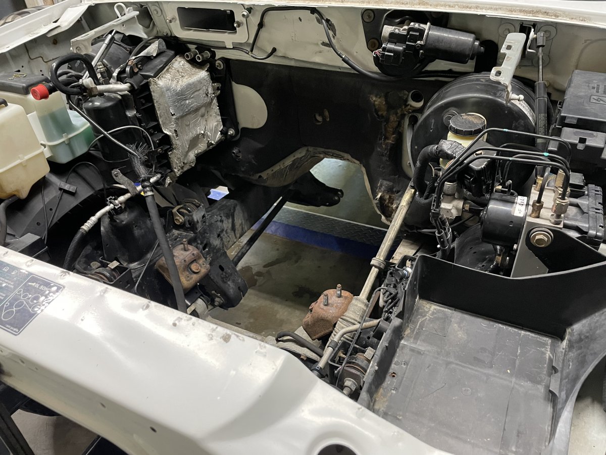

Then finally the $700 truck had its engine bay done all orifices plugged degreased, new 4.6 power steering g high pressure
Line lots of degreaser and then back in the shop

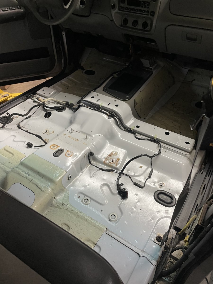

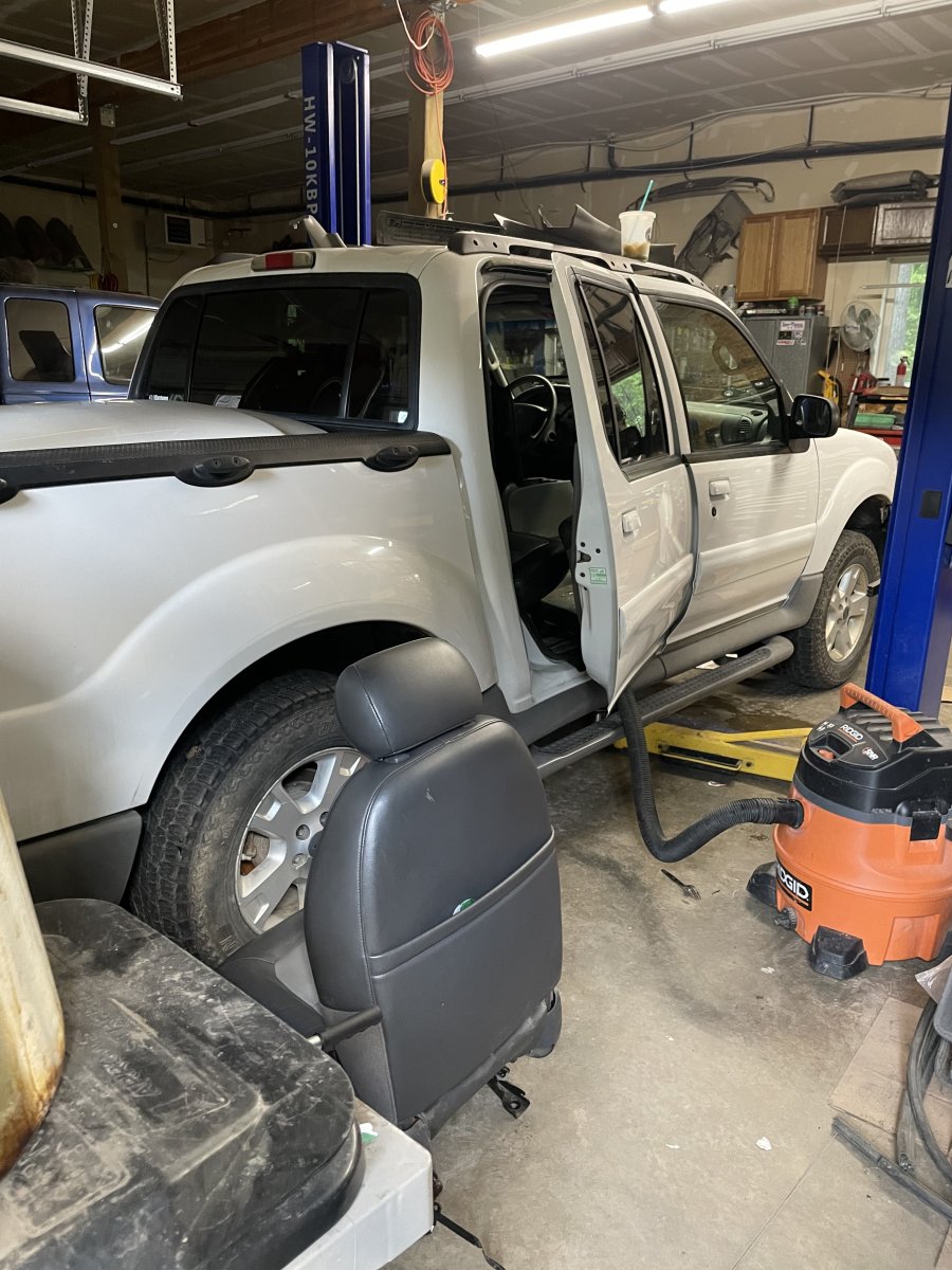

Took interior out of $700 truck makes it easier to swap body mounts body lift install clutch pedal assembly and convert steering column and cluster to manual shift

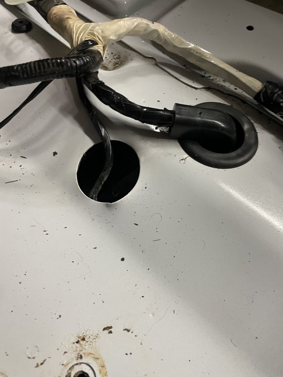

Floor was quite wet underneath, found the big rubber plug for t case wiring not in place!
Dry now
Engine bay final prep, engine mounts will be here tomorrow

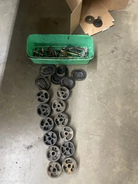

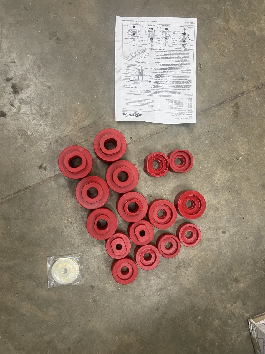

New body mounts are here
I love the parts, all of them, the spares and new stuff.
How familiar are you with the Sport Trac bushings etc, versus the 4dr Explorers? I have a Kevlar Sport Trac mount kit I got as out of box, many years ago, for about $100. How many of the Explorer bushings are different, that I have to buy those unique ones to combine with the Sport Trac parts?
I thought I had also bought an Explorer kit to get those items from, but I think I waited to see if they made a Kevlar kit for the Explorer. So in the next year or so I'll have to work those out, when I get to taking the body off to do the underside body.

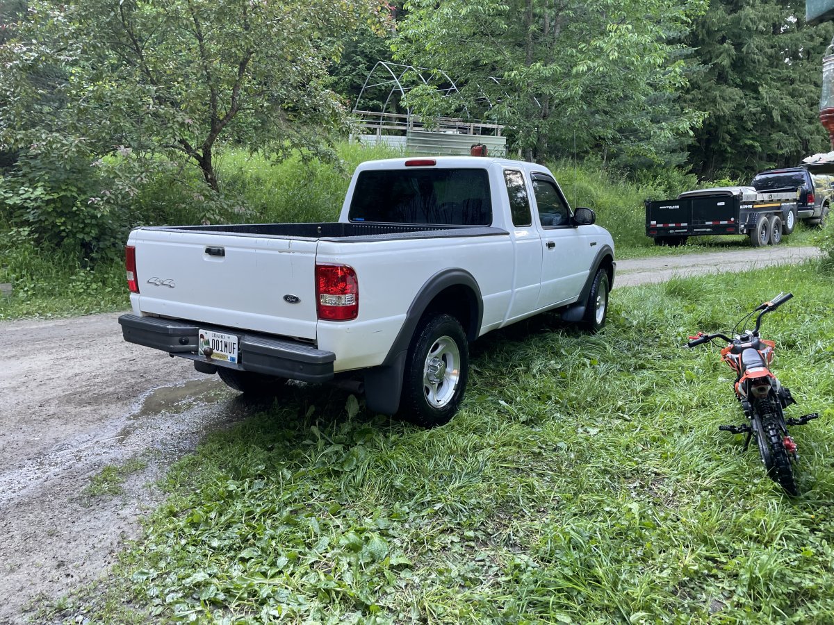

Is that your Dodge pickup with the trailer that the Ranger is on?
