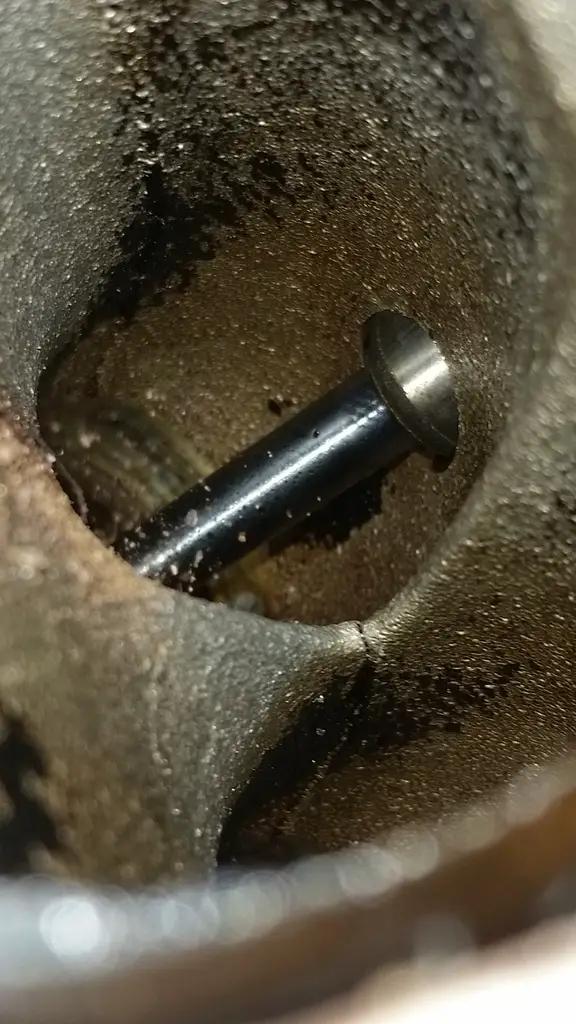

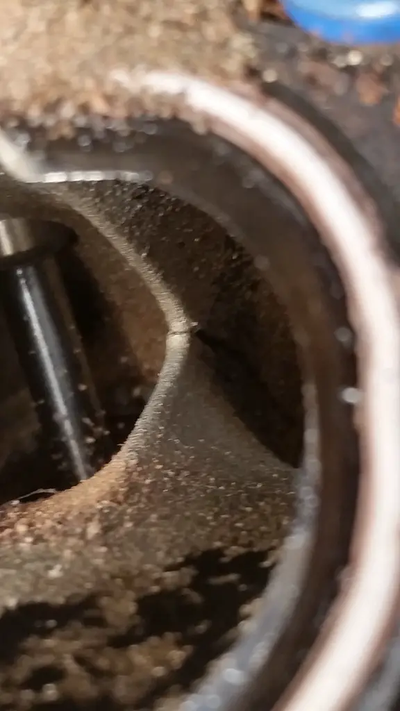

Why do my intake ports look cracked? ?these are passengers side..all of them look close to this,some much worse than others..
Well found a couple other pictures and they have said its casting lines...very bad casting lines at that..think i may take the time and clean these heads up some. .get ride of all the casting lines,then do some slight porting and polish ..may do the intake and tb as well..

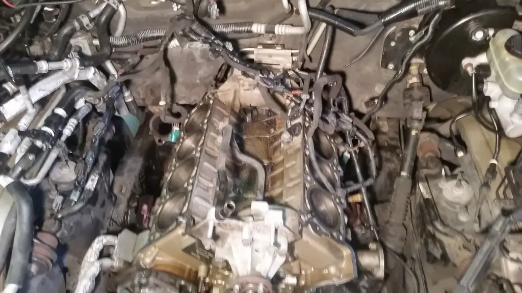

Got the motor down to the heads today in 2 hours..hardest part was getting the radiator out..i took about 12 screws out and the thing still came out with the shroud and sides attached..i did break the lower shroud on the water pump shaft..also broke a sensor on the crossover tube..so far everything on this motor has been easy to work on (knock on wood)
Lets pray i can get to all the exhaust manifold bolts tomorrow and that the heads come off without issues! !!

On most Ford modular motors you pull and install the head with the exhaust manifold attached. In most applications you can't even sneak the manifold in with the exhaust studs on or off its so tight.

Well got the heads off today,so it definitely can be done with the motor in car..
