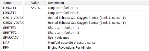

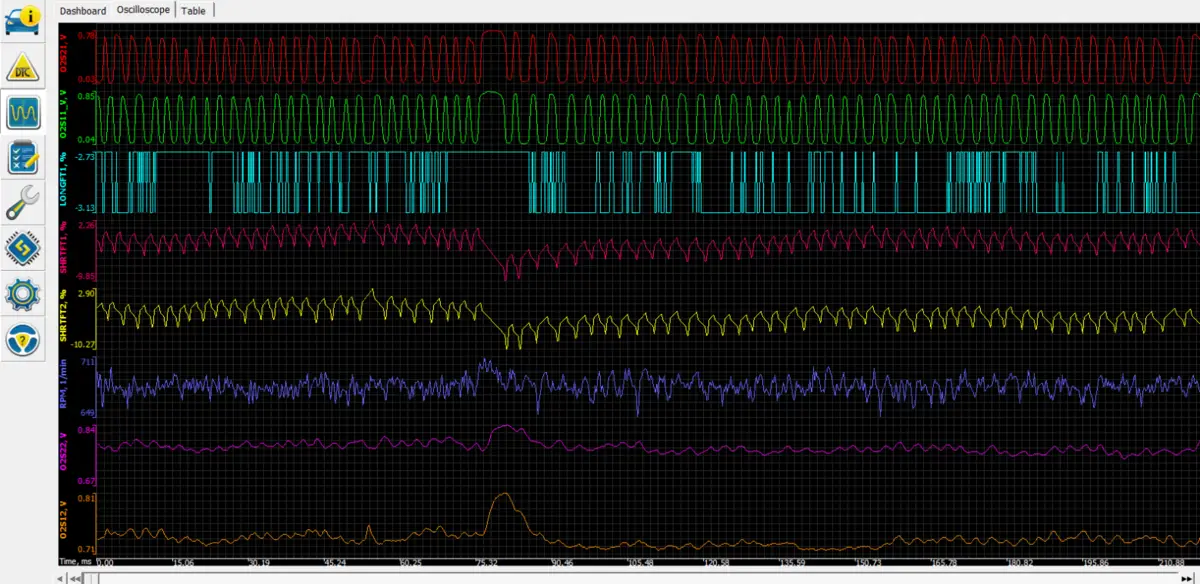

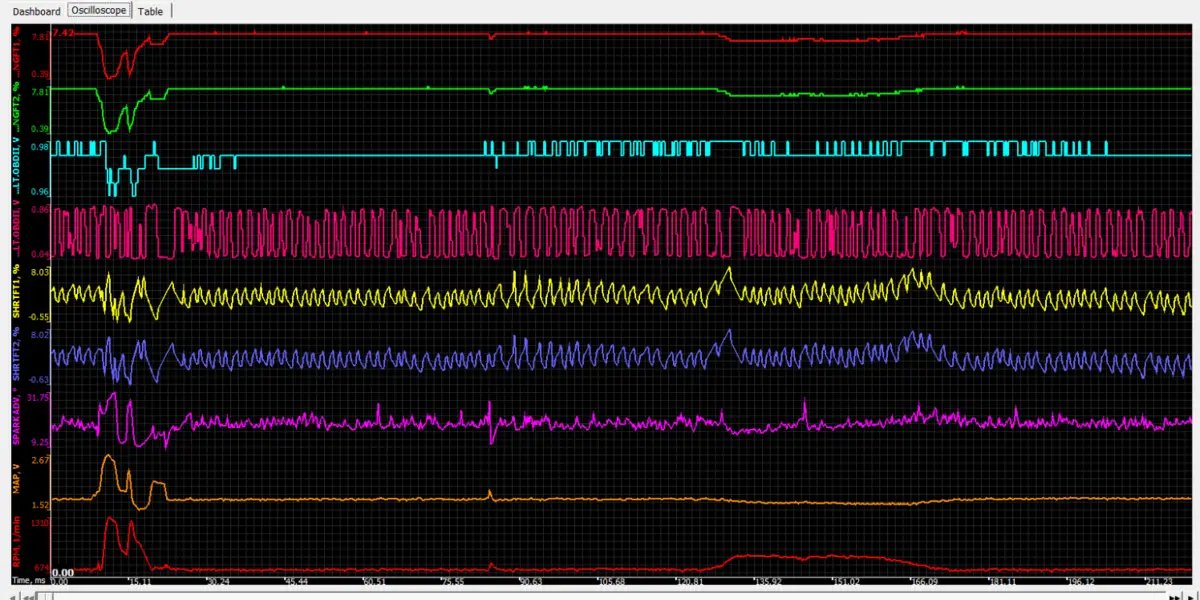

I hooked it up to my reader... looked at the Ignition timing and it was all over the place until I gave it some fuel. On the right side of this picture, you can see where I took the idle to 1500 RPMs.
I also took a shot of the Fuel Trims... I'm not too experienced with them, but I try to learn when I need to learn.
