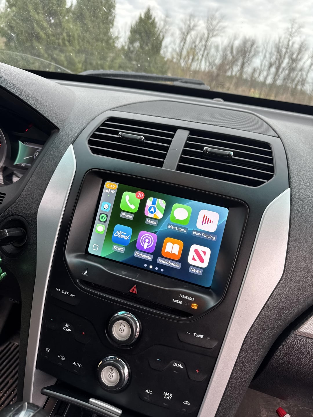

Just ordered a sync3 kit, will let you all know how it goes! I got it from eBay (probably China) for much cheaper than domestic retailers are offering.
Update: The install was flawless, no issues so far. I used a combination of this guide and some Youtube videos to get a feel for what to do. I would rate the difficulty as beginner. The hardest part was probably getting the plastic trim off and getting the old USB hub to pop out of place. I used an allen key to get a better angle for that part. I also popped the center speaker out to place the new GPS antenna in the little (secret) cubby directly forward of it, that was the most correct-feeling and secure place to put it imo.

Also while I'm thinking about it, I noticed on your pic of the bezel once it's off, the silver trim pieces weren't there. Are they black plastic on the back (black plastic all the way through with just silver paint/coating on top) like the silver colored plastic around the cup holders?
The silver on my cupholder piece is coming off to show the black plastic underneath and at some point, I might just remove all the silver and try a vinyl dye paint to paint them black, and if I had the bezel silver pieces off, I might as well do them too.
They are silver on both sides
