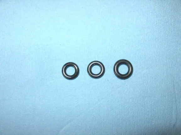

After noticing the swelling of the o rings when immersed in 100% acetone for 1 week, I decided to see how they would look after 1 hour in 100% acetone. I also immersed an o ring in 100% gasoline ( Amoco 89 ) for 1 hour.
The picture below shows ( from left to right ): 100% gas immersed, new, 100% acetone immersed.
The swelling after 1 hour appears to be the same as the 1 week sample. The 1 hour gas soak appears to be swollen, though not nearly as much as the acetone.
The elasticity of the o rings appears to be the same whether acetone swollen, immersed in gas, or brand new.
Next I shall immerse the o rings in the usage mix ( 2 oz acetone/10 gal gas ) and take a look at 1 hour and then leave for a week.

Al where did you get the O-rings you tested?
Is it just me or is there a color difference? (and is that normal with O-rings?) Keep checking those "marinaded" rings to see if the acetone soaked ones dry out faster or if there''s any other effect on them after time.

Yes there is a color difference. In chemistry we would use something known as the pickling process. What happend is the acid is reacting with the oxides in the O-Rings and they got darker. I wouldn't suggest putting anything zinc or aluminum plated into acetone either. :eek:

I just went and looked at the o ring that was so swollen from the acetone bath ( its a little over 10 hours after removing from the acetone ) and it has returned to virtually the same size as a new one.
