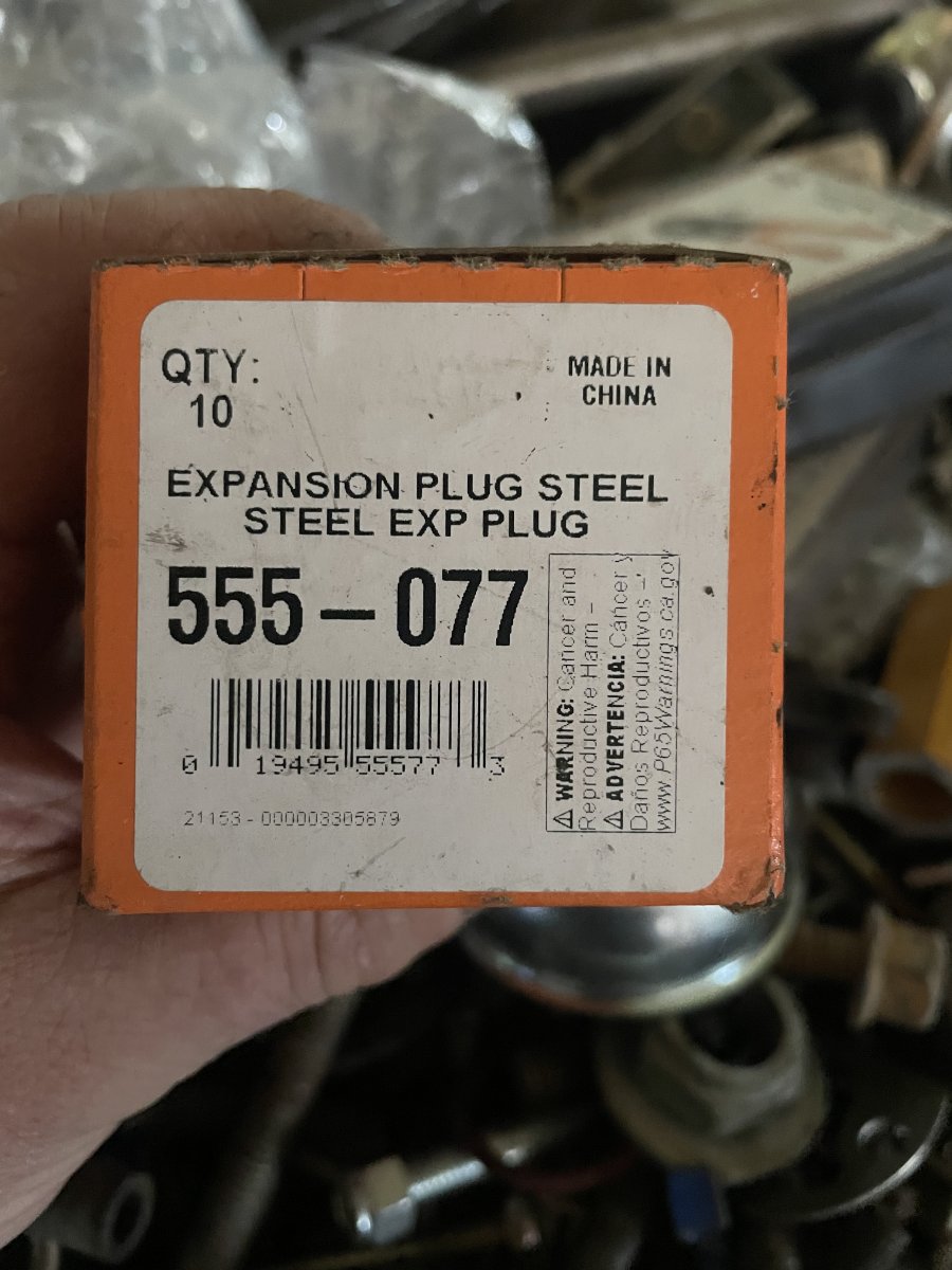

also if one freeze plug is leaking then consider changing them all on that side, then repeat on other side.
The others are likely not far behind
I use some scotch brite to clean the block then alcohol to wipe free of oil and then add an anaerobic sealant (never hardens) like flange sealant from
Loctite around the edges, finally careful press them in with a socket or the old plug
